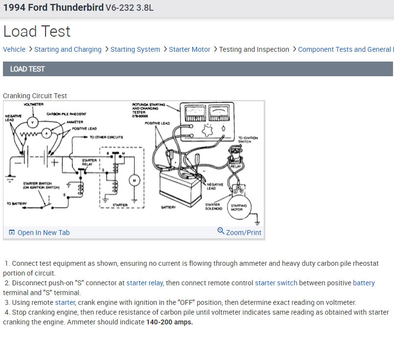

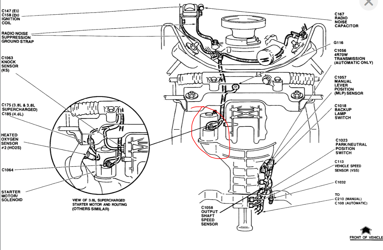

It sounds like you might have gotten water into the starter and it caused it to short out.
If the water gets sprayed directly to the starter it can make it go bad. It all depends on amount of water that might have gotten in.
You should take the starter off and get it tested. Most auto parts stores have the ability to bench test starters.
https://www.2carpros.com/articles/how-a-starter-and-solenoid-works
You also want to check the starter relay. Located in the fuse box under the hood.
I have attached the starter diagram for your reference.

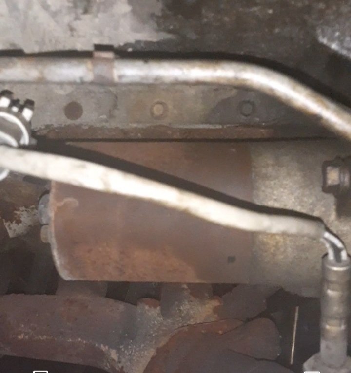

Alright will do. The starter and solenoid assembly definitely looks like it got hit by water, so I'll take it off and take it to a store when I have the time to so so. I'll up date once it's either fixed or replaced. Thank you.

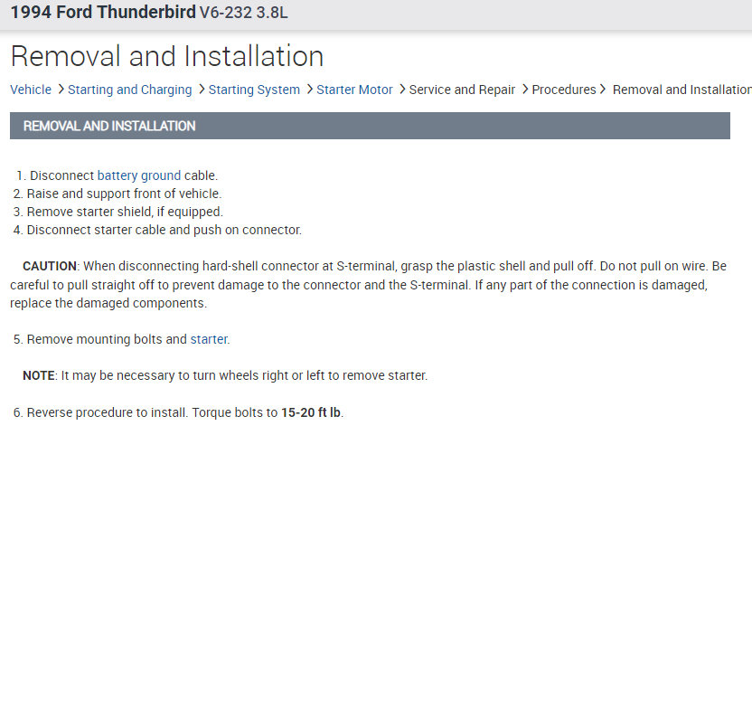

Bought a new starter assembly. The car is parked too far away from an outlet and the instructions say to crimp and use a heat gun on one of the cables connected to the solenoid for the heat shrink. Should a bic lighter do the job or could it hurt the heat shrink?
Aug 5, 2021 at 9:19 AM
SQM
  • 6,383 POSTS
Lighter will work. Just move the lighter back and forth and don't hold it in one spot, that way it won't burn the wire or the heat shrink.
