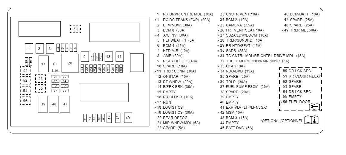

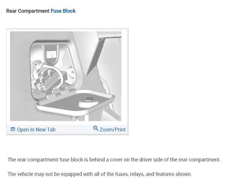

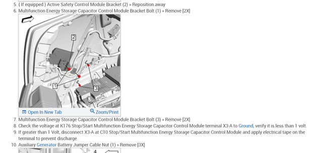

It sounds like the start stop control capacitor is bad, but we should check the fuses first, here is a guide to help you and fuse locations # 5 BCM and the MSM above the left rear fender well. You might eb able to reset the system, here is how:
Reset Criteria
The stop/start capacitor control module calculates the state of health of the stop/start capacitor and sends it to the ECM. If a bad state of health is determined, the charging and discharging of the stop/start capacitor is disabled. If the stop/start capacitor or stop/start capacitor control module is replaced, the reset procedure will need to be completed.
Reset Procedure
Note: Ensure the following conditions are met before performing the reset procedure, or the reset procedure may fail.
No DTCs are present
Battery voltage is above 11 V.
No battery charger is installed while performing the reset procedure
Note: You can only perform 1 reset per ignition cycle. If you need to perform the reset procedure again, you must shut off the vehicle and wait 3 minutes.
Ignition ON, engine OFF
Command the Stop/Start Capacitor Control State Of Health Reset with a scan tool.
Wait 2 minutes for the state of health reset procedure to complete.
If these are okay let's do a CAN scan which is easy to do, you can get a CAN scanner from Amazon for about $30.00 here is a video to show you how.
https://youtu.be/u-4syLc-ifQ
here is a scanner link
https://amzn.to/3o41KcZ

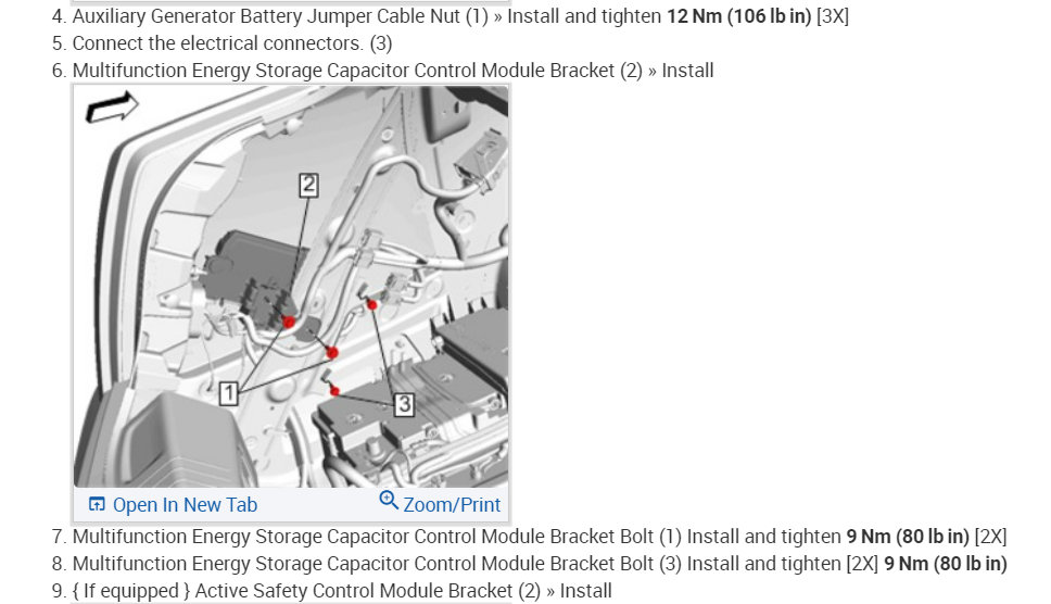

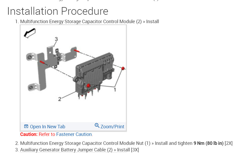

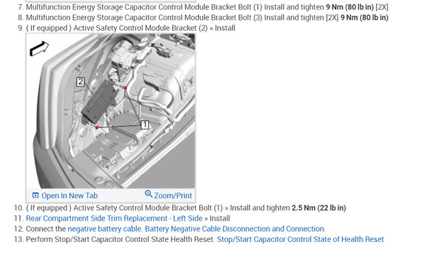

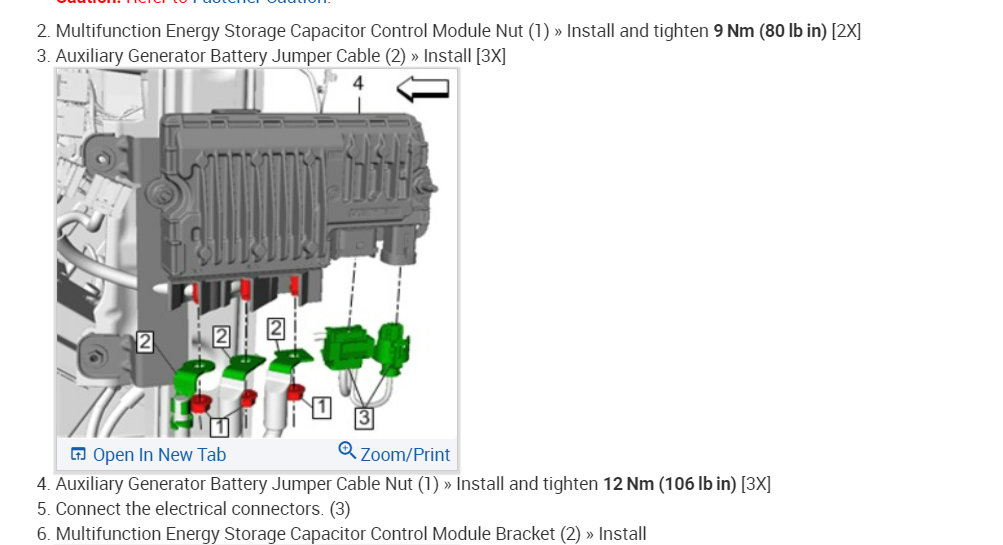

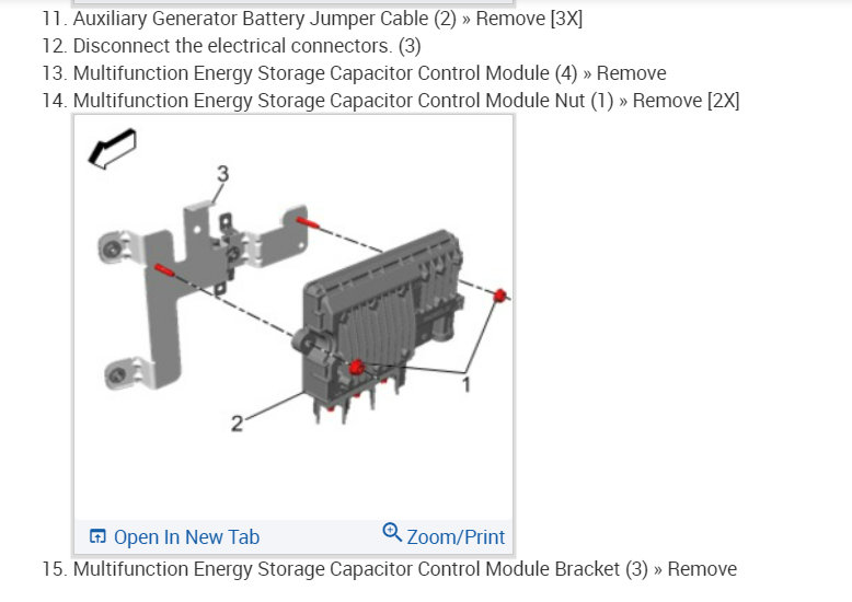

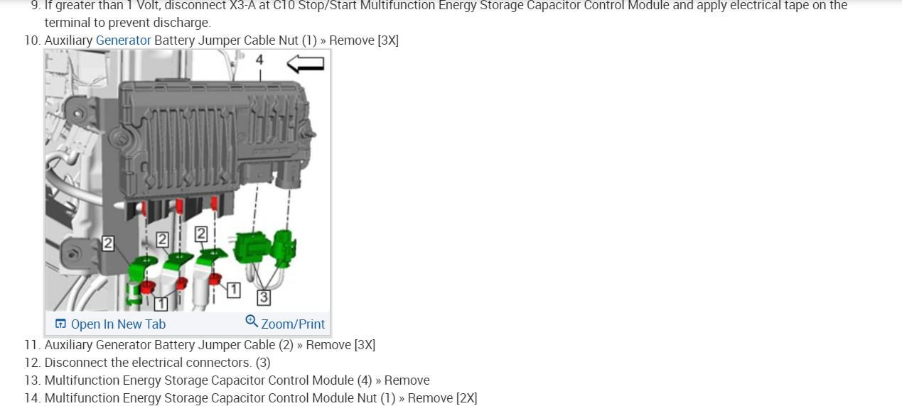

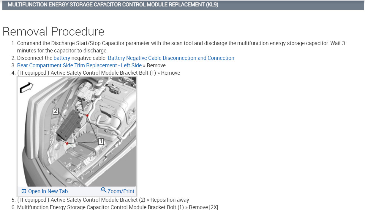

Here is the location of the start/stop capacitor module and fuse locations in the diagrams below. Check out the diagrams (below). Please let us know what you find. We are interested to see what it is.

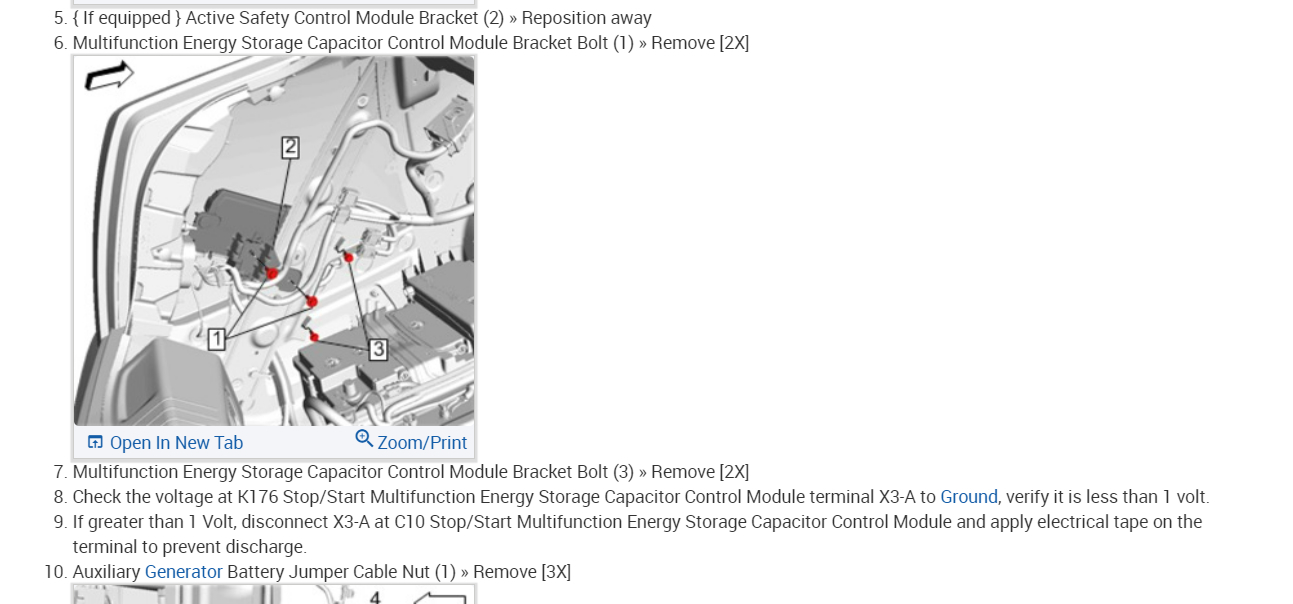

Here is my current status: I commanded the Start / Stop Cap to discharge, and it did not. It was at +2v when I read the voltage on the scanner and it did not change. I tried the Reset function anyway and it established communication and then displayed the reset status. I started the car, and it still would not turn off. I removed the battery cable and pulled the unit so I could make a measurement with a multimeter. Sure, enough it read +2v on the meter as well. I used a set of jumper cables to drain the voltage off by jumping the hot on the unit to chassis and for about 1 minute. I took a reading and it read 0v. I connected everything back and connected the scanner. I now commanded the unit to discharge, and it was already on 0v. I commanded the Reset and it again established communication and then displayed the reset status. I started the car and let it run for a bit at which time I turned it off and the engine still kept running. I then used the scanner to display the voltage on the start/ stop cap and it still read 0v. The same as it had when I discharged it even though the car had been running for several minutes. So, does that mean the module is bad?
Aug 8, 2022 at 12:16 AM
  • 55,797 POSTS
It sure sounds like it because it is not responding to the commands.

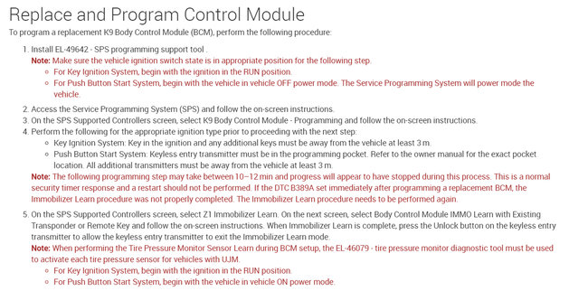

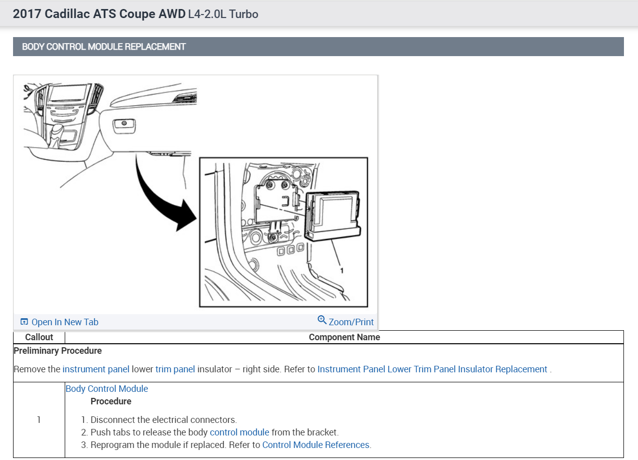

Hello Ken L, I changed the module and reset the health, but I still have the same problem. The car still will not turn off. I removed the Cue, it runs, I removed the switch, it runs, I removed the battery cable it runs. I am thoroughly at a loss!
Aug 13, 2022 at 8:51 AM
  • 55,797 POSTS

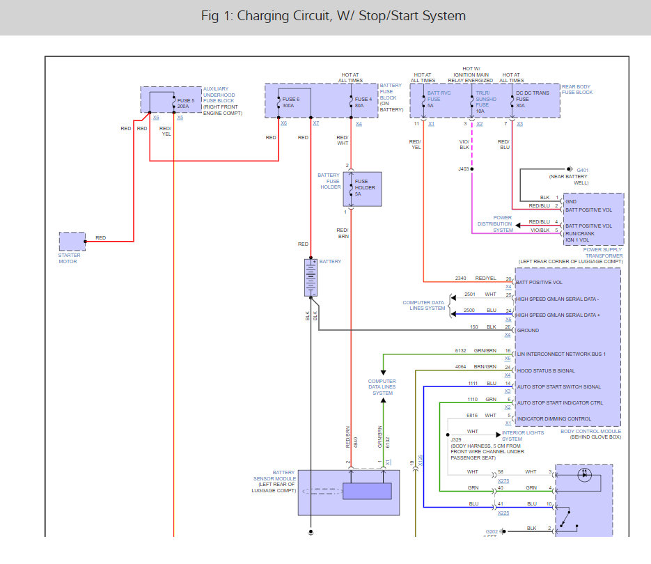

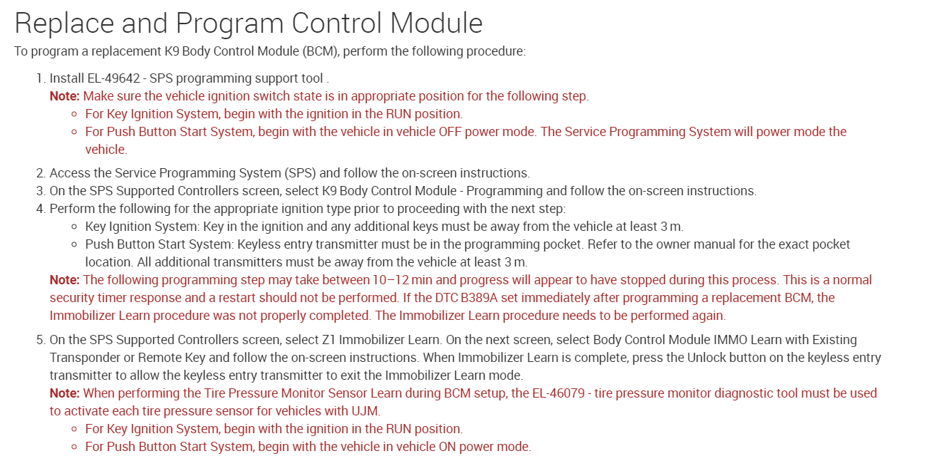

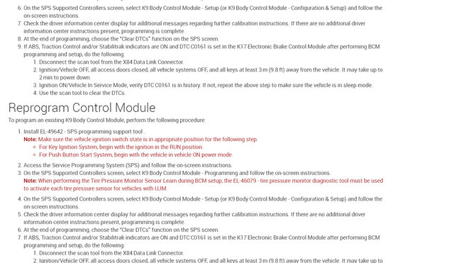

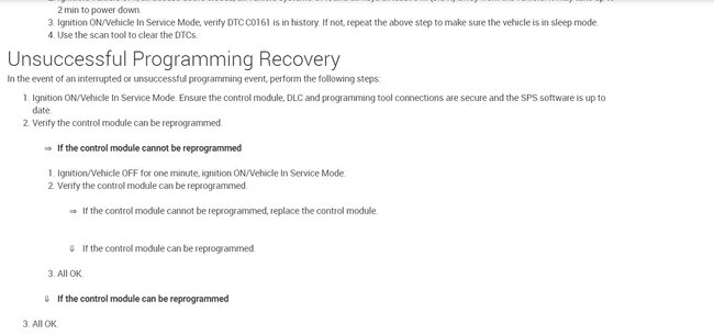

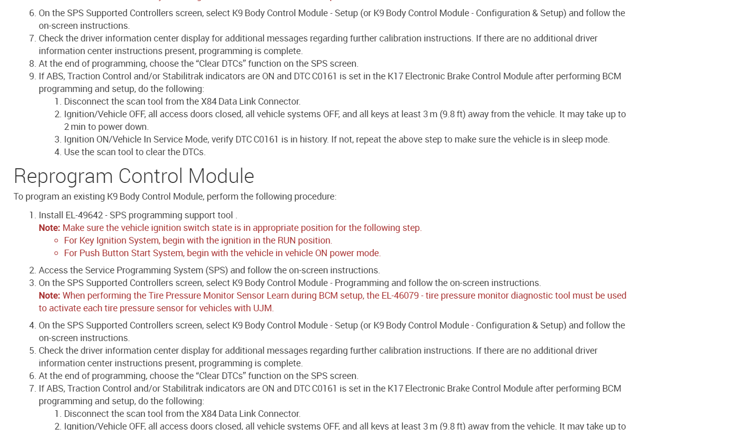

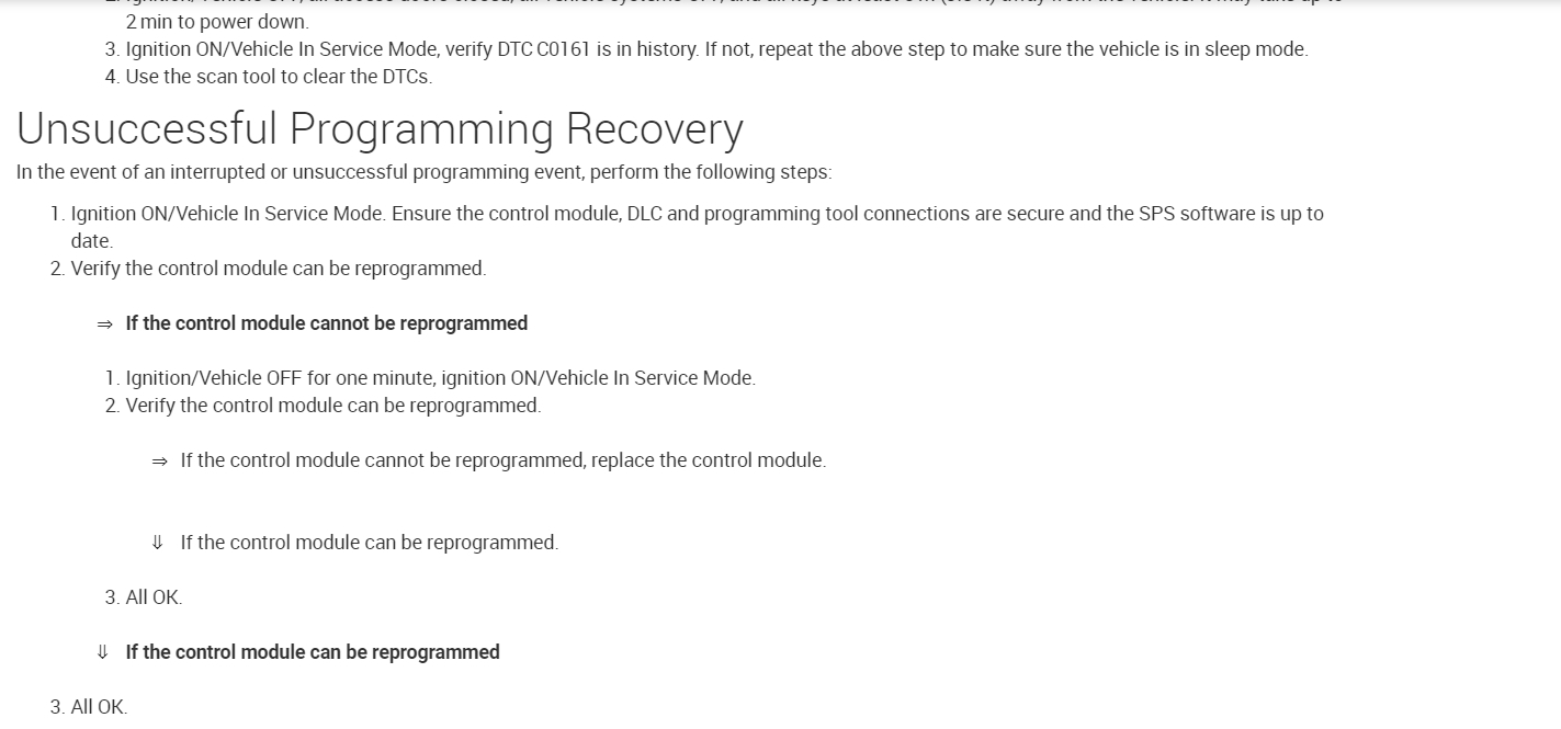

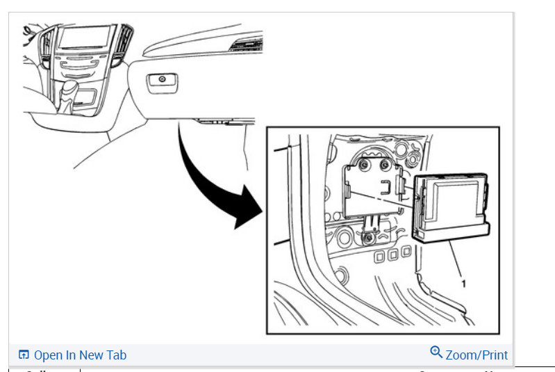

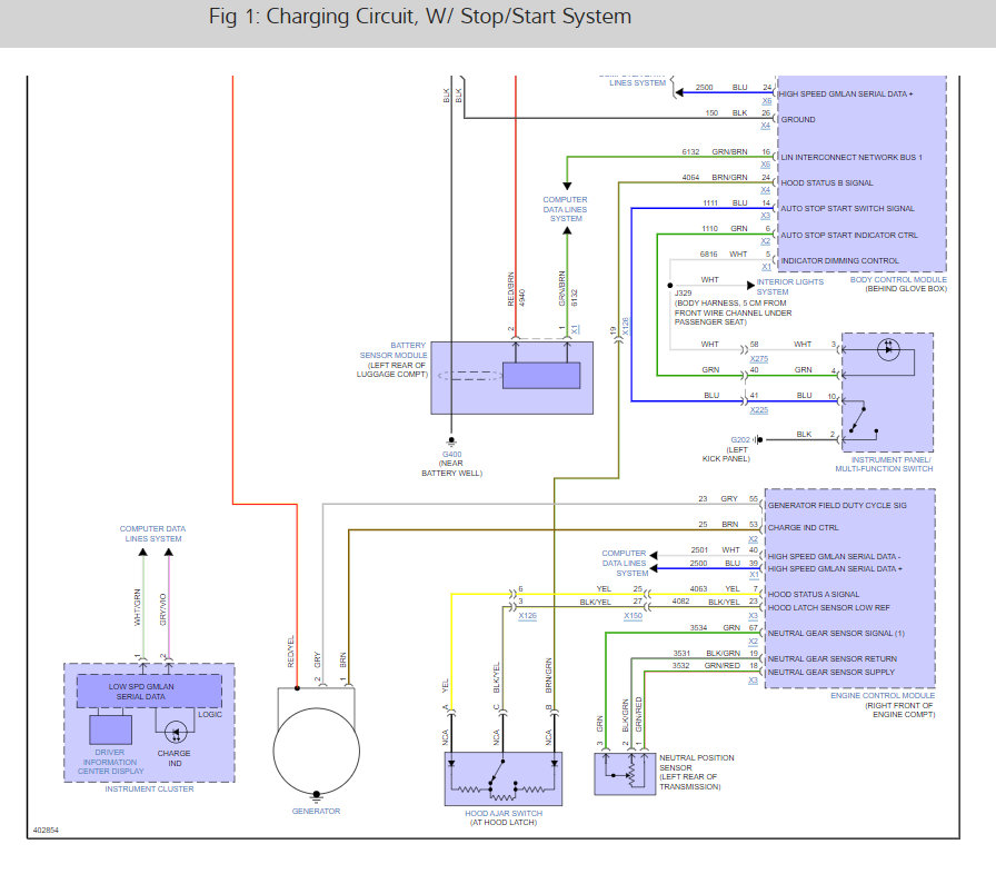

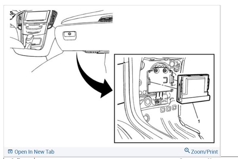

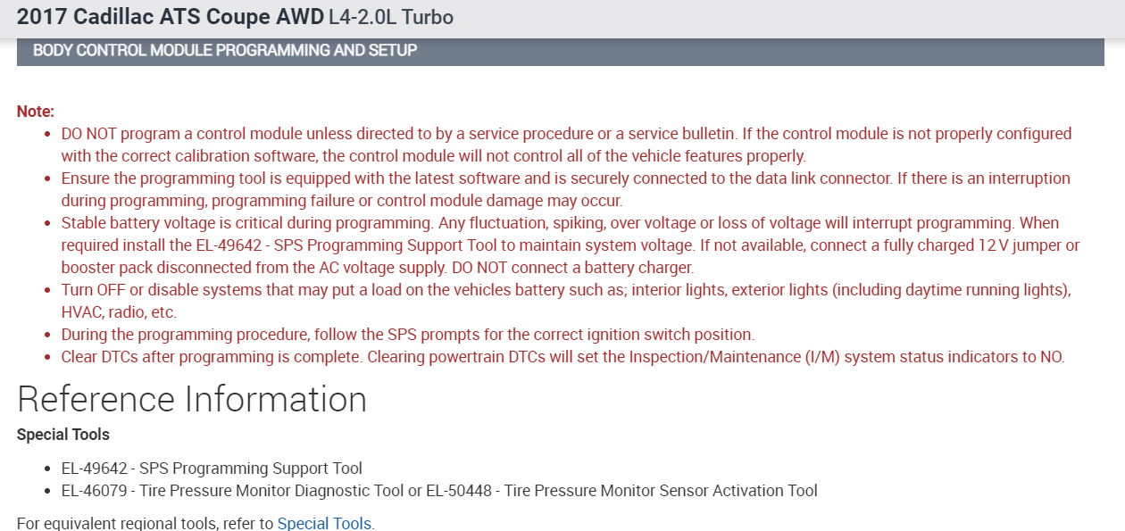

II am sorry to hear that, did you ever do the CAN scan because the only other thing I can see that would cause the problem is a bad BCM. Here is the wiring diagrams so you can see how the system works. I have also included how to change out the BCM, I assmumded you check all of the fuses with the key on correct?
