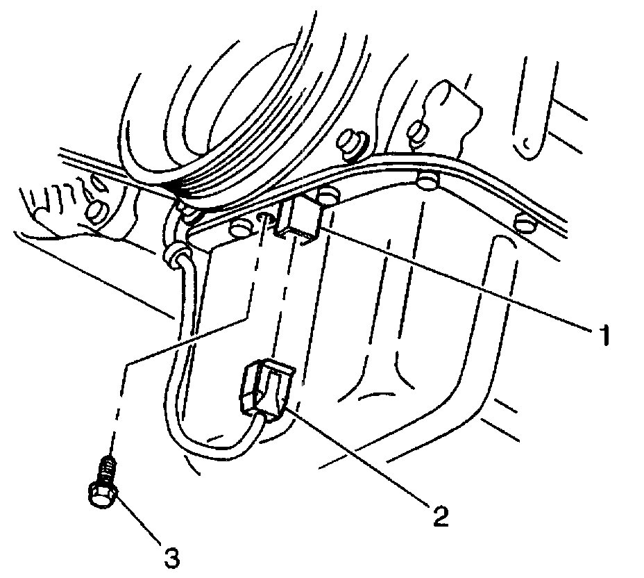

Here are the directions for replacement specific to your vehicle. I attached a picture so you can see where it is located. Honestly, get the sensor and replace it yourself. I realize you don't have a hoist, but you should be able to craw under the vehicle to access it.
REMOVAL PROCEDURE
CAUTION: Refer to Vehicle Lifting Caution in Cautions and Notices.
1. Raise the vehicle on a hoist.
2. Disconnect the CKP sensor electrical connector (2).
3. Remove the CKP sensor retaining bolt (3).
4. Remove the CKP sensor (1).
INSTALLATION PROCEDURE
1. Install the CKP sensor (1) into the oil pan.
NOTE: Refer to Fastener Notice in Cautions and Notices.
2. Install the retaining bolt (3).
Tighten
Tighten the retaining bolt to 6 N.m (54 lb in).
3. Reconnect the CKP sensor electrical connector (2).
4. Lower the vehicle.

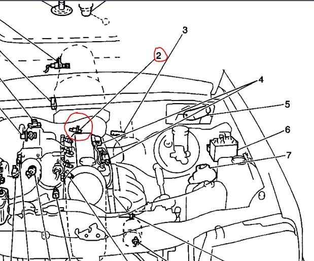

My first suspect was the crankshaft position sensor. If that is working, then my next suspect is the camshaft sensor. The powertrain control module (PCM) uses reference pulses from the camshaft position sensor (CMP) sensor in order to determine engine speed. The PCM cannot operate the ignition system - or the fuel injectors - without the engine speed signal from the CMP.
The CMP is located top rear of the engine. See pic 1.

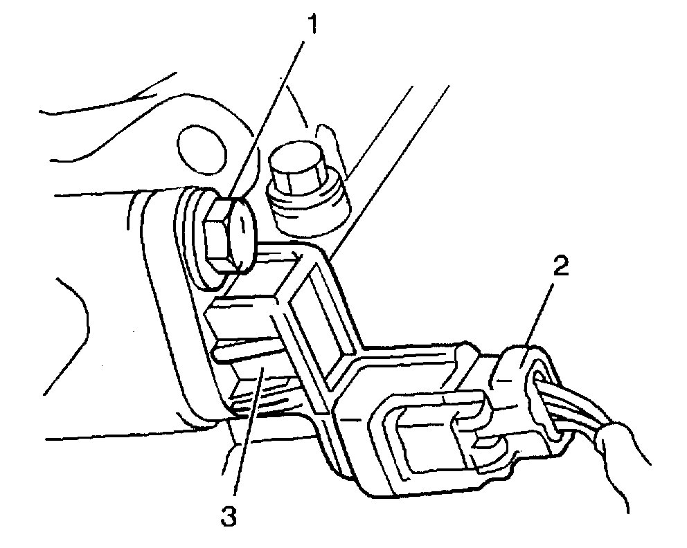

Here are the directions for replacement. Pic 2 correlates with the directions.

CAMSHAFT POSITION (CMP) SENSOR REPLACEMENT
See Pic 2
REMOVAL PROCEDURE
1. Remove the CMP sensor electrical connector (2).
2. Disconnect the ground strap.
3. Remove the CMP sensor retaining bolt (1).
4. Remove the CMP sensor (3).
1. Apply a thin coat of engine oil to the sensor O-ring.
2. Install a CMP sensor (3).
3. Install the retaining bolt (1).
Tighten
Tighten the retaining bolt to 9 N.m (78 lb in).
4. Reconnect the CMP sensor electrical connector (2).
5. Reconnect the ground strap.

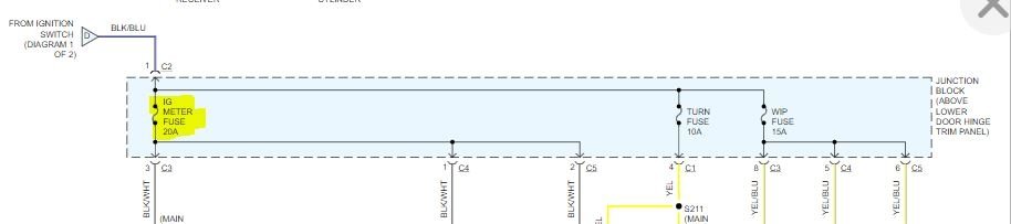

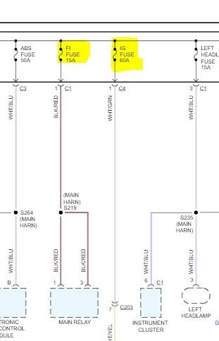

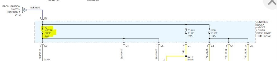

Okay, next check to make sure the ignition meter fuses is good. See pic 1. I highlighted the fuse. Also, check the two fuses indicated in picture 2. Picture 1 is in the vehicle and 2 us under the hood.
If the cam and crank sensors are good, the coils (which have a built in ignition control module) are new, you have power to the sensors, and the fuses are good, the next thing is the power control module. However, you checked the cam sensor connections and they checked good. That was coming from the PCM, so lets hope it's just a blown fuse.
Let me know what you find.
Jul 5, 2019 at 10:39 AM
WILLIINTALKEETNA
  • 11 POSTS
I don't quite get why a fuse problem would allow the engine to run fine cold and not run hot. But in the interests of being thorough, I checked everything. I have good fuses, good clean connections with no corrosion at all in any connection, and electrical continuity everywhere. . .

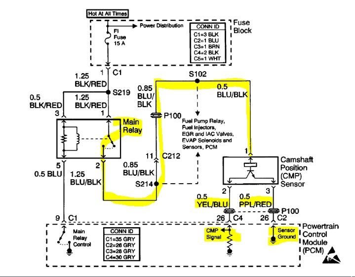

Also, if you look at the attached picture, it is an OEM schematic of the camshaft circuit. When the vehicle fails, I need you to confirm power and ground to the ground circuit at the PCM. If there is no ground, then the PCM has failed. That is what completes this circuit. Maybe heat is affecting it.
