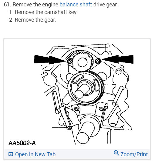

The engine vibrates badly. We have replaced the torque converter because the Ford mechanic said it was bad and the balancing shaft looks good, but it still shakes. What could be causing the engine to shake so badly? Could it be a problem with the harmonic balancer?
May 16, 2016 at 9:10 AM
CARADIODOC
  • 34,381 POSTS
It sounds like you have a balance shaft drive gear that is stripped and not running the shafts here is a diagram of what I am talking about below. Check out the diagrams (Below). Please let us know what you find. We are interested to see what it is.

As I recall, your balance shaft is run by a pair of gears so that is not likely to get out-of-time on its own. You mentioned that was checked, but it takes more than just looking at the shaft. The timing marks must be checked. If it were possible for something to jump time, the equivalent of one tooth off on a balance shaft is enough to cause a noticeable vibration.

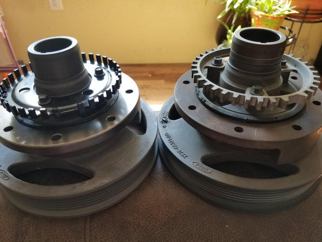

POTATO2
i found my 3.8 harmonic balancer pulley moved
this dont throw codes . the engine just had bad vibration. you can see the position of the weighted balancer to position of key slot from old balancer on right to new on left. the engine is running very smooth no shaking at all.
Sep 15, 2017 at 7:09 AM
CARADIODOC
  • 34,381 POSTS
Thanks for your addition. Your dandy photo shows that this is yet a third design. Most of the trouble comes from those that use the outer cast iron ring as the pulley. That is bonded to the hub, and that gel can let go, then the weighted pulley can rotate on the hub. Older balancers used a non-weighted one-piece cast iron balancer with a stamped steel pulley bolted to it. It looks like yours is a one-piece design with an offset weight pressed onto the hub. Just another way of doing the same thing.
