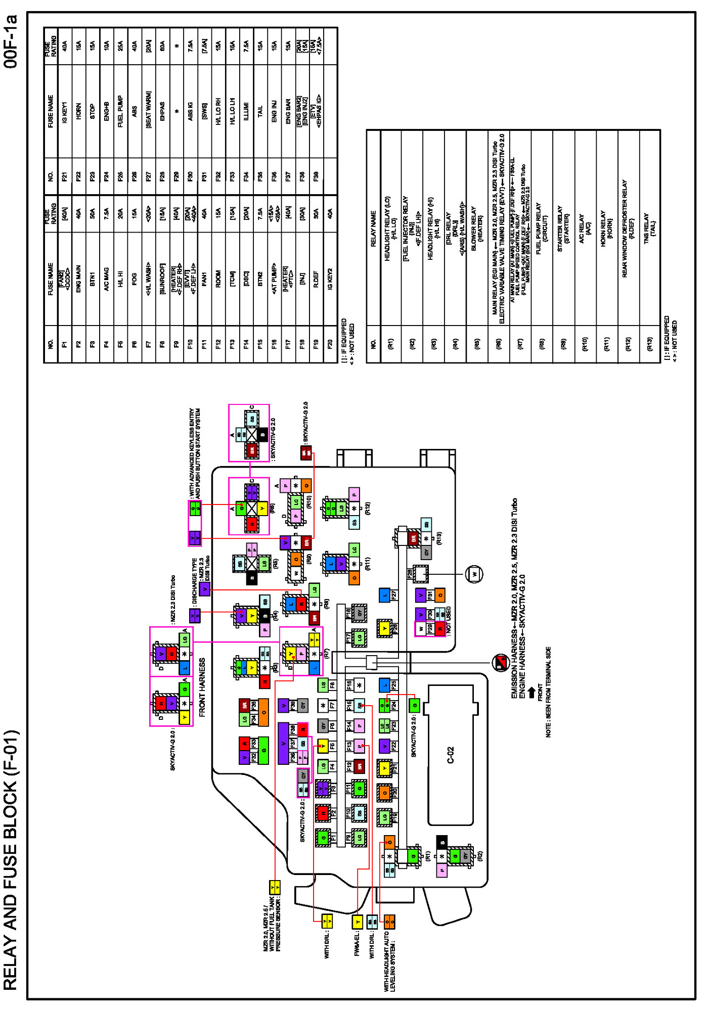

Whenever the engine is idling after reaching operation temperature, the engine vibrates intermittently which can be felt inside the cabin.

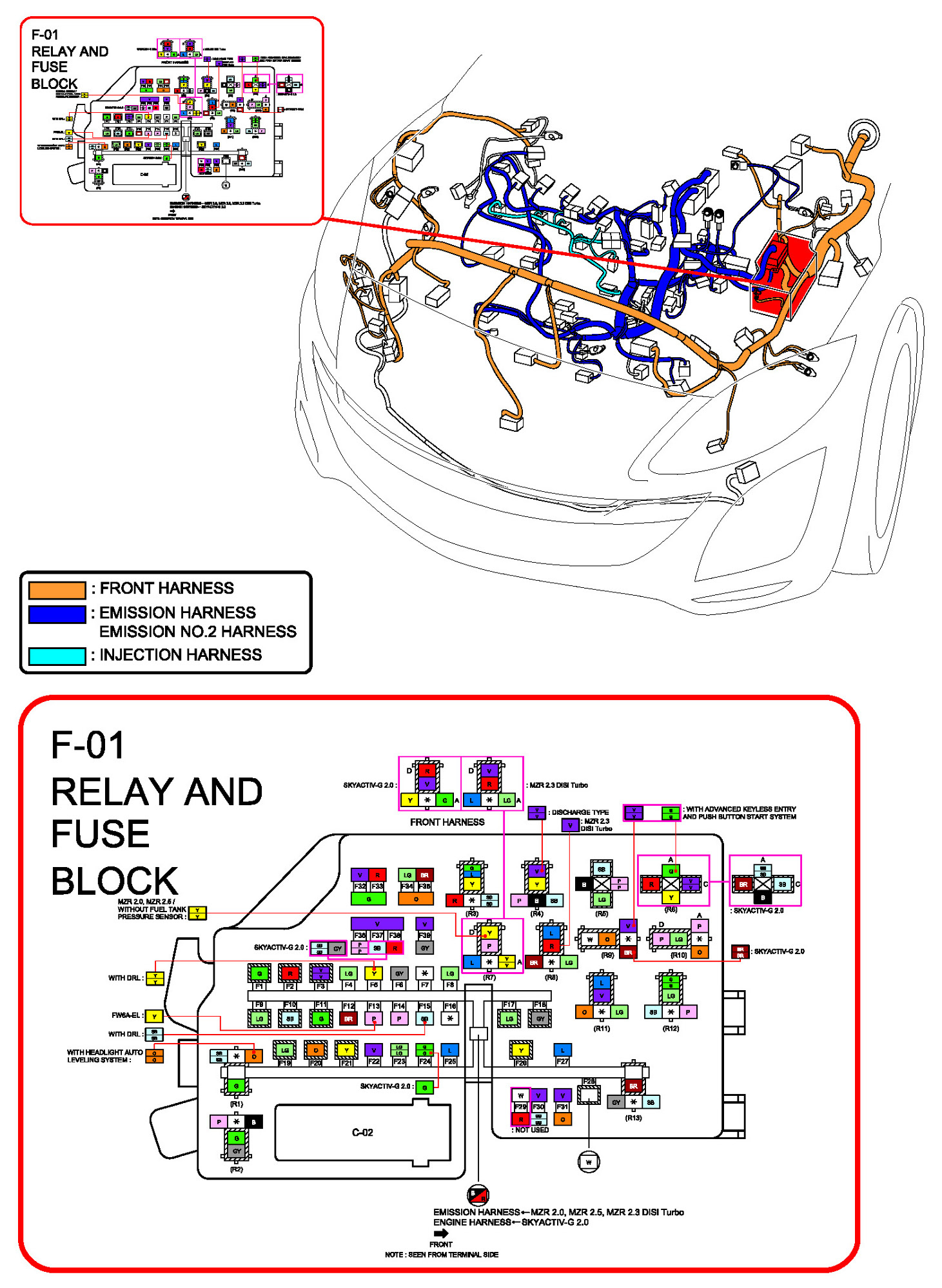

I would bet it is doing it when the A/C compressor is engaged. Today's cars will run the A/C compressor, even if the heat is on full blast. I believe it has something to do with moisture control. Running the A/C compressor puts some extra stress on the engine. If the engine needs some form of tuning up, it can shake a little when running it. It is fairly normal. If the car is still under warranty, then I would suggest taking it to the dealer and letting them do their thing with it. If not, then I would suggest removing Relay number r10 (pictured in the second image below) and then seeing if the intermittent vibrating goes away. If it does, then at least we know where to start. If not, we will have to look at other possibilities.
So let us know what happens.
