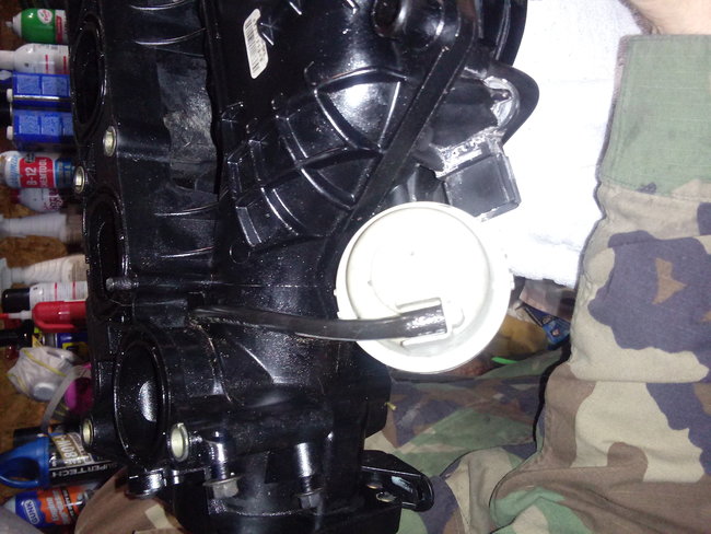

On the back of the intake manifold there is a gray bulb with a hose connecting to the engine air shutoff control. What's the name of the gray part?
Image (Click to enlarge)
Feb 1, 2020 at 10:31 PM
Experienced Mechanic
18,907 POSTS

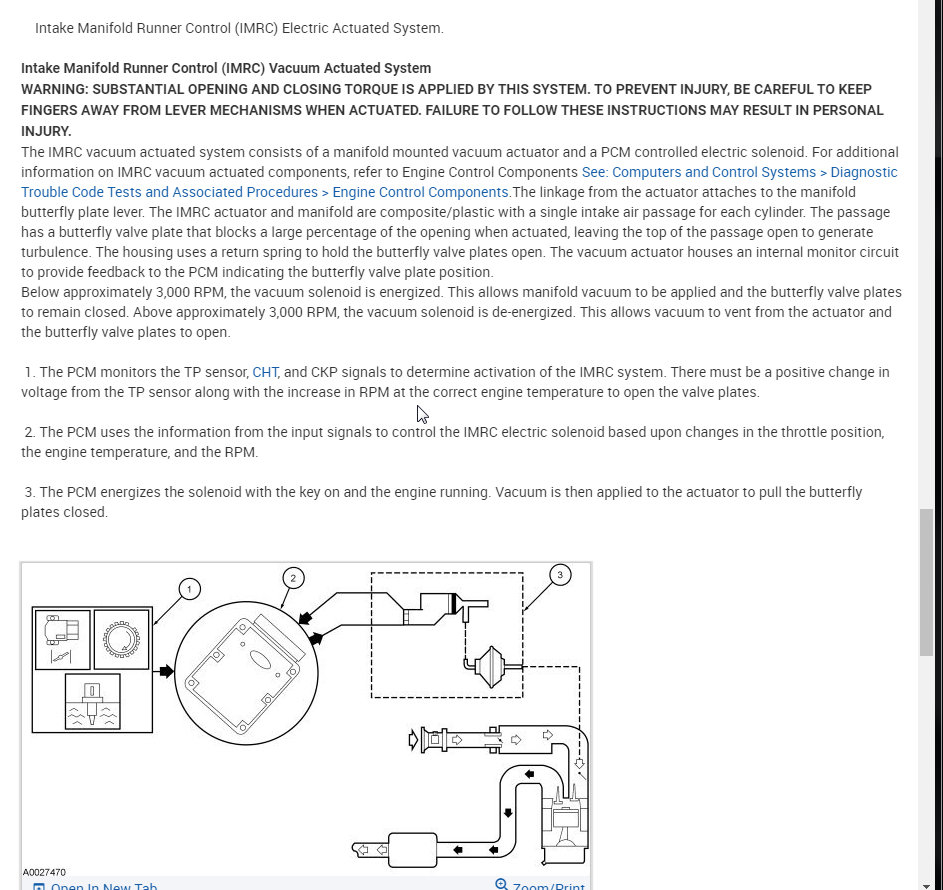

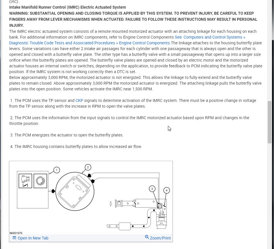

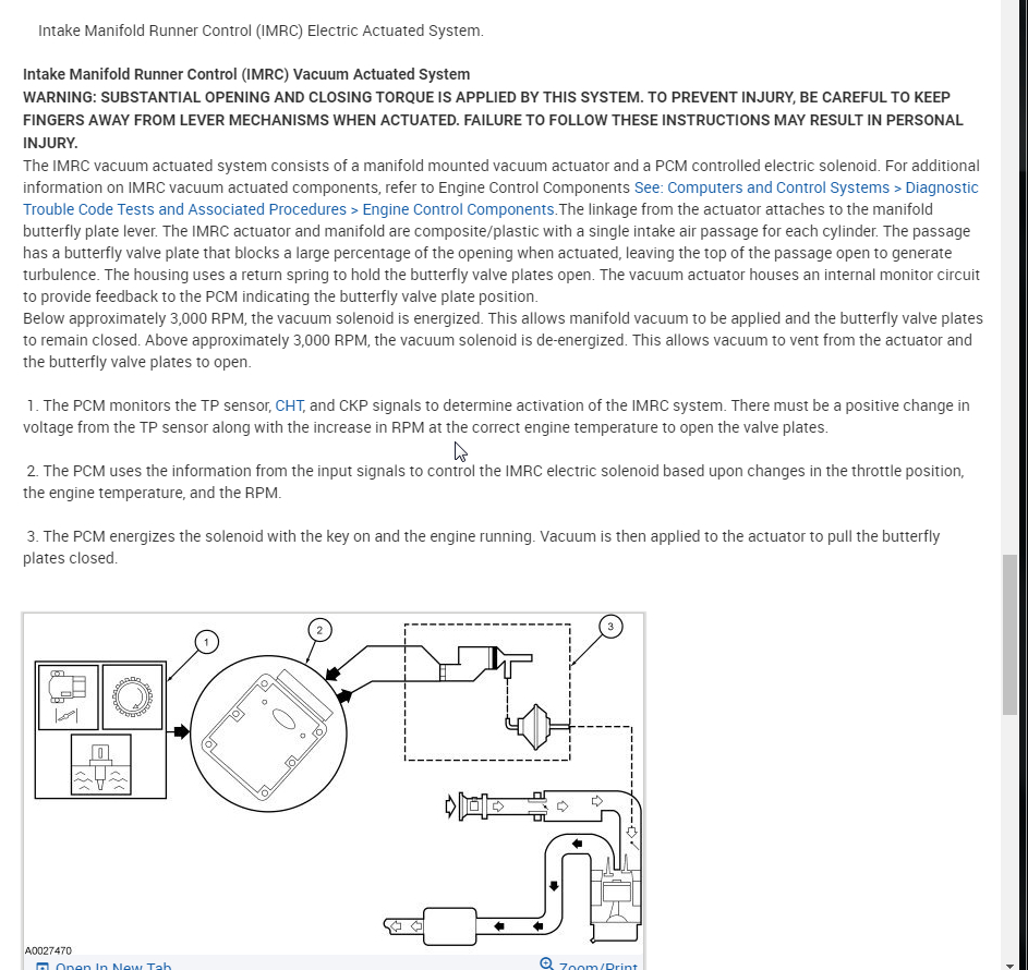

Can you get a picture of the bottom? Is there a linkage attached to the bottom of it? I suspect it is the intake manifold runner control actuator.
Send a picture of the bottom or other angles of it and we can figure it out for sure.
