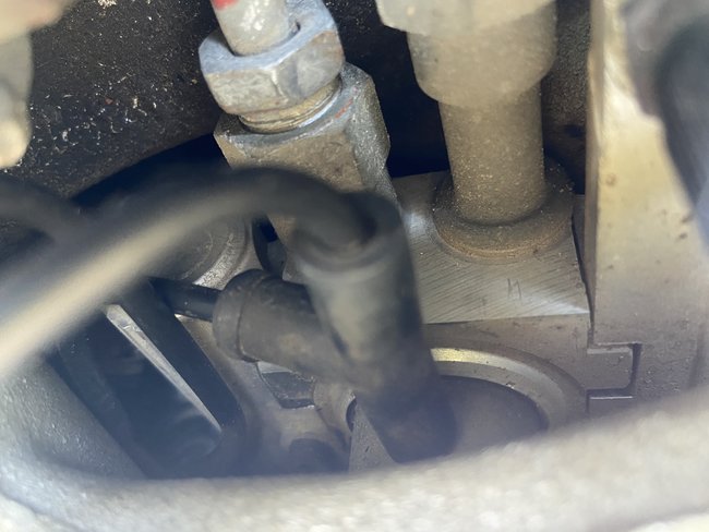

I turned the key and no fuel came out of the vacuum line. I know I can also pressure test it but I’m not sure if it’s worth it. Do you know what else it could be?
Jan 21, 2020 at 2:38 AM
JTS234
  • 10 POSTS

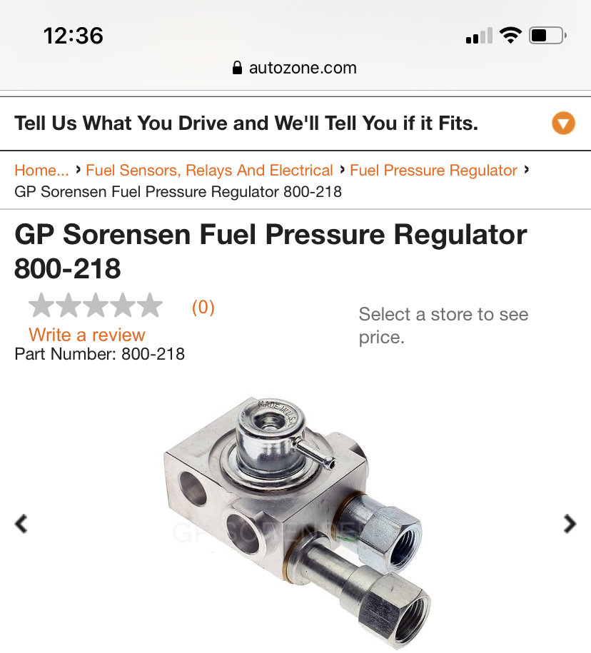

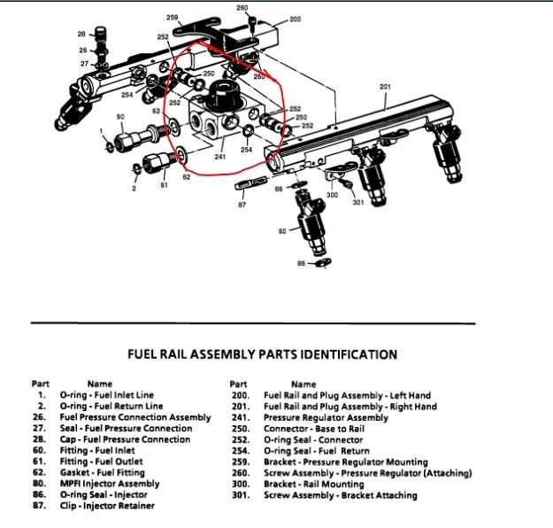

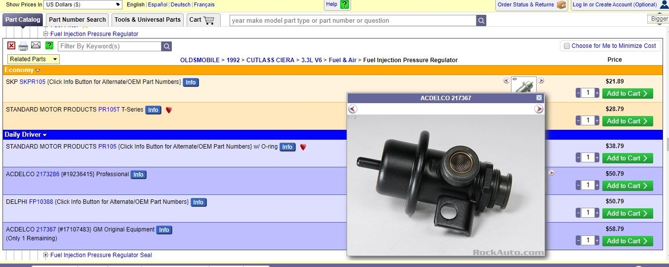

I also uploaded what my fuel pressure regulator looks like.
Jan 21, 2020 at 2:39 AM
Okay, that is the 3.3 engine, not the 3.1.
Okay, the only other way that fuel can get into the system like that is from the injectors.
I would release the fuel rail and lift it up with the injectors attached. Turn the key on and see if any of the injectors are leaking.
Jan 21, 2020 at 2:53 AM
