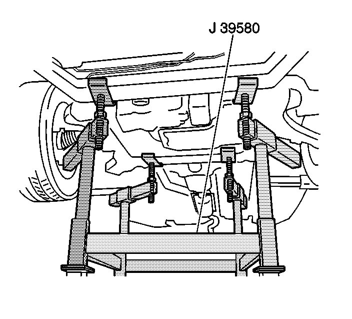

28. Caution: Failure to disconnect the intermediate shaft from the rack and pinion steering gear stub shaft can result in damage to the steering gear and/or intermediate shaft. This damage may cause loss of steering control which could result in an accident and possible personal injury
Remove the intermediate shaft pinch bolt from the steering gear.
Picture 1
29. Lower the vehicle until the frame contacts the trans-axle table.
30. Remove the frame bolts.
31. Raise the vehicle in order to separate the power-train/frame assembly from the vehicle.

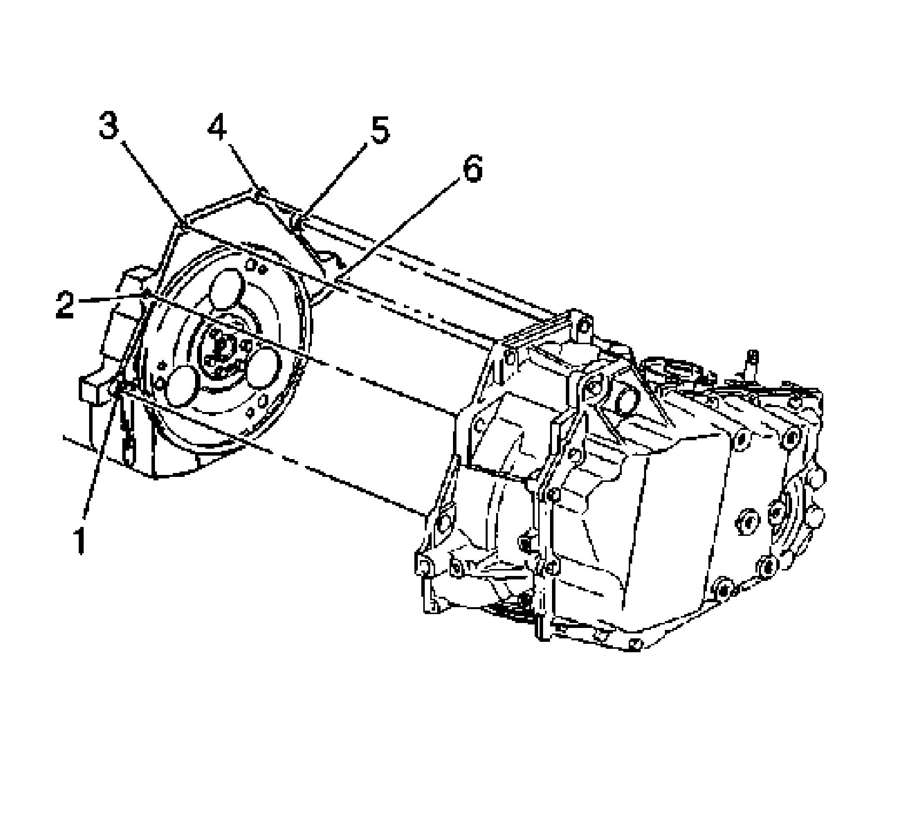

32. Remove the starter.
33. Remove the engine flywheel to torque converter bolts.
Picture 2
34. Install engine hoist to engine.
35. Remove engine mount to frame nuts.
36. Remove the engine-to-trans-axle bolts (3, 4, 5, 6) and studs (1, 2).
37. Separate and remove the engine from the trans-axle/frame and install to the engine stand.
