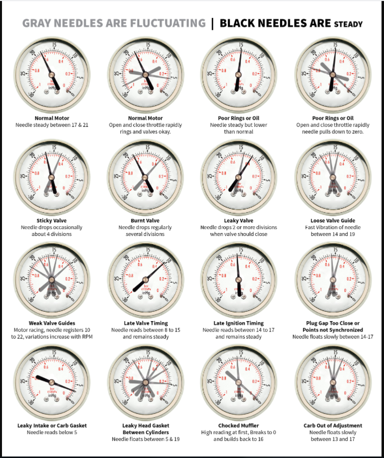

If you have no external vacuum leak, I would hook a vacuum gauge to it and make sure the intake valves are not leaking either.
