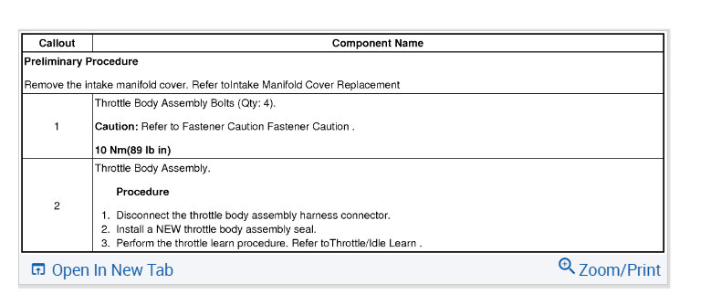

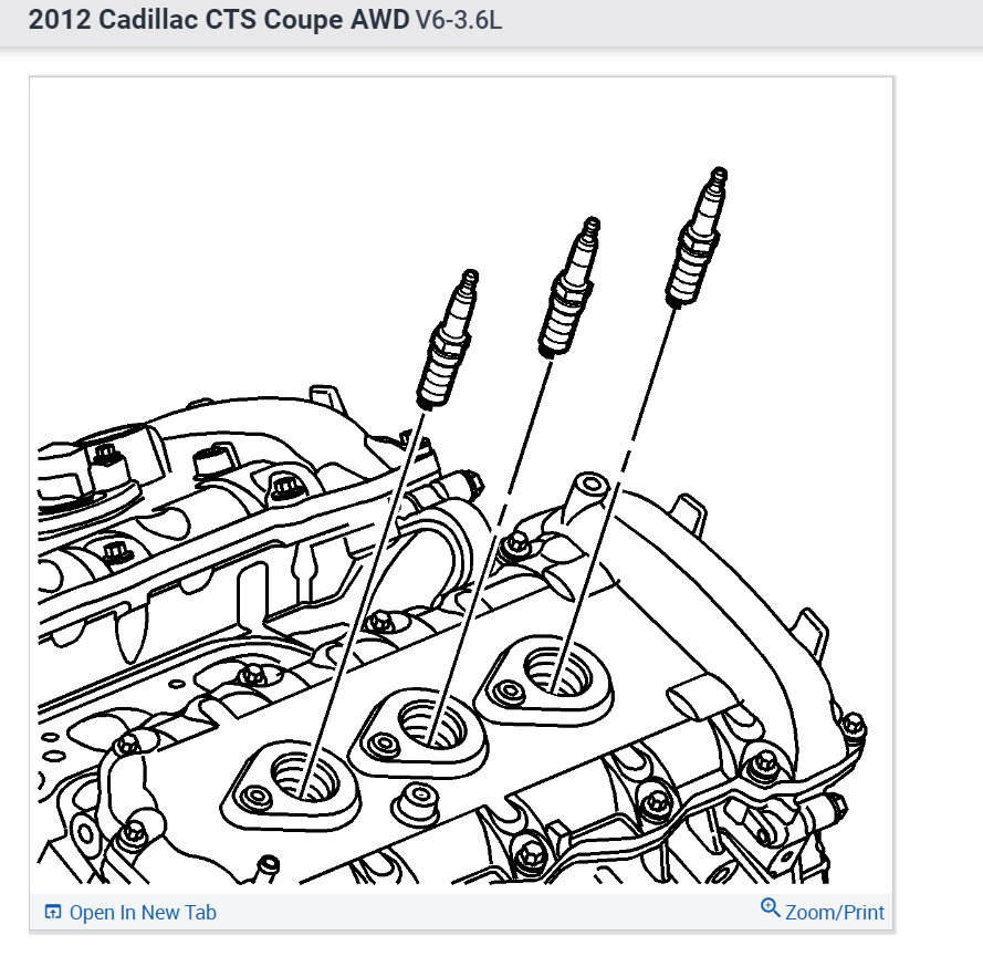

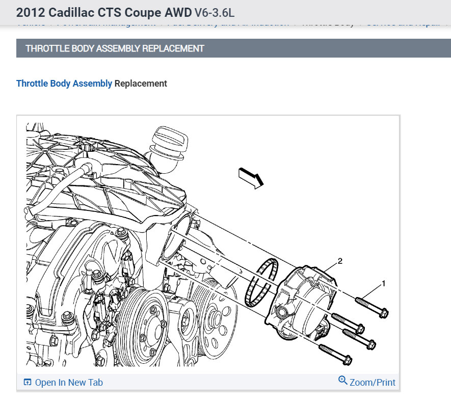

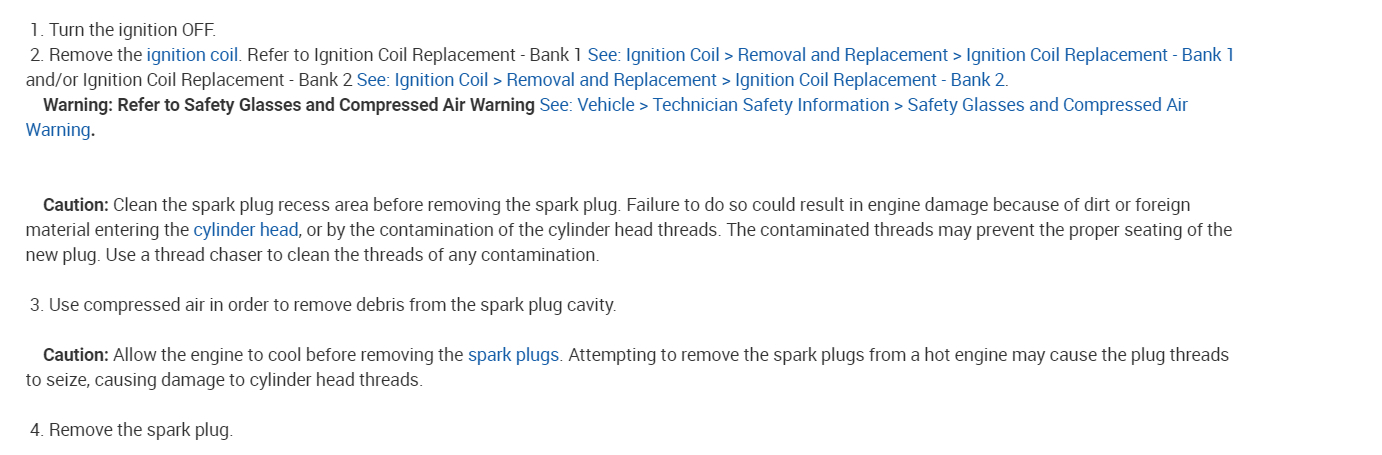

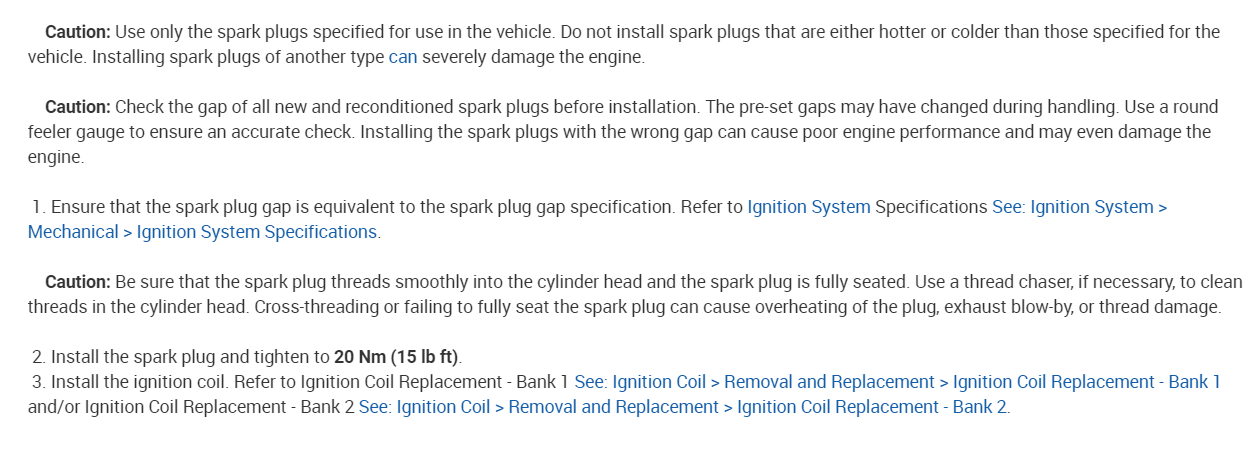

The engine stumble is usually caused by a vacuum leak, or a throttle bore that needs to be serviced. Also, you should install new spark plugs as part of a regular tune-up service. Here is a guide to help walk you through the steps with instructions in the images below to show you how the services are done on your car:
https://www.2carpros.com/articles/how-to-tune-up-a-car-engine
This guide, only do this when the engine is cold:
and
Check out the images (below). Let us know what happens and please upload pictures or videos of the problem so we can see what's going on. If you leave the wires connected to the throttle body, you should not need to perform the throttle body relearn.

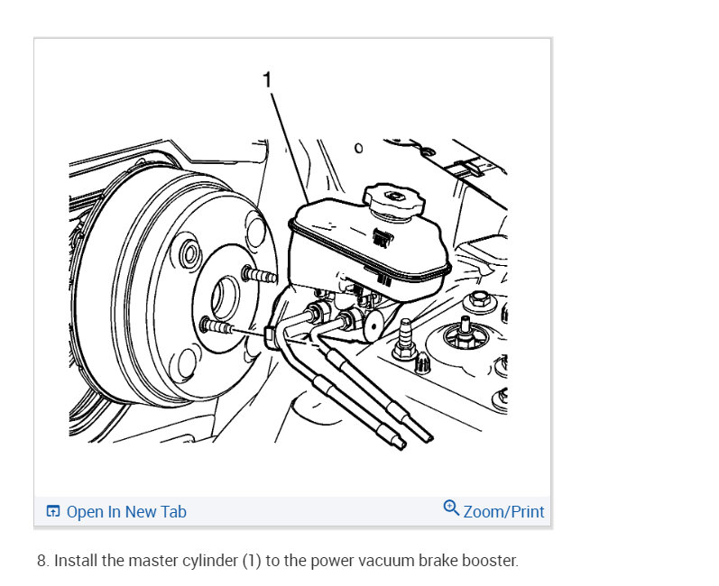

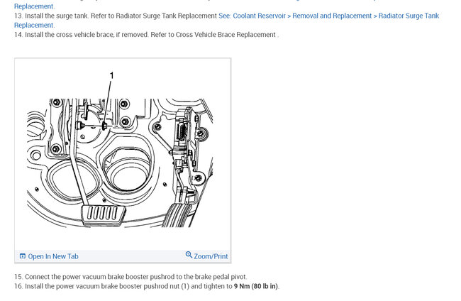

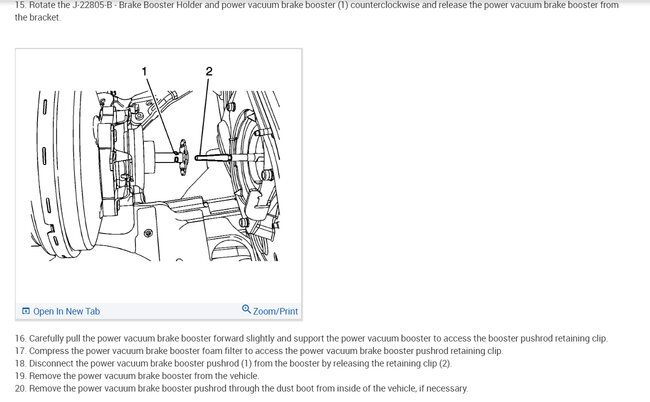

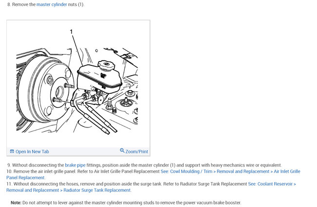

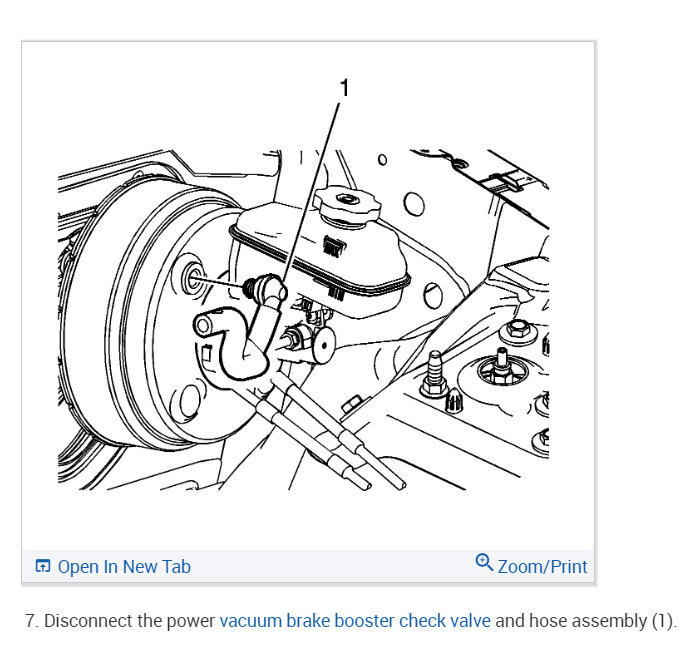

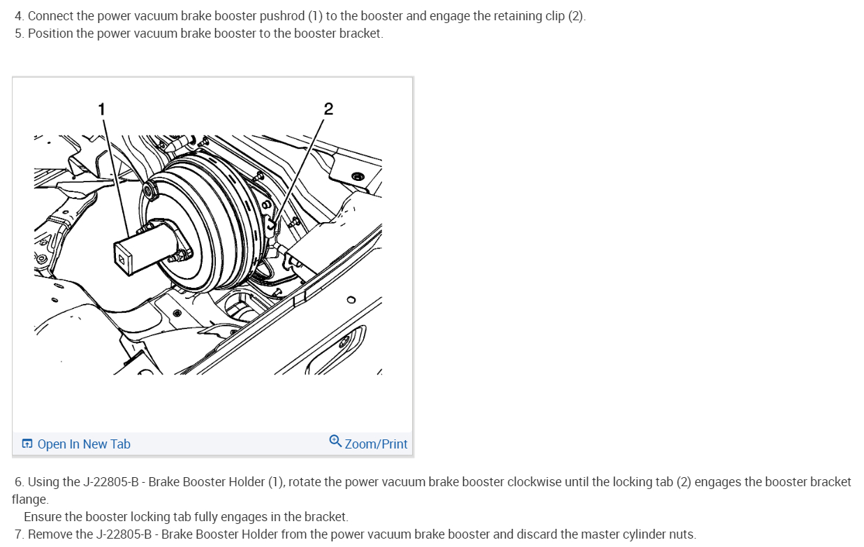

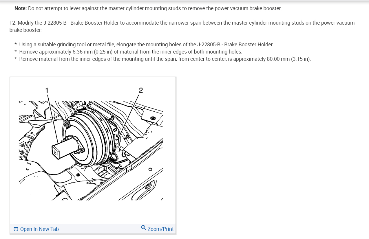

I just noticed that when engine running, parking brake on, put in drive it idles smooth, then apply the brakes, and engine runs rough.
Mar 14, 2023 at 12:24 AM
  • 55,381 POSTS

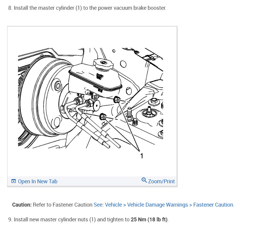

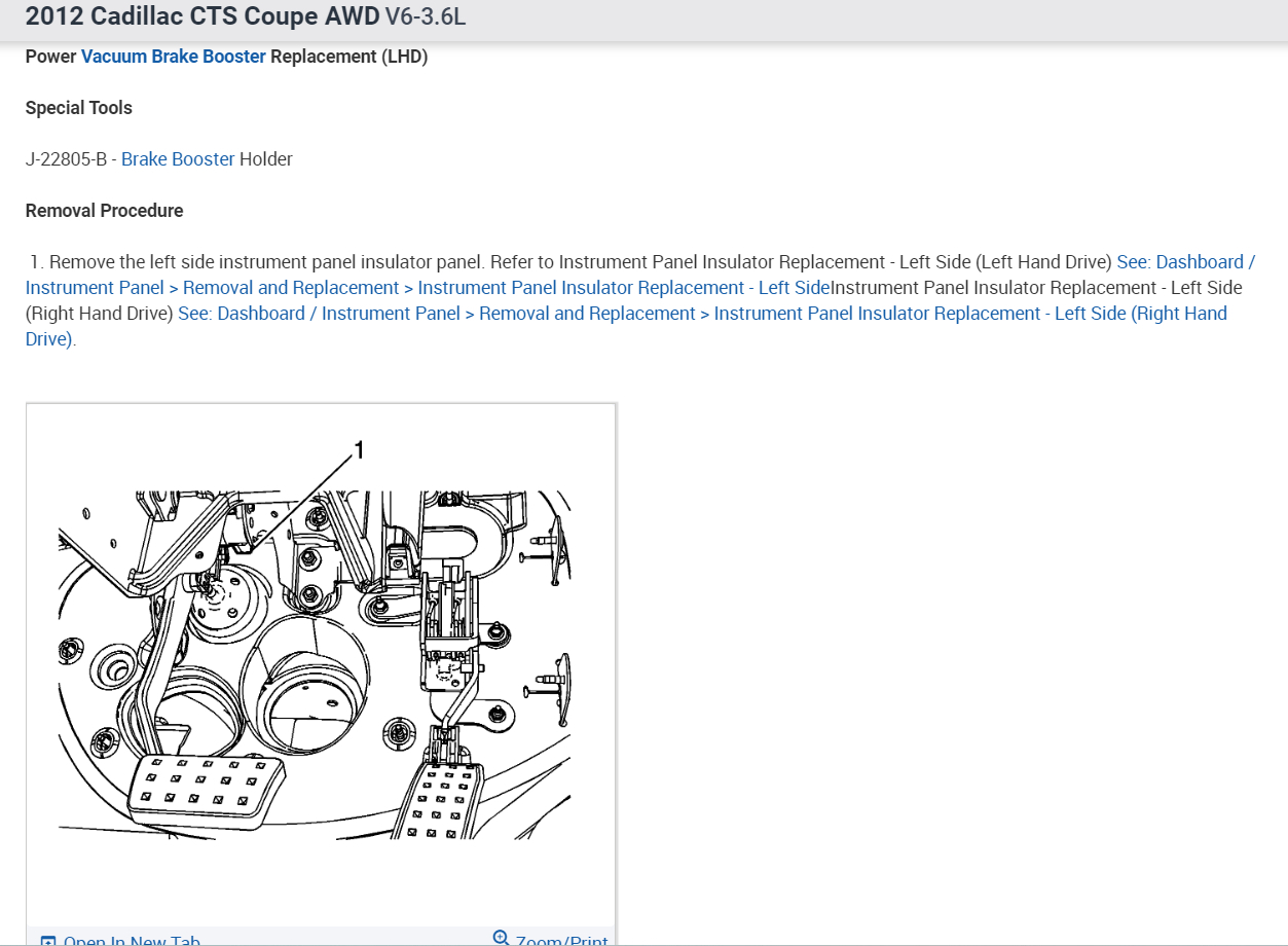

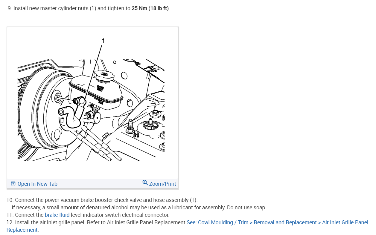

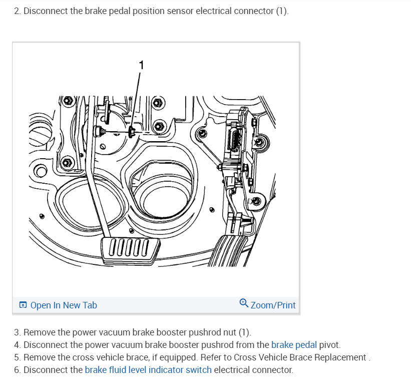

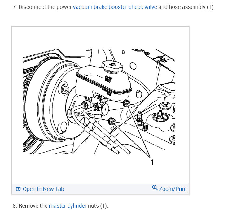

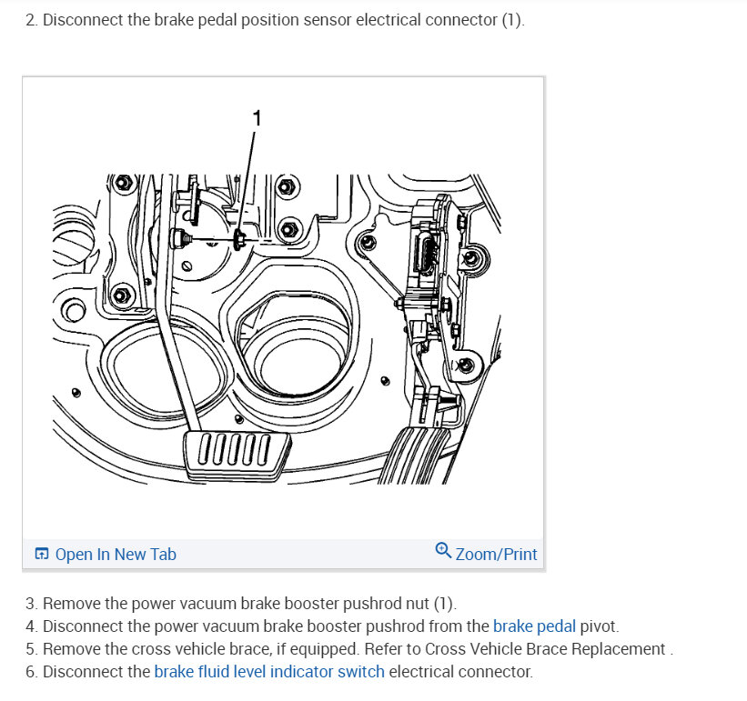

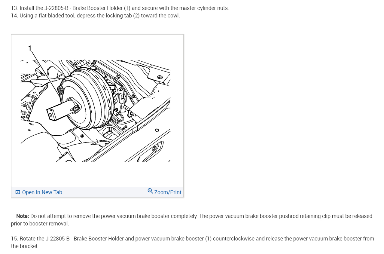

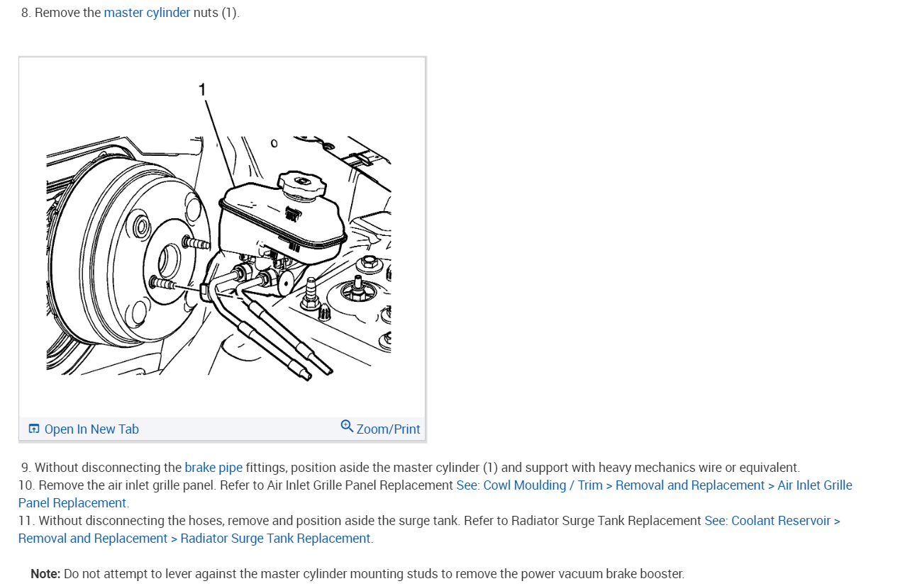

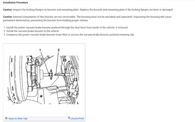

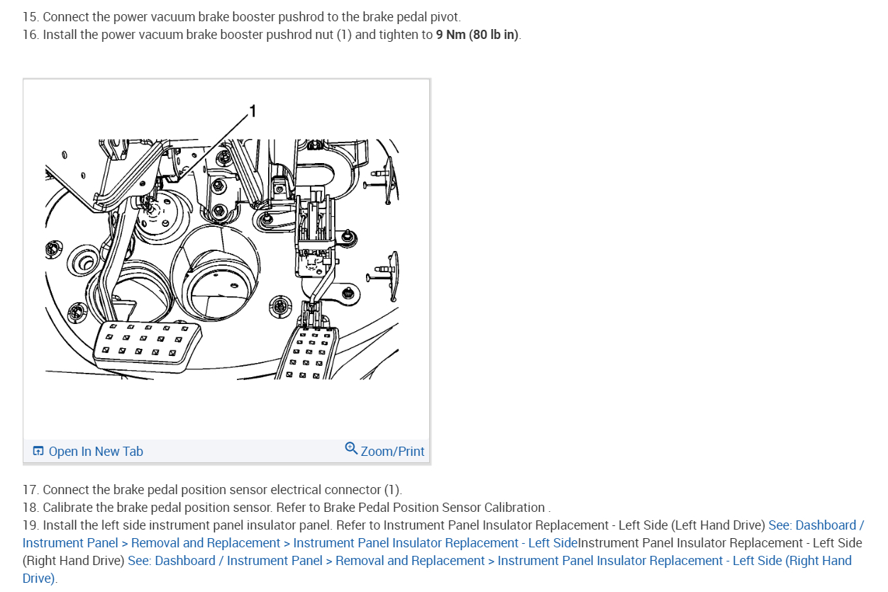

That is a good find, this can mean the brake power booster is leaking but to be sure you can close off the vacuum line to the booster and try it again, if the engine stays smooth you have found the problem. Here is how to change the booster out in the images below.
