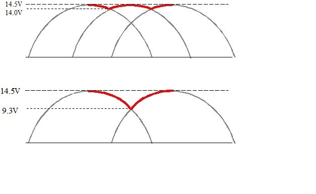

This drawing shows ripple voltage. The top waveform is typical for a properly working system. Professional load testers will show it as "normal". If it's measured for a printout, it will be listed as 0.5 volts, which is pretty low. The lower waveform shows what happens when one diode has failed. One of the three phases is missing. During the time that output isn't there, the output voltage drops real low, in this case, to 9.3 volts.
