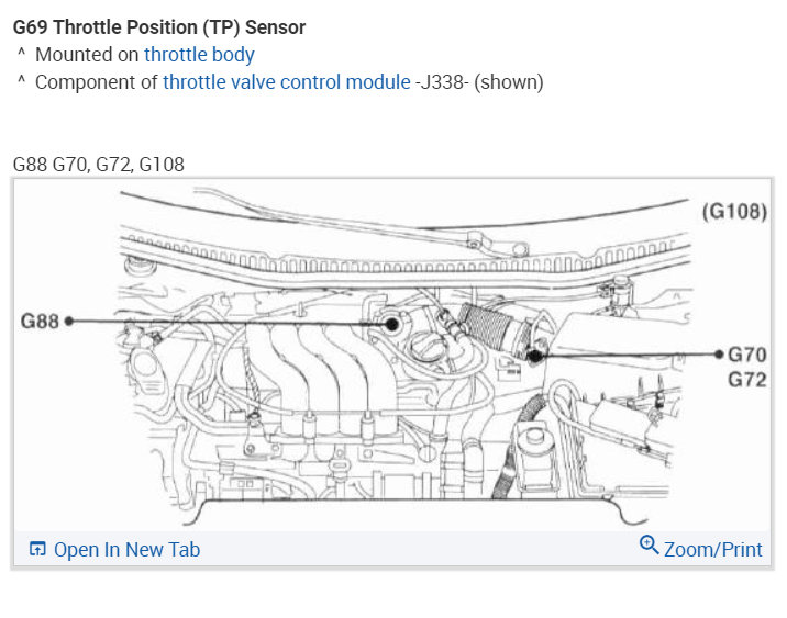

Scan tool showed low signal coil 3, and misfire on cylinder 3. Changed coil pack, plugs and wires. Now the car won't stay running for long. Starts right up, but either runs with a really rough idle (motor shakes the whole car) or stalls and dies immediately. Please help!

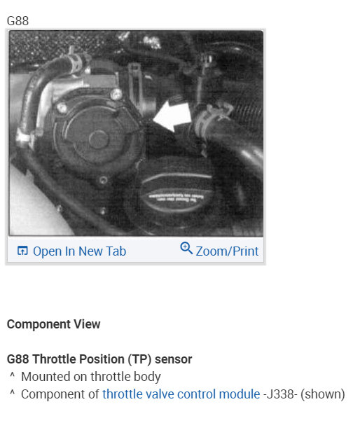

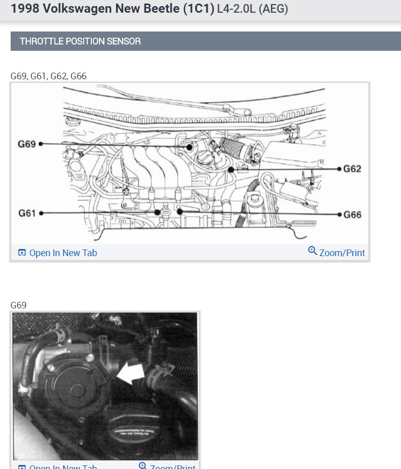

Thanks for the help. Ran compression, read a little low (135 - 140) . But that's across all four cylinders and within accepted range so I figured it was okay. Ran scan tool again after and now I'm not getting the misfire code. But I'm now getting p1543, and the symptoms are the same. I'm so lost. Could I have done something to damage my throttle body, actuator or position sensor?

Also getting p0121 code.

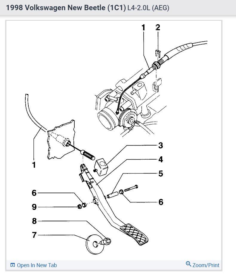

These are throttle body codes I would replace the TPS and clean the throttle bore. here is a guide and diagrams below to help you get he job done:
