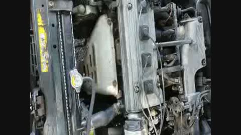

My car is stalling while idling and keeps shutting off while trying to drive it almost like a misfire. I replaced the MAP sensor and the distributor cap plus the sparks plugs. I was thinking maybe o2 sensor?

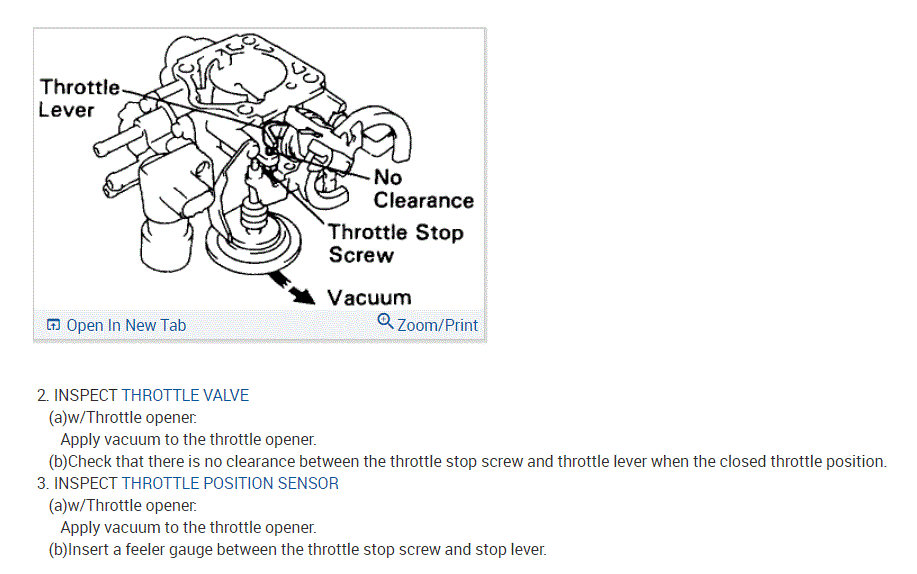

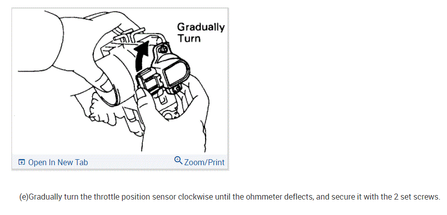

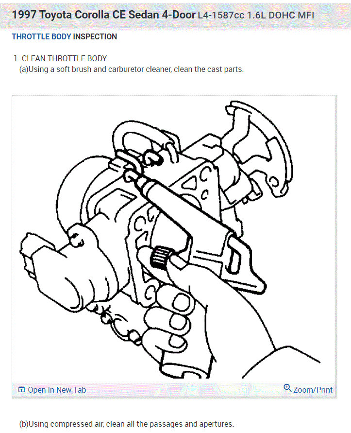

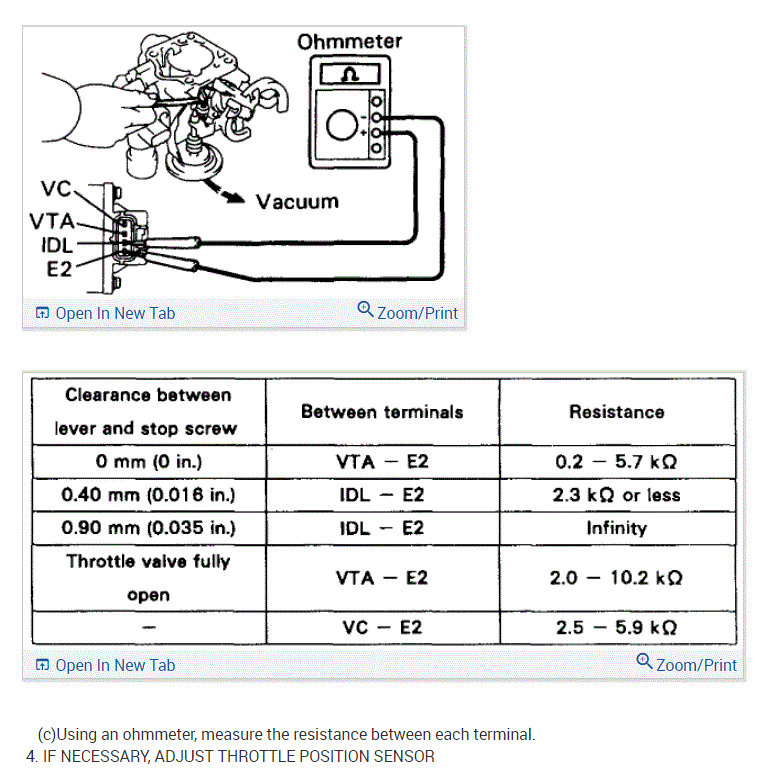

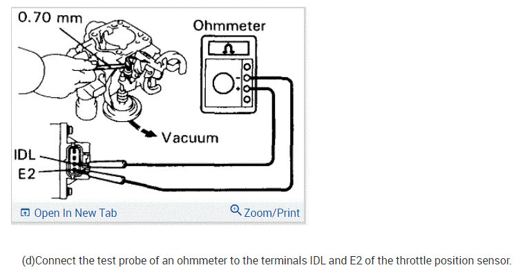

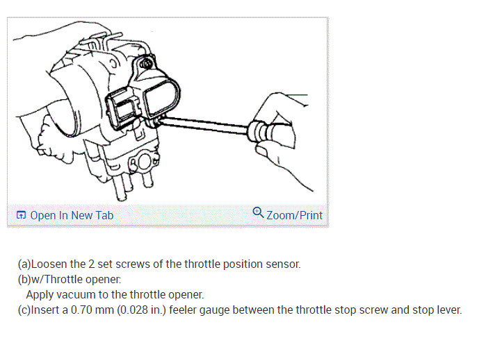

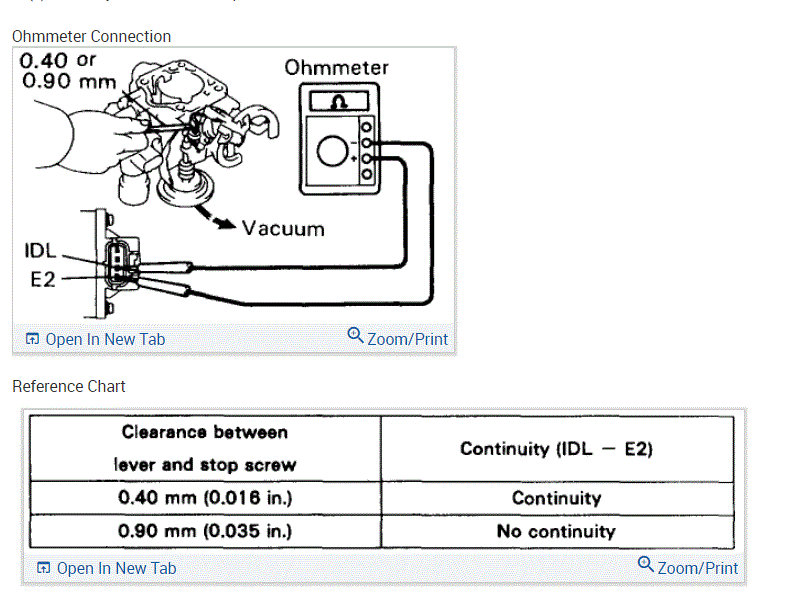

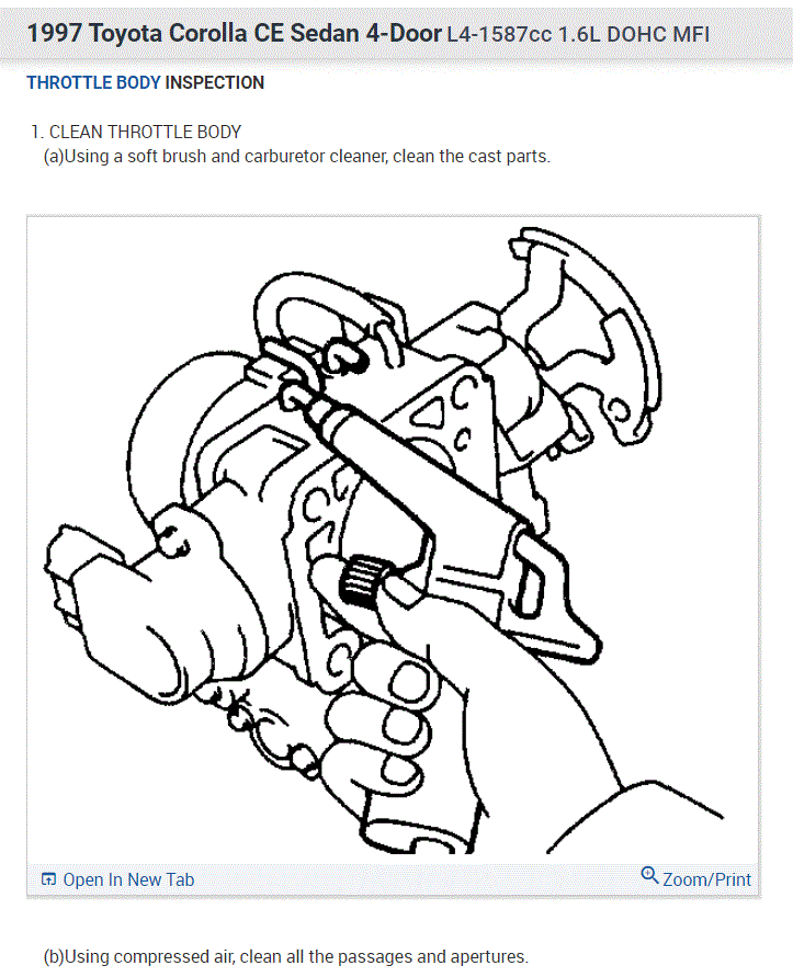

No odors or smells. i have no check engine light. i have narrowed it down to either the TPS or bad gas. starting to think TPS. I believe it isn't working properly.
Jun 26, 2021 at 11:21 AM
  • 110,248 POSTS
It could be possible. I am attaching information below that is related to checking and servicing the throttle body. There are tests related to the TPS.
Take a look through these and see if you are comfortable doing the tests.
Let me know what you find.

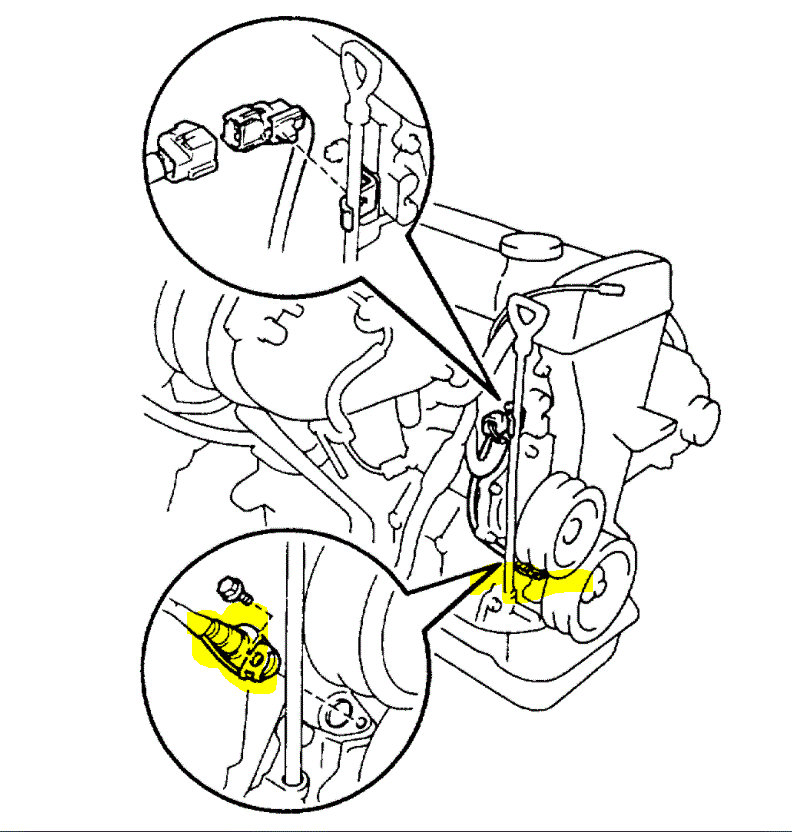

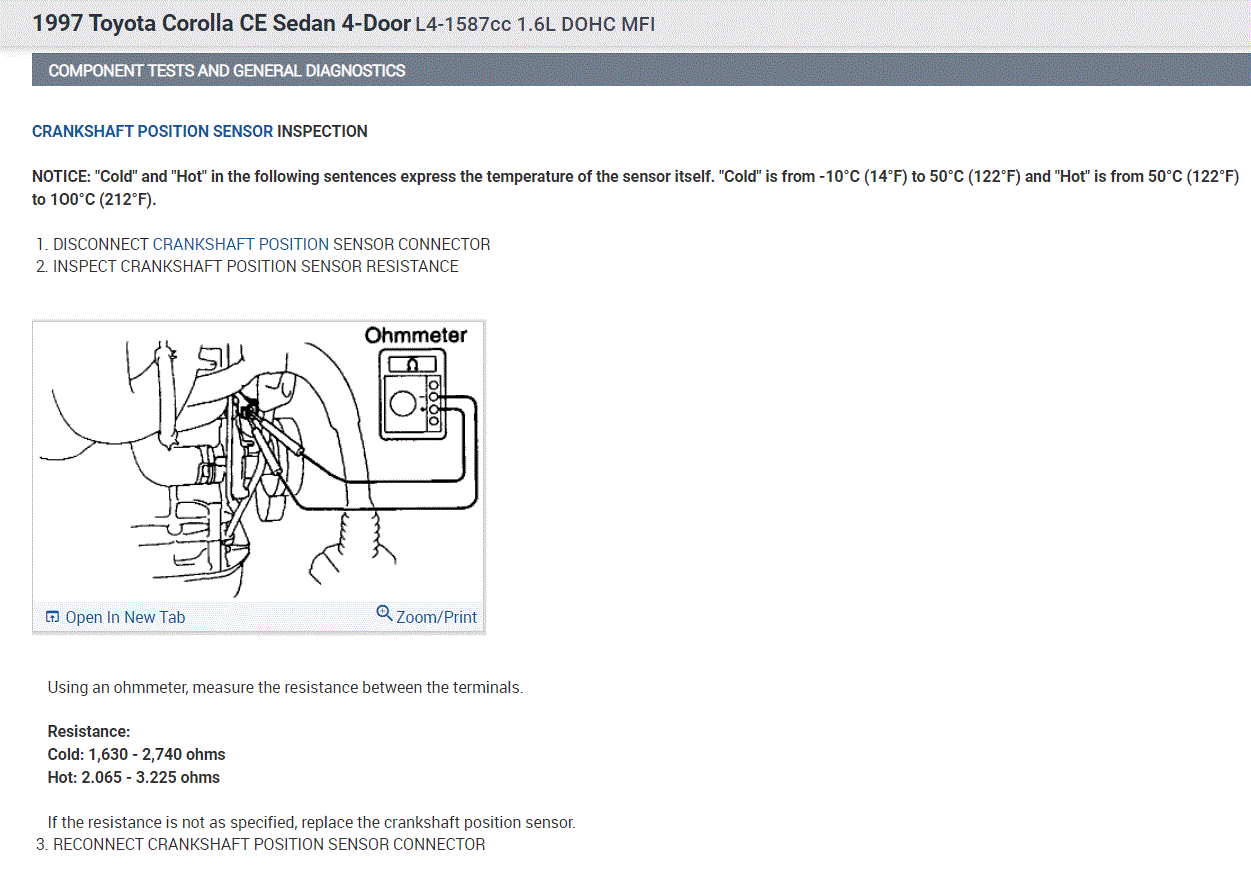

Okay. I need you to check the crankshaft position sensor. It could be causing the issue. If you look at pic 1 below, it shows how it's checked. Pic 2 shows its location.
If the sensor checks good, before we spend more on repairs, let's confirm that engine compression is good. Low compression can be the cause and it has a lot of miles. You will need a compression gauge, but most parts stores will lend one to you.

Crank shaft sensor is brand new just paid $100.00 for it last month.
