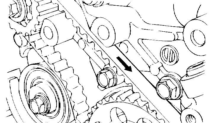

I don't think anything like this resulted from what you did. Based on your description, it sounds like a bad crankshaft position sensor. When they start going bad, they will fail when hot. Take a look through these links:
https://www.2carpros.com/articles/how-a-crank-shaft-angle-sensor-works
Now, if you feel the symptoms you experience mirror what is listed above under symptoms, then we need to confirm that is the issue because on this vehicle, the timing belt needs removed to replace the sensor.
Interestingly, a bad sensor may or may not set the check engine light to come on, so depending on trouble codes may provide a false positive. So, what I suggest is this. You need to get your hands on a live data scanner. With the scanner, see if the crank signal is lost or if the RPM signal is lost when the engine dies and won't restart. If the signal is lost, then most likely the sensor is bad.

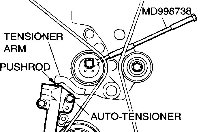

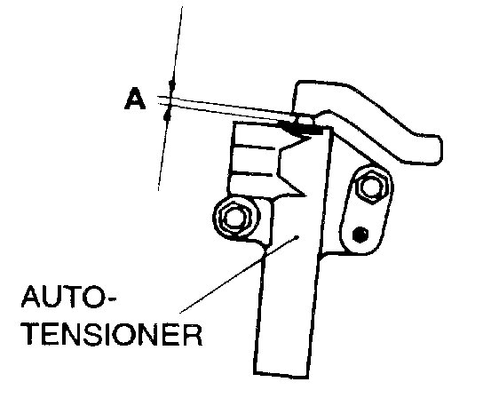

Here are the directions for removal and replacement of the timing belt. I'm adding them if you determine this is the problem. All attached pictures correlate with the directions. The first picture I attached shows the crankshaft position sensor.

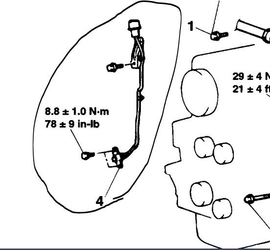

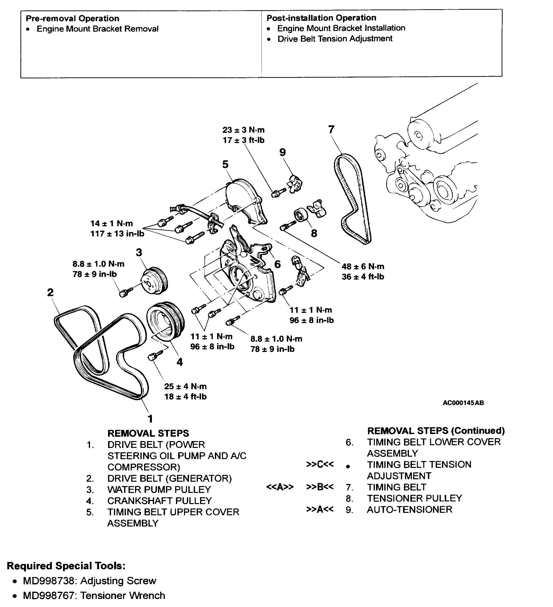

pic 2
REMOVAL AND INSTALLATION
REMOVAL SERVICE POINT
[[A]] TIMING BELT REMOVAL

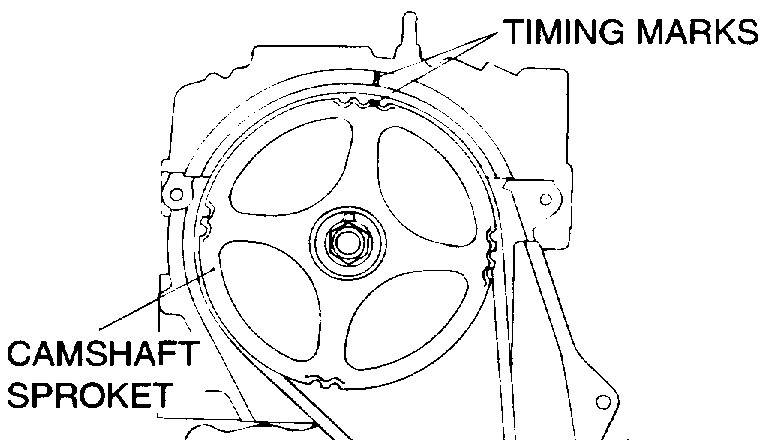

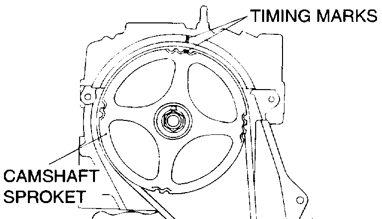

pic 3
1. Turn the crankshaft in the forward direction (to the right) to align the camshaft sprocket timing marks.

]]A[[ AUTO-TENSIONER INSTALLATION

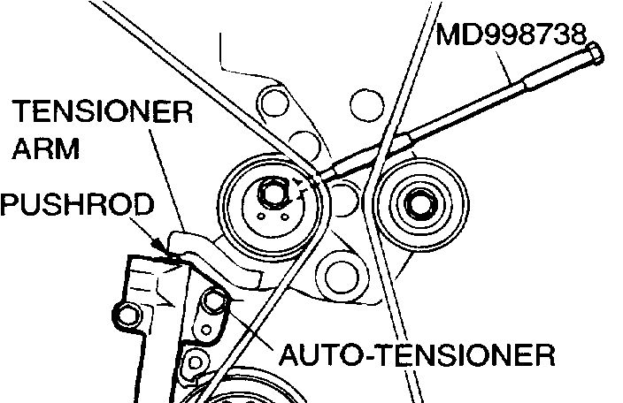

pic 5

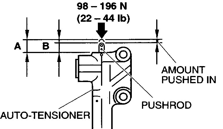

1. Apply 98 - 196 N (22 - 44 pound) force to the pushrod of the auto-tensioner by pressing it against a metal object (such as the engine block) and measure the movement of the pushrod.
Standard value: Within 1 mm (0.04 inch)
A: Length when it is free (not pressed)
B: Length when it is pressed
A-B: Movement
2. If it is outside the standard value, replace the auto-tensioner.
CAUTION: Never compress the pushrod too fast, or it may be damaged.

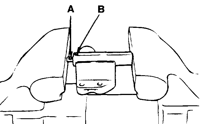

pic 6

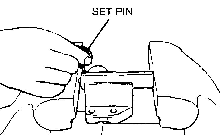

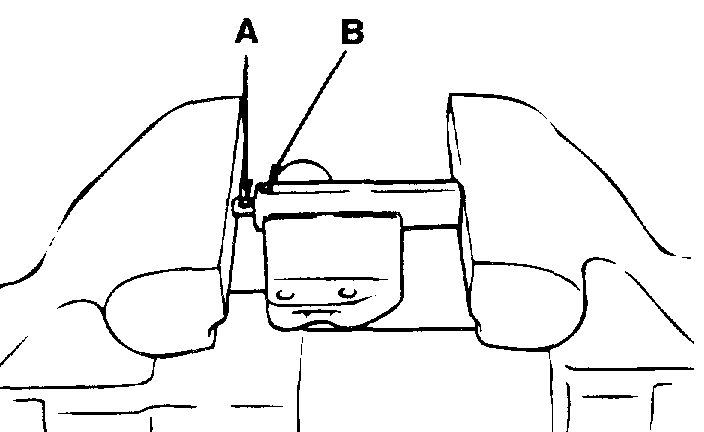

3. Use a press or vise to gently compress the auto-tensioner pushrod until pin hole A of the pushrod and pin hole B of the tensioner cylinder are aligned.
pic 7
4. When the holes are aligned, insert the set pin.
NOTE: When replacing the auto-tensioner with a new part, the pin will be in the auto-tensioner.

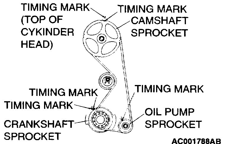

1. Align the timing marks on the camshaft sprocket, crankshaft sprocket and oil pump sprocket.

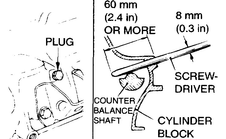

2. After aligning the timing mark on the oil pump sprocket, remove the cylinder block plug and insert a Phillips) head 8 mm (0.3 inch) screwdriver. Check to be sure that the screwdriver goes in 60 mm (2.4 inches) or more. If the screwdriver will only go in 20 - 25 mm (0.8 - 1.0 inch) before striking the counterbalance shaft, turn the sprocket once, realign the timing marks and check that the screwdriver goes in 60 mm (2.4 inches) or more. The screwdriver should not be taken out until the timing belt is installed.

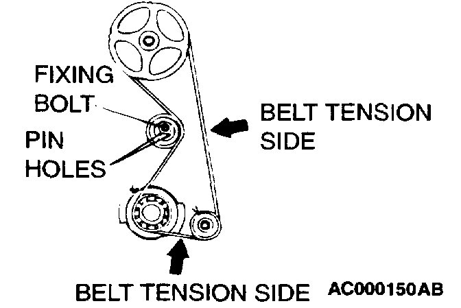

pic 10

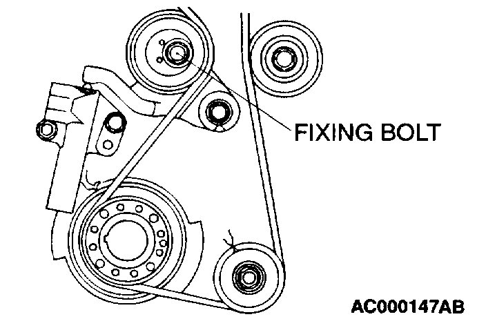

4. Set the tension pulley so that the pin holes are at the bottom, press the tension pulley lightly against the timing belt, and then provisionally tighten the fixing bolt.
5. Adjust the timing belt tension.

1. Remove the rubber plug from the rear of the timing belt cover assembly. Then screw in special tool MD998738 by hand until the tensioner arm is touching the auto-tensioner pushrod.

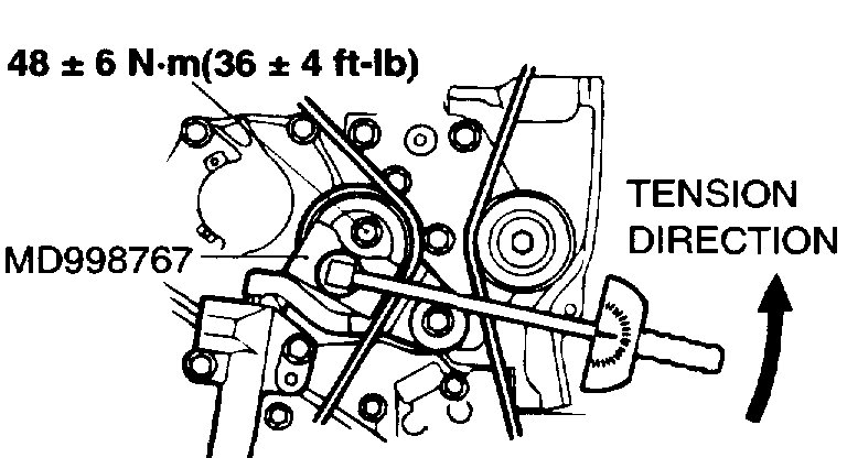

pic 12
3. Loosen the tension pulley fixing bolt, and then use special tool MD998767 and a torque wrench to tighten the fixing bolt to the specified torque while applying tension to the timing belt.
Timing belt tension torque: 3.5 Nm (31 inch lbs.)
Tightening torque: 48 ± 6 Nm (36 ± 4 ft. lbs.)
4. Remove the set pin that has been inserted into the auto-tensioner, and then remove special tool MD998767.

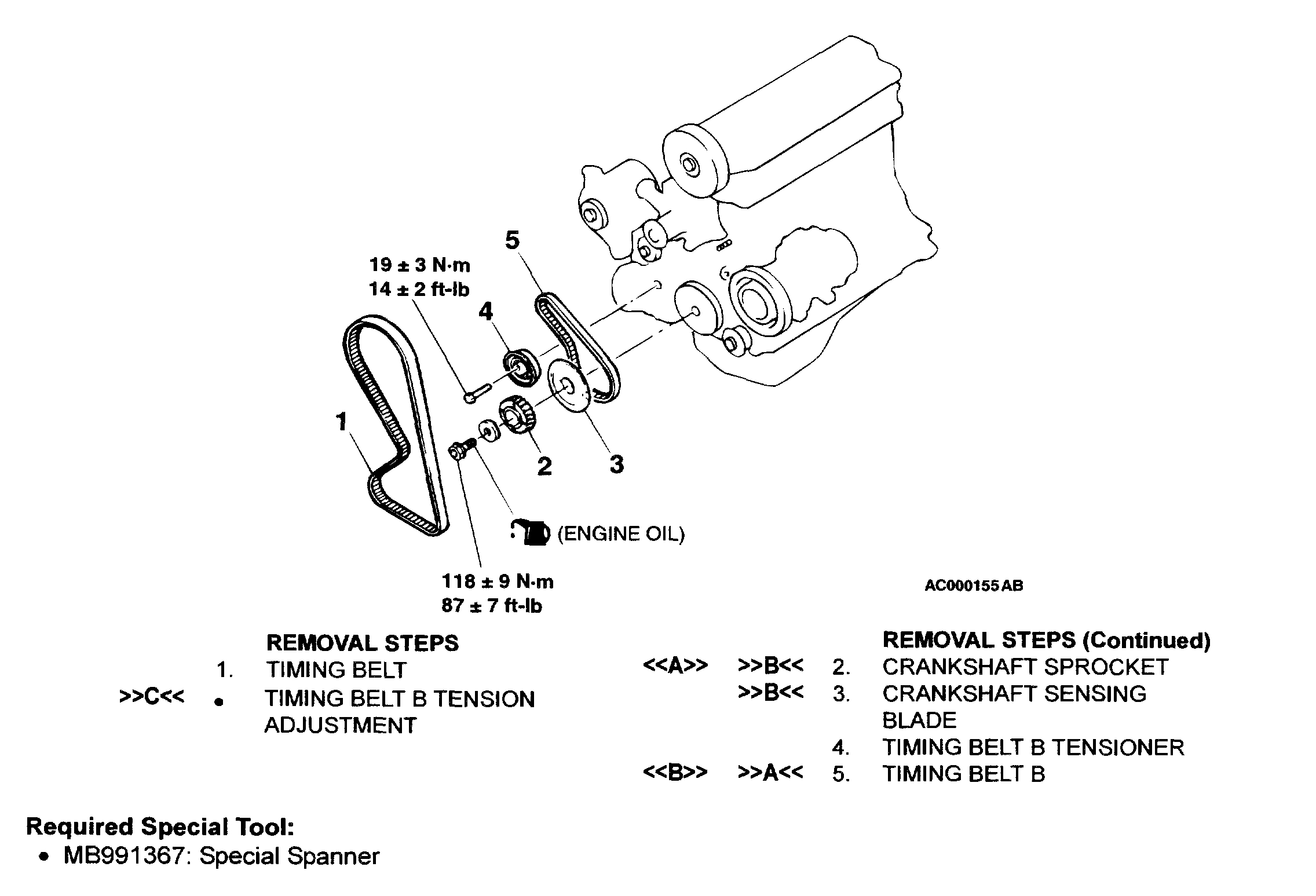

TIMING BELT B (SILENT SHAFT BELT)
pic 14

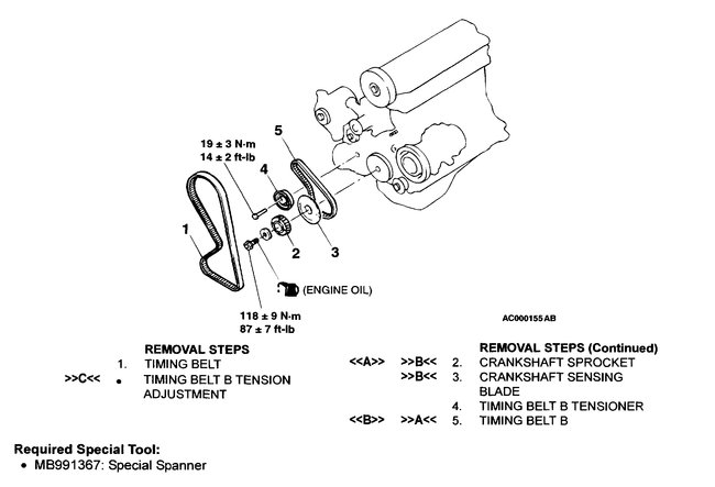

REMOVAL SERVICE POINTS

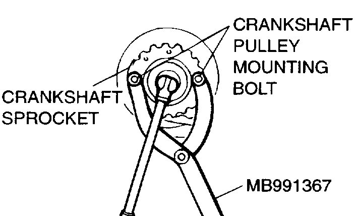

[[A]] CRANKSHAFT SPROCKET REMOVAL
pic 15

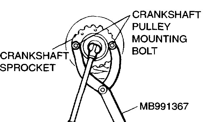

1. Use the crankshaft pulley mounting bolt to hold special tool MB991367.
2. Loosen the crankshaft sprocket mounting bolt, and remove the sprocket.
[[B]] TIMING BELT B REMOVAL

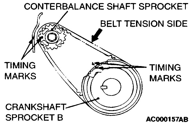

1. Ensure that crankshaft sprocket B timing marks and the counterbalance shaft sprocket timing marks are aligned.
2. Fit timing belt B over crankshaft sprocket B and the counterbalance shaft sprocket. Ensure that there is no slack in the belt.

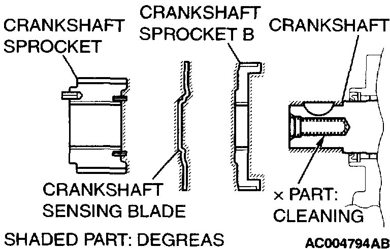

pic 18
1. To prevent the crankshaft bolt from loosening, degrease or clean the seating surfaces of the crankshaft, crankshaft sprocket B. crankshaft sensing blade and crankshaft at the shown positions.
2. Install the crankshaft sensing blade so that they face as shown in the illustration.
3. Apply the minimum amount of engine oil to the seat surface and thread of the crankshaft bolt.

4. Use the crankshaft pulley mounting bolt to secure special tool MB991367.
5. Tighten the crankshaft sprocket bolt to the specified torque.
Tightening torque: 118 ± 9 Nm (87 ± 7 ft. lbs.)

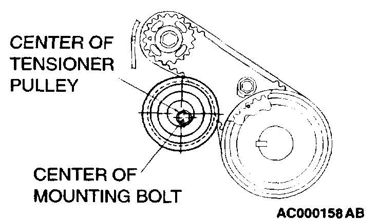

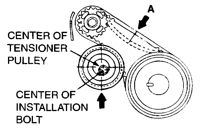

1. Temporarily fix the timing belt B tensioner so the center of the tensioner pulley is to the left and above the center of the mounting bolt. Temporarily attach the tensioner pulley so the flange is toward the front of the engine.
CAUTION: When tightening the bolt, ensure that the tensioner pulley shaft does not rotate with the bolt. Allowing it to rotate with the bolt can cause excessive tension of the bolt.

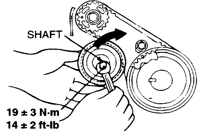

pic 21
2. Holding the timing belt B tensioner up with your finger in the direction of the arrow, apply pressure on the timing belt so the tension side of the belt is taut. Now tighten the bolt to fix the tensioner.
Tightening torque: 19 ± 3 Nm (14 ± 2 ft. lbs.)

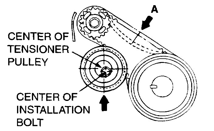

pic 22
3. To ensure that the tension is correct, depress the belt (point A) with a finger. Adjust the belt tension if it is incorrect.
Standard value: 5 - 7 mm (0.2 - 0.3 inch)

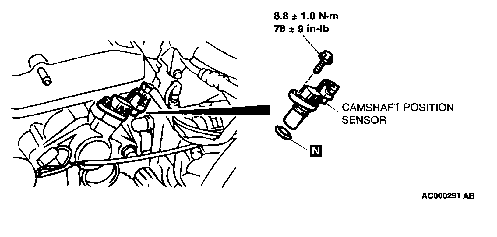

Thanks Joe. I just pulled the codes. I have a P0340 (Cam Sensor) and a P0340 (Crank Sensor). Do you think it could be the Cam sensor? That would be a lot easier to replace I think.
Thursday, August 22nd, 2019 AT 4:20 AM
  • 110,055 POSTS
Welcome back:
That code is specific to the cam sensor, so yes, that is where I would start. You listed the same code above for both crank and cam sensor. Was there a different code for the crank?
Make sure the wiring to the sensor isn't wet. Also, have you checked to see if there is spark to the plugs?
The pic below shows the cam sensor being replaced.
+1
Thursday, August 22nd, 2019 AT 9:24 PM
RAMAYO53
Joe,
The codes were P0340 and P0335. I think I found the problem. I pulled the connector off the Cam sensor and there was crud in the Cam sensor around the terminals which looked like copper colored bits from the radiator sealant I had put in months ago. I flushed it out and let it dry. Took the car out on a couple of 30 minute rides and it has not stalled again. Thanks for your help! Wouldn't be the first time I caused a problem. Another lesson learned. Bob
