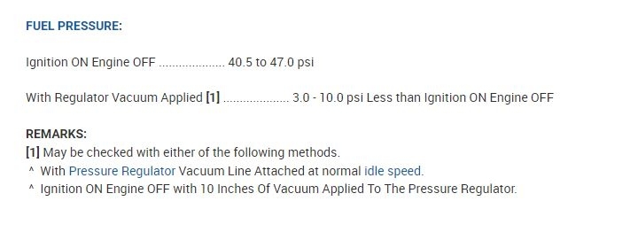

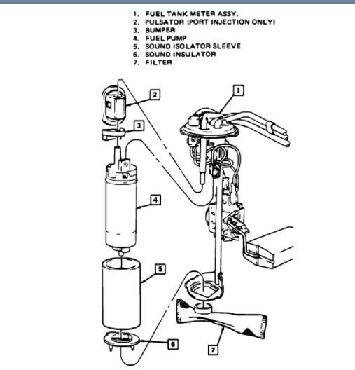

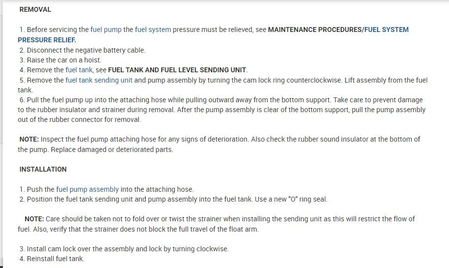

  • 52,797 POSTS
There is not enough pressure to properly supply fuel to the engine.
https://www.2carpros.com/articles/how-to-replace-an-electric-fuel-pump
I attached the spec plus the procedure for replacing the pump.
Let us know if you have any other questions.
Saturday, September 18th, 2021 AT 6:54 AM

  • 52,797 POSTS
Key on, engine off it should be 40-45 pounds.
Do you have that?
Saturday, September 18th, 2021 AT 11:13 AM
MARTYNAS JAKšYS
  • 5 POSTS
Yes it is nearly 40, the problem with my car was bad ECM, I changed it, now it runs without stalls or RPM drops.
Saturday, September 18th, 2021 AT 1:15 PM
