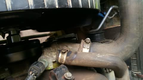

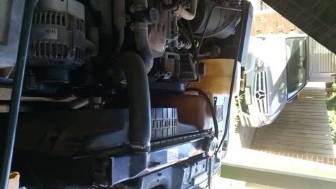

I've attached the video. One other thing, in the description I said the noise stopped when the temperature reached 70 F. I should have said 70 Centigrade which is about 158 F.

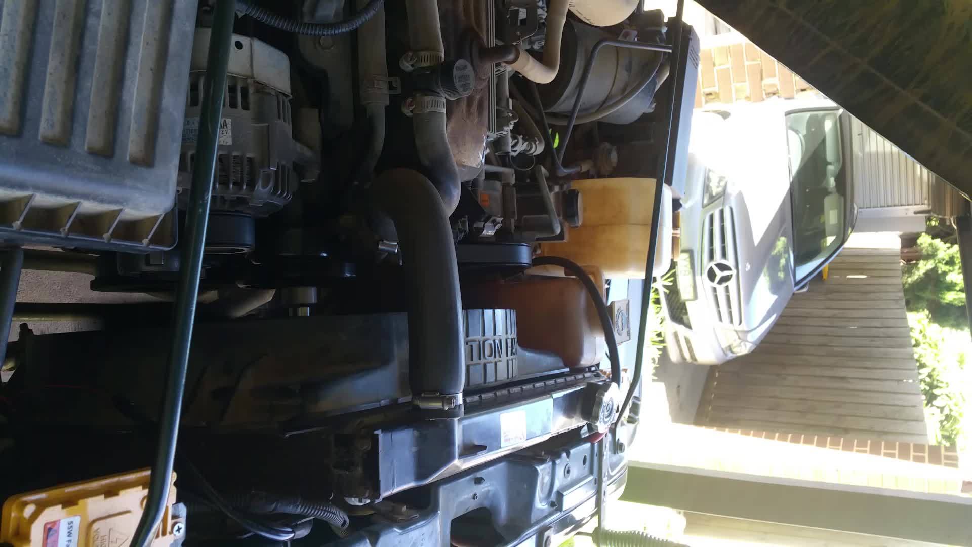

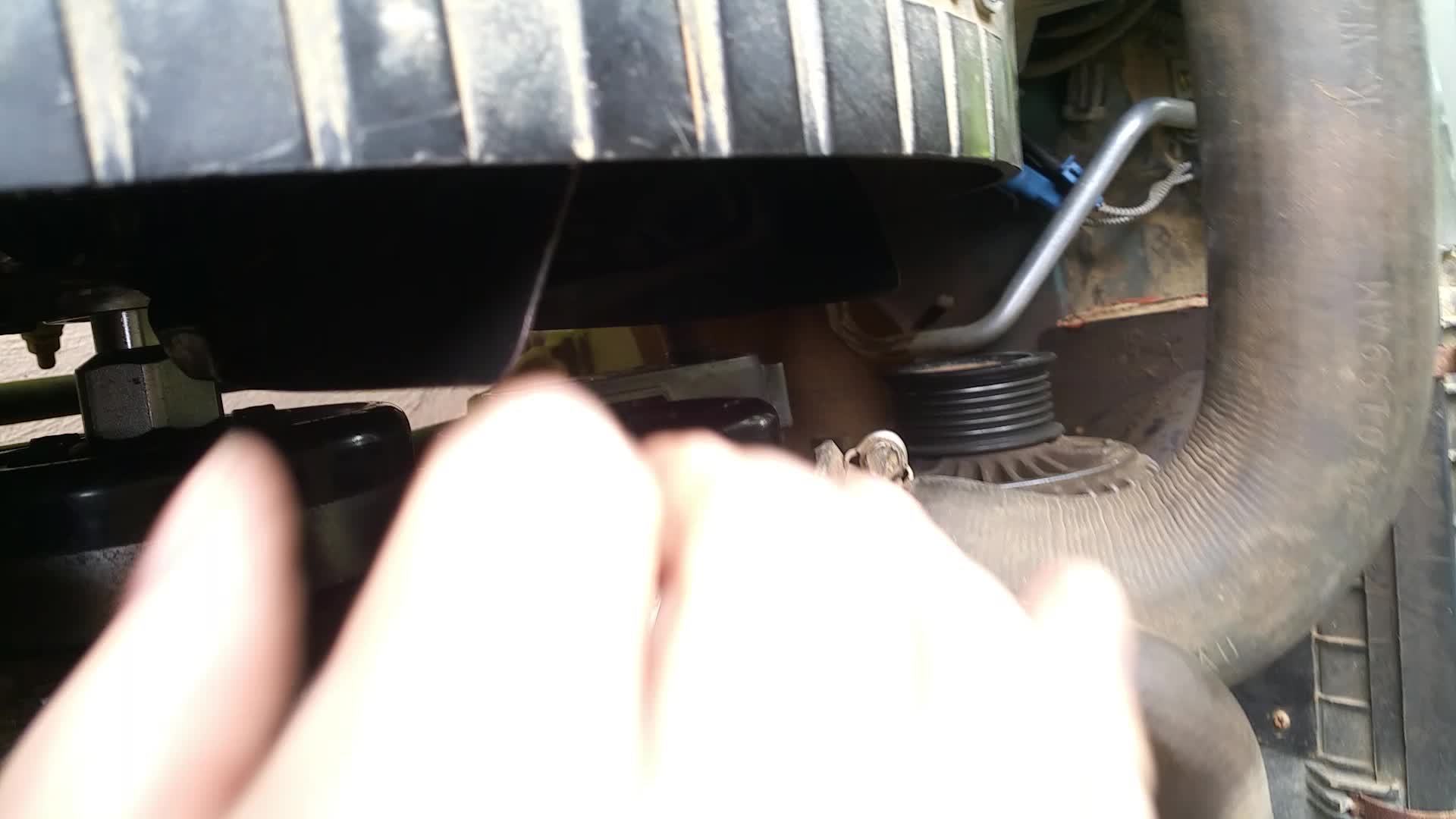

Okay, I would remove the serpentine belt and spin all the components by hand and look for any play or stiffness. See if you can recreate the noise by spinning the pulleys.

JOHN DAVIES
Hi Roy,
There is a very faint whining noise like a kittens meow coming from the water pump pulley when its spun. I've included a video. Looks like the next thing I should try is replacing the water pump.
John
Jan 12, 2021 at 10:12 PM

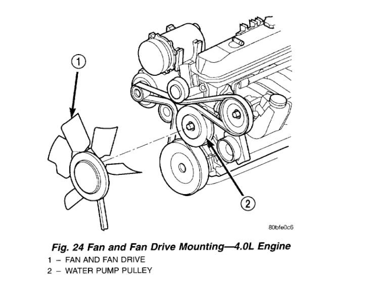

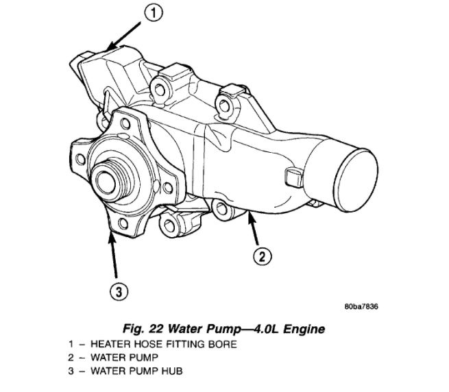

Good find. That noise when the belt is installed can be much louder.
Replace the pump.

CAUTION: If the water pump is replaced because of mechanical damage, the fan blades and viscous fan drive should also be inspected. These components could have been damaged due to excessive vibration.

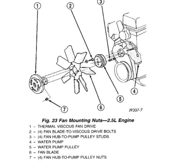

3. 2.5L Engine: Loosen (but do not remove at this time) the four fan hub-to-water pump pulley mounting nuts.
NOTE: The engine accessory drive belt must be removed prior to removing the fan.
4. Remove accessory drive belt.
5. 4.0L Engine: The thermal viscous fan drive/fan blade assembly is attached (threaded) to water pump hub shaft. Remove fan blade/viscous fan drive assembly from water pump by turning mounting nut counterclockwise as viewed from front. Threads on viscous fan drive are RIGHT HAND. Using a suitable fan wrench loosen the fan drive.

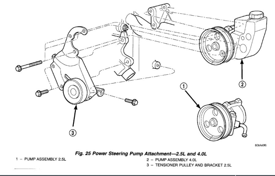

6. Remove power steering pump.

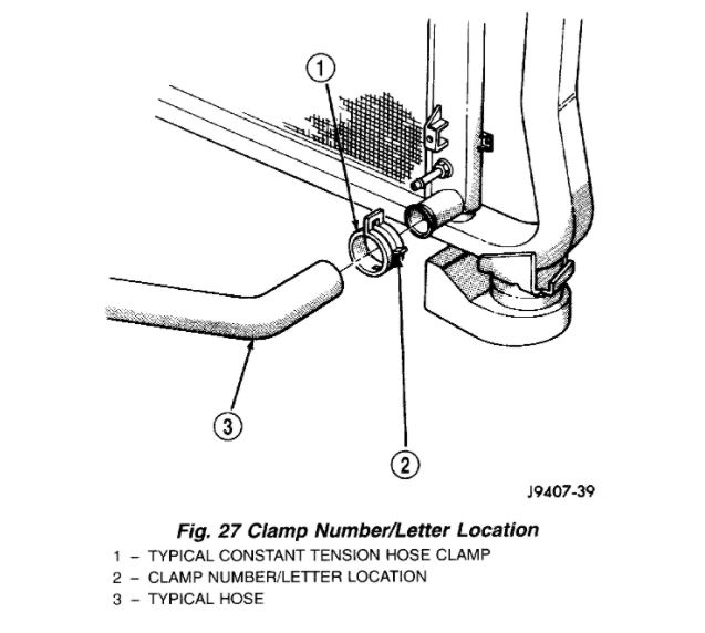

Warning: constant tension hose clamps are used on most cooling system hoses. When removing or installing, use only tools designed for servicing this type of clamp, such as special clamp tool (number 6094) Snap-On clamp tool (number hpc-20) may be used for larger clamps. Always wear safety glasses when servicing constant tension clamps.
CAUTION: A number or letter is stamped into the tongue of constant tension clamps. If replacement is necessary, use only an original equipment clamp with matching number or letter.

8. 2.5L Engine: Remove four nuts previously loosened and remove the fan blade assembly and pulley.

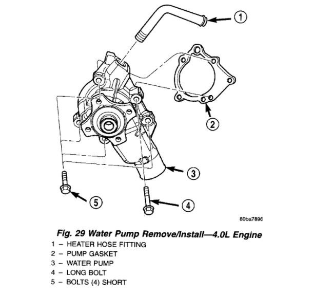

10. Remove the four pump mounting bolts and remove pump from vehicle. Discard old gasket. Note that one of the four bolts is longer than the other bolts.
11. If pump is to be replaced, the heater hose fitting must be removed. Note position of fitting before removal.

1. If pump is being replaced, install the heater hose fitting to the pump. Use a sealant on the fitting such as Mopar Thread Sealant With Teflon. Refer to the directions on the package.
2. Clean the gasket mating surfaces. If the original pump is used, remove any deposits or other foreign material. Inspect the cylinder block and water pump mating surfaces for erosion or damage from cavitation.
3. Install the gasket and water pump. The silicone bead on the gasket should be facing the water pump. Also, the gasket is installed dry. Tighten mounting bolts to 23 Nm (200 inch lbs.) torque. Rotate the shaft by hand to be sure it turns freely.

5. 2.5L Engine: Position water pump pulley to water pump hub.
6. 2.5L Engine: Install fan and four nuts to water pump hub. Tighten or nuts to 27 Nm (20 ft. lbs.) torque.

8. 4.0L Engine: Thread the fan and fan hub into the water pump hub shaft.
