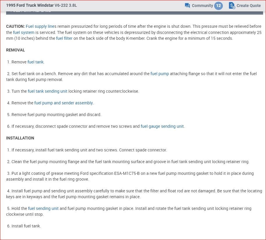

Idle is good, but when I accelerate, especially going up hills, the engine coughs and sputters and won't even go the speed limit. I changed the spark plugs, oil, fuel filter, air filter, and used fuel injector cleaner. Idle is perfect; acceleration still bad.
Wednesday, June 12th, 2019 AT 12:41 PM
Hi Max,
Sounds like this is a weak fuel pump. Let's start with getting fuel pressure readings when the vehicle is acting up.
Once you get the fuel pressure, I suspect we will find it is not the proper PSI.
Please let me know what you find. Just in case, I included the procedure on how to replace the pump.
https://www.2carpros.com/articles/how-to-replace-an-electric-fuel-pump
