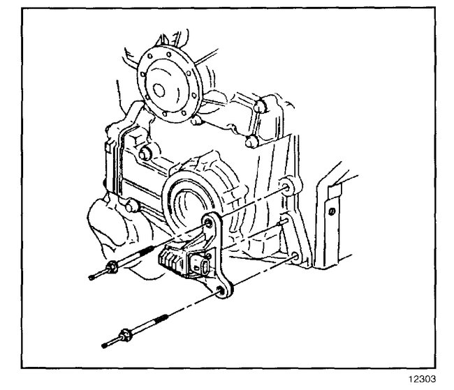

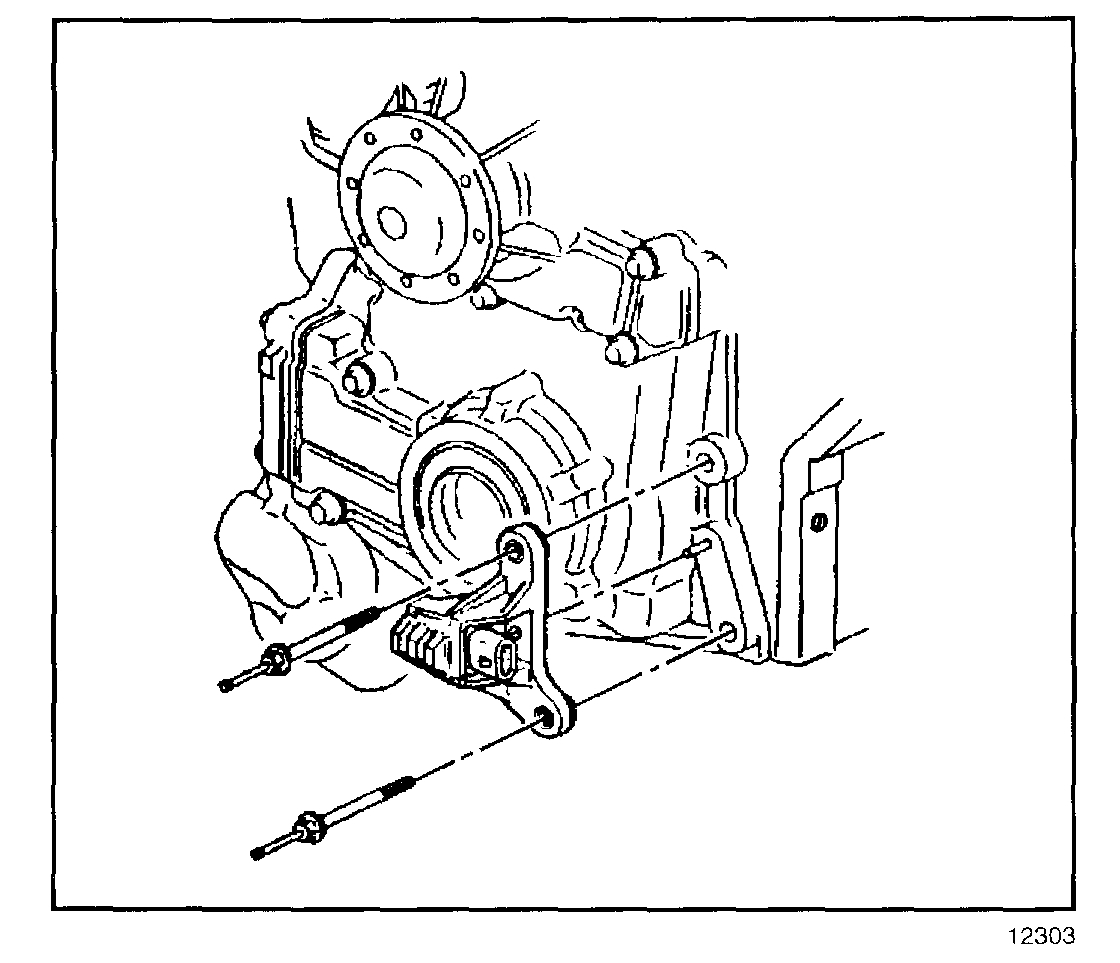

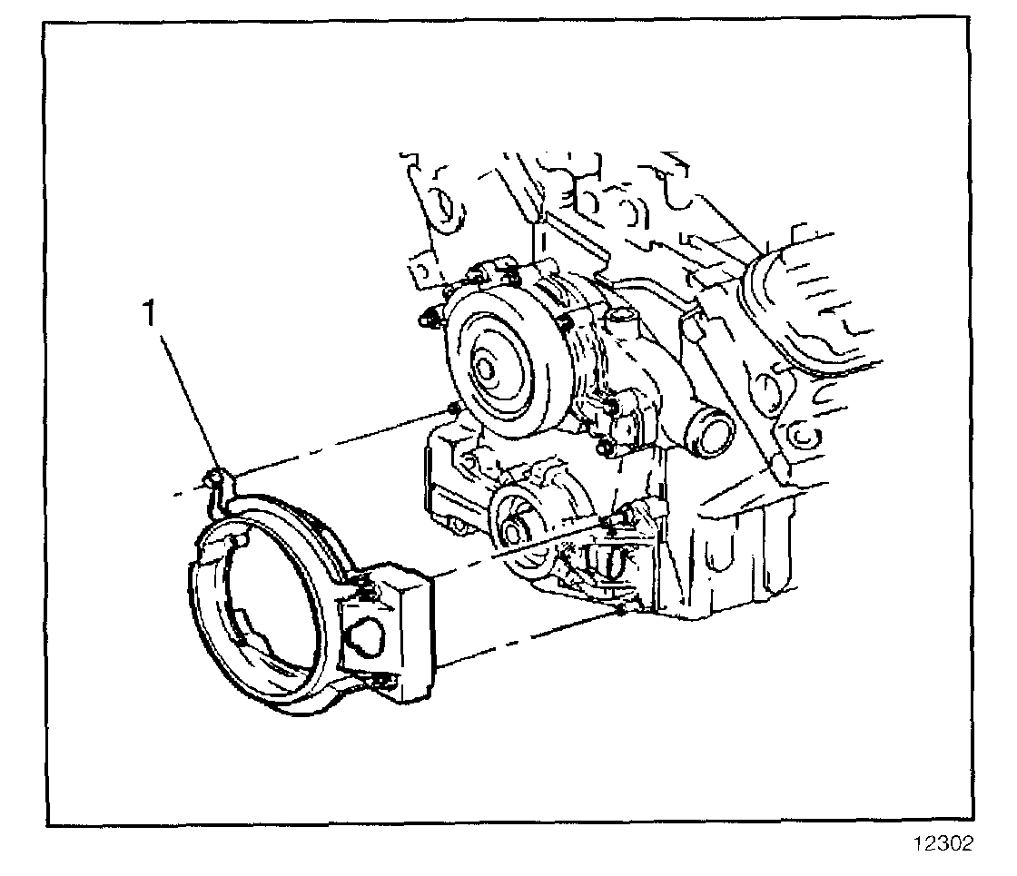

Here are directions specific to your vehicle. The attached pics correlate with the directions.

pic 1
1. Disconnect the negative battery cable.
2. Raise the vehicle on a hoist. Refer to Lifting and Jacking the Vehicle.
3. Remove the right inner fender access cover.
4. Remove the crankshaft harmonic balancer. Refer to Crankshaft Balancer Replacement in Engine-3.8L.
5. Remove the crankshaft position sensor (CKP) shield (1). Do Not use a pry bar.
6. Disconnect the sensor electrical connector.
pic 2
7. Remove 2 attaching bolts from the CKP sensor.
8. Remove the CKP sensor from block face.

pic 3
1. Position the CKP sensor to the block.
NOTE: Refer to Fastener Notice in Service Precautions.
2. Install the bolts that hold the CKP sensor to the block face.
Tighten
Tighten the bolts to 30 N.m (22 lb ft).
pic 4
3. Install the CKP sensor shield (1).
4. Connect the CKP sensor electrical connector.
