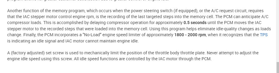

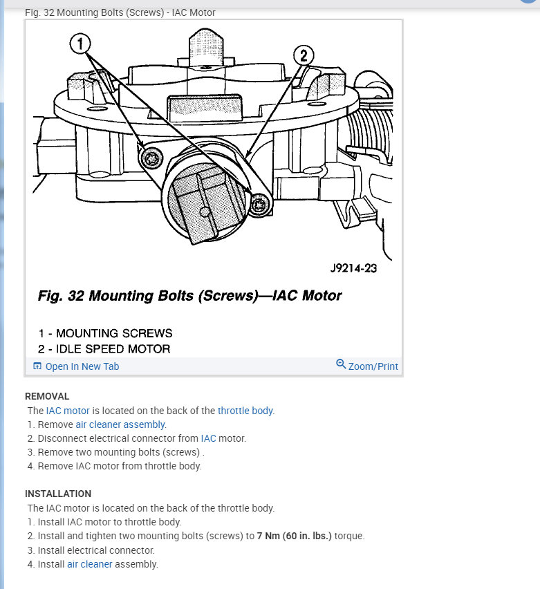

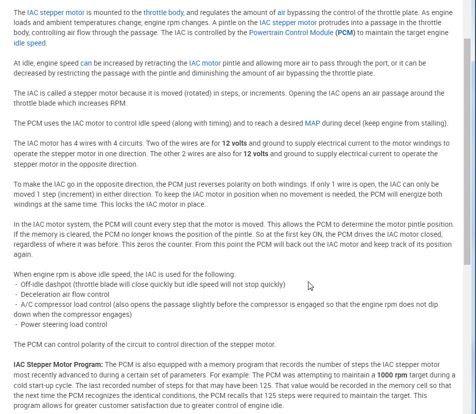

Due to the fact that this stalls when your foot is removed from the accelerator is pointing to the idle control. On your truck you have a motor on the side of the throttle body that controls the idle. If this is faulty then it will cause what you are seeing. Normally it doesn't wait until the engine is hot but clearly your PCM is seeing something after it is hot that it does not like at idle and it is causing the engine to stall out unless you keep the throttle open.
I would start with this and go from there. Thanks

Changed idle air today. Drove truck and still shuts off when the engine warms to 210.

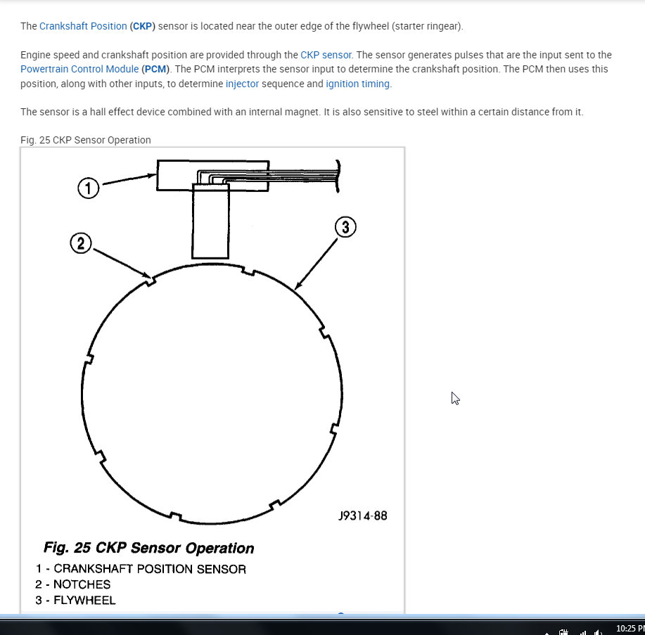

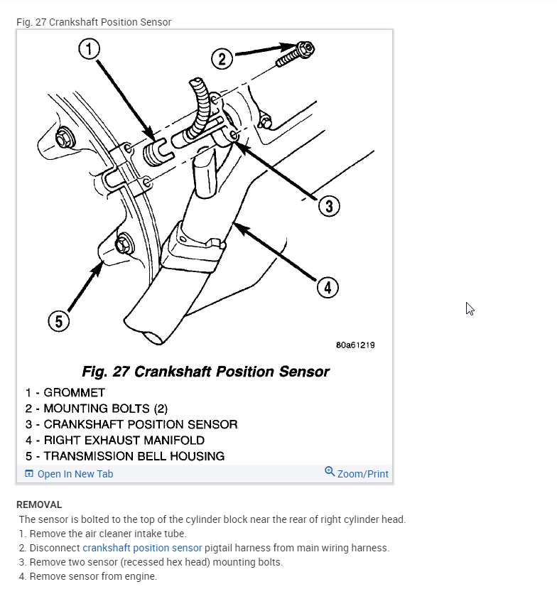

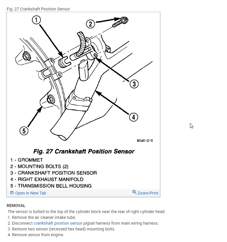

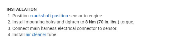

This could be a crank sensor issue. It doesn't fit because if a crank sensor fails, you would not be able to keep it alive by holding the accelerator. Nor does it normally fire right back up.

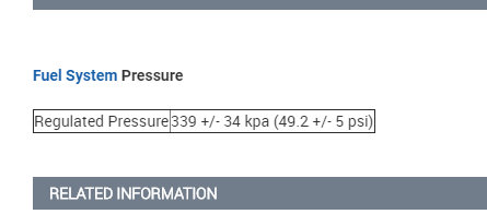

I would suggest the next thing we do is monitor fuel pressure and make sure that is correct. Just because the pump was replaced doesn't mean the pressure is correct. So I would start there and then we can move on because after that we need to suspect the PCM itself.
