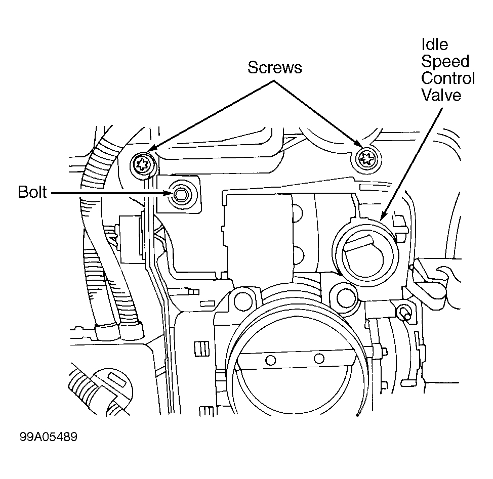

Based on your description, it sounds like the engine idle speed may be too low. If you noticed this more when using the air conditioning, suspect a bad or dirty idle air control valve (IAC). This component is designed to allow a metered amount of air into the engine when at idle. Additionally, when the air conditioning or other load is placed on the engine at an idle, the IAC should allow additional air to enter to increase idle speed.
The IAC is located on the throttle body of the vehicle. I know this vehicle is a 4 gen 7 series, but I am not able to find the exact model in my manual. However, I have attached a picture or a 745i IAC to help you locate it. Also, you can read through this link which discusses rough idle and idle misfire.

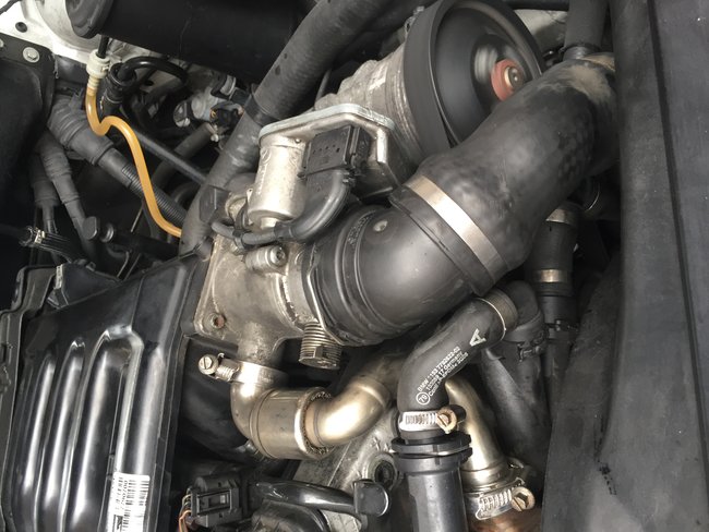

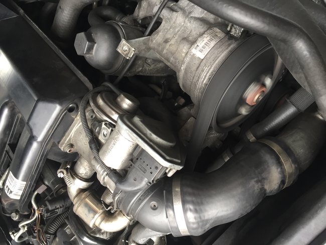

Hi Joe. Thank you very much for your reply. Unfortunately I am just reading it now as I received no notification in my inbox that I got a reply. However, I am not able to locate the IAC. I have included pictures of my throttle body. Please let me know if you can see it. As for the vacuum leak, there are no fault codes showing even when a computer is plugged in to see. The only code I ever remember seeing was 4BD2 ARS Torque request and no mechanic seems to know what that means. I still have the problem and no one has been able to fix it so far. I really look forward to your reply.

Okay this is a Euro car and does not have an ALDL connector like US based cars do. Also, this car does not have an IAC motor. Lets try doing a compression test to see if you have a low cylinder.

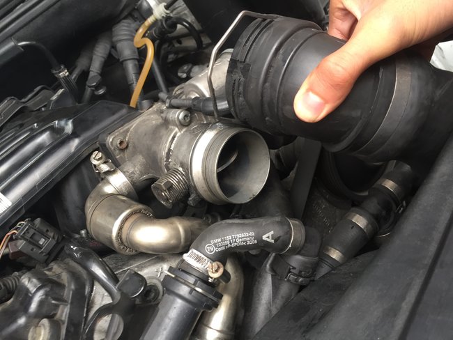

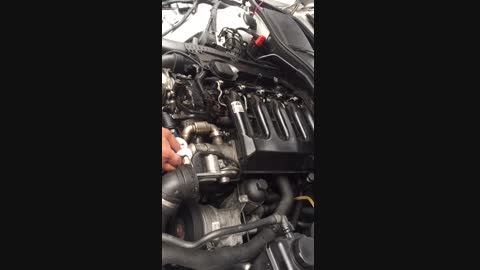

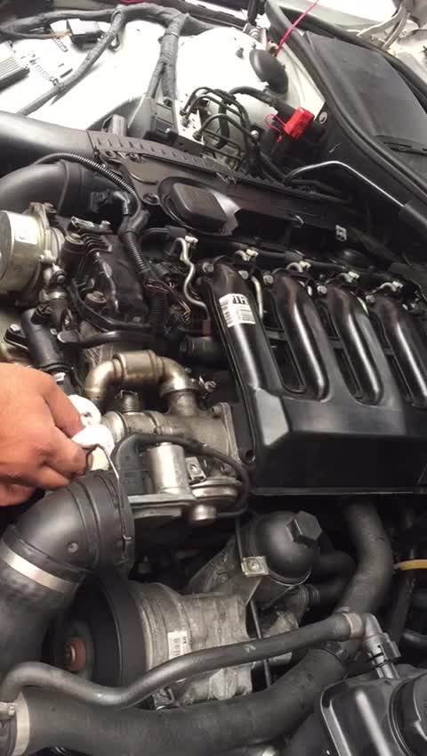

Hello, thanks for your reply. The BMW mechanic did a compression test and all was fine. They checked the throttle body, injectors and connection lines. He was advising me to change high fuel pressure regulator but he said there was no guarantee this was the issue. Please see the video for a little test I tried. After inserting a cloth into the throttle body, the car stops shaking. I am not sure if that means anything?

Thanks for the video really helps. It definitely is a mixture issue. This car is a diesel? Have you changed out the fuel filter lately?

Mixture meaning too much air not enough fuel that is why it run better when you remove the air. It is like it has a leak in one of the turbo intake tubes or a leak in one of the pressure tubes. Can you look using a flashing light to see if you can see anything? You might need to find a smoke machine and use that to find the leak.
