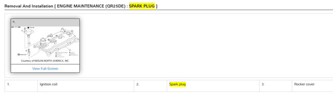

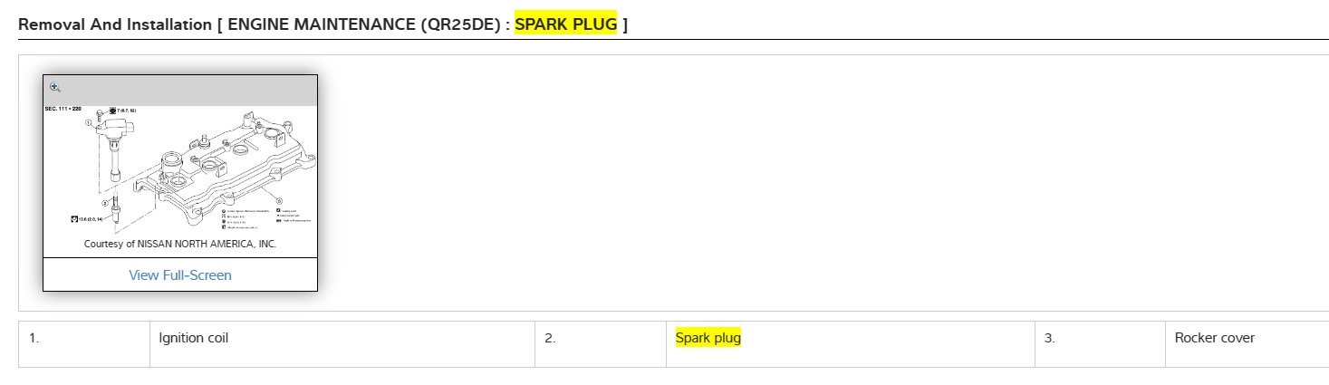

I am adding this procedure for you removing and replacing the plugs. I would start with cylinder 2. It is the second one in from the front of the engine, where the belt is.
Just take out one and if you could send a picture of it to me that would be awesome. I want to see if there are any obvious signs of an issue or if there might be something else going on.

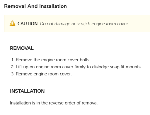

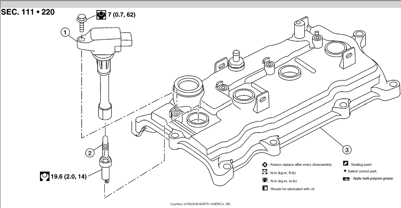

1) There is a cover on top of the engine you will need to remove to access the plugs. It is held on by 3 10mm bolts and then you have to pull straight up and pop it off a rubber bushing.
2) Once that is removed, you will see 4 coils. This is called coil-on-plug, so there will be no wires. The Ignition coil attaches directly to plug.
3) The coil is held down with a 10mm bolt. First remove the connector to the coil and then remove the bolt holding it down.
4) You should be able to remove the coil now. Go nice and easy so you don't damage the boot.

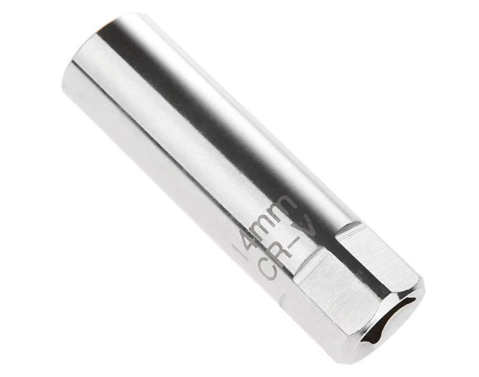

5) The plug is a 14mm spark plug socket. I will add a picture for you. You should be able to grab one at the local auto parts store.
You will need an extension to get down to the plug also.

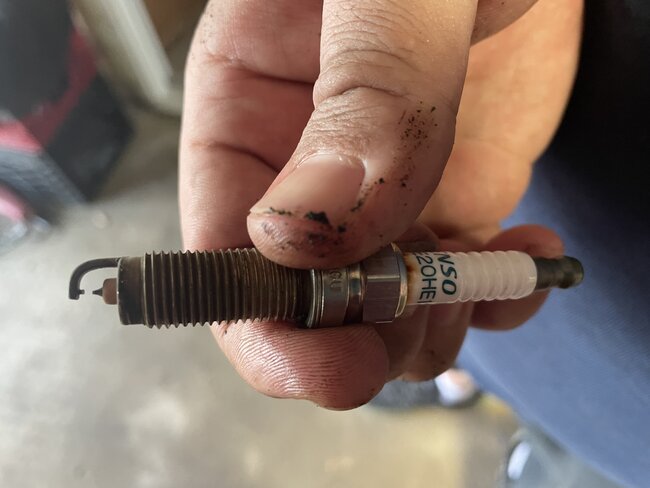

Good morning! Sorry for the delay. Took it apart last night and this is what we found. Guessing these should be replaced.
Let me know what you think.

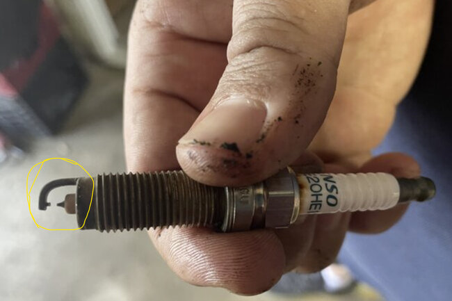

Yes, to me that looks like something called Gap Bridging. It is from deposits in the combustion chamber. Sometimes the issue is a lot of stop and go driving or poor fuel. This will cause a misfire as well as poor performance and increased gas consumption.
Other than that, the plug looks pretty good.
Since you are close to 100k miles on the vehicle and Nissan recommends you change the plugs every 100k, I would just put 4 new pugs in it now.
Nissan won't stock this exact plug most of the time because they are expensive and nobody buys them, this plug was installed in the factory. Instead, they will usually stock Nissan Value Advantage which is Nissan's Value line. They are Nissan parts made by a 3rd party that Nissan oversees.
Here is the part number for your engine: B2401-JA01J-NW
They are the same plug and will work fine in your vehicle.

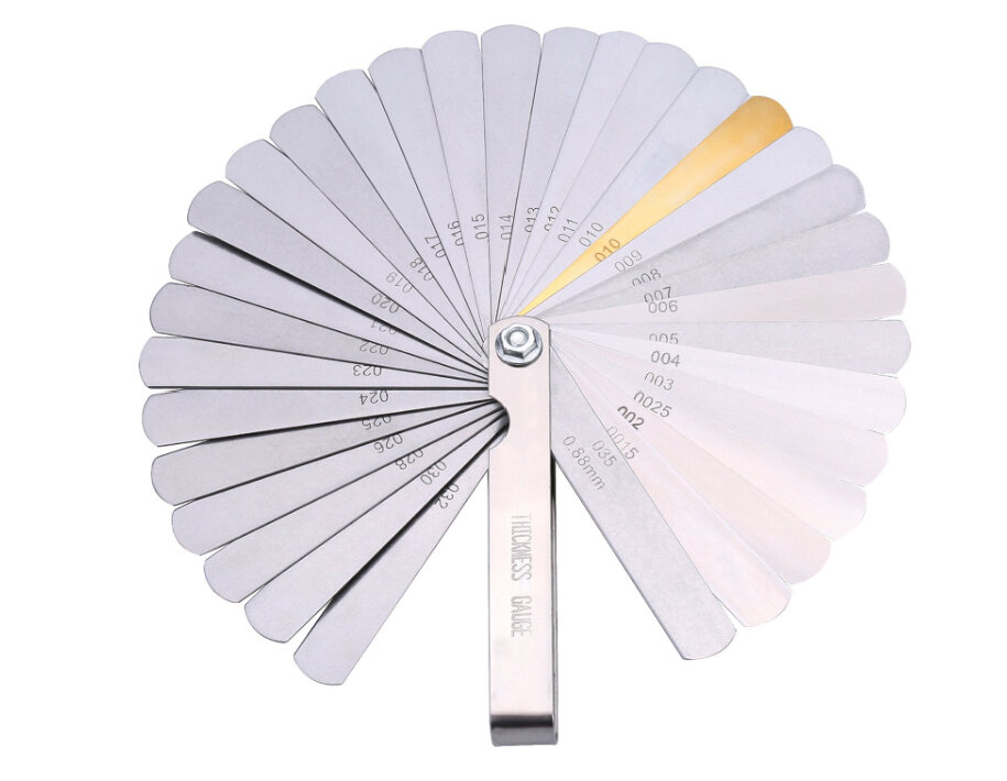

**Note-This is a platinum plug and does not need to be gapped. They come pre-gapped from the factory. However, it is always a good idea to just check the gap because they can be damaged in shipping. You can check the with a tool called a Feeler Gauge. I will add a picture of one for you.
The gap should be: 0.043 in.

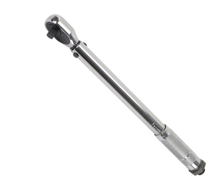

Also, these need to be torqued to 14 ft. lbs. according to Nissan.
If you don't have a torque wrench, I found one from Harbour Freight that is very affordable. It is very easy to overtighten these and damage the threads in the head, so I recommend using a torque wrench. This way you won't have to worry whether they are too tight or not tight enough.
Here is the link for the torque wrench:
https://www.harborfreight.com/38-in-drive-5-80-ft-lb-click-torque-wrench-63880.html?utm_source=bing&utm_medium=cpc&utm_campaign=425671840&campaignid=425671840&utm_content=1165483352460138&adsetid=1165483352460138&product=63880&store=639&msclkid=38e0f689d9d61c2aac2f92f2bb911a57

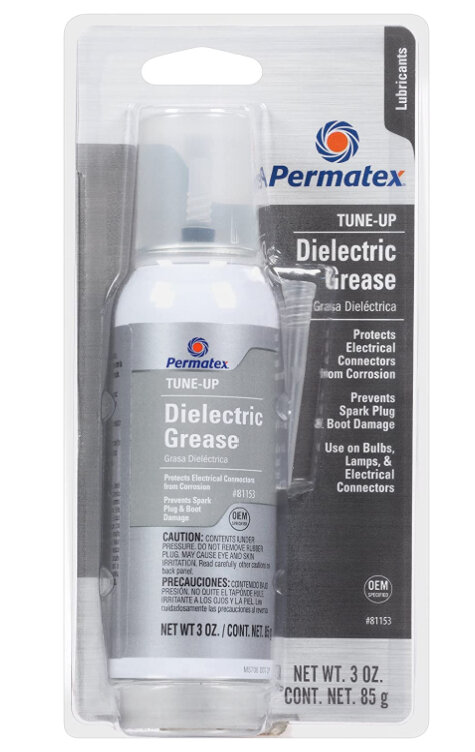

Once the plugs are installed put some Di-electric grease inside the end of the coil boot before pushing it down into place. I will add a picture of the one I use. It can be found right at the auto parts store. This will aid in installation and prevent damage to the boot. It will also protect it from corroding and something called carbon tracking.
