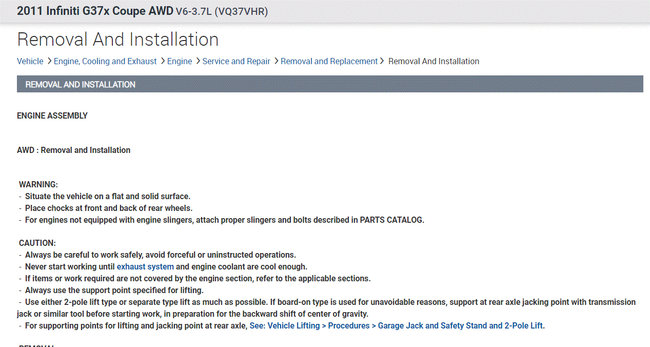

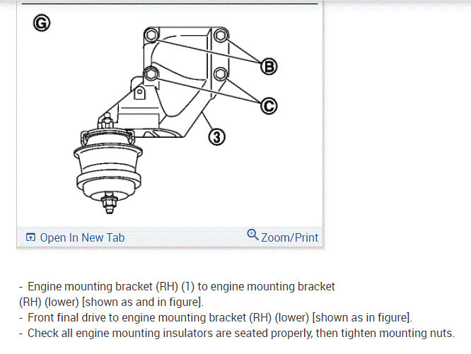

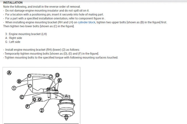

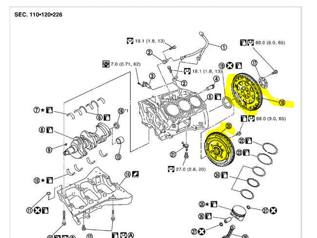

Also. if you look at pic 1 below, I highlighted numbers 18 and 20 coming off the same engine. Number 18 is a flex plate for an automatic transmission and number 20 is a flywheel for a manual transmission. Therefore, the engine is the same regardless of the transmission type. You will just need to switch a few of the parts to make it compatible with your vehicle.

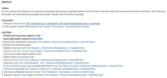

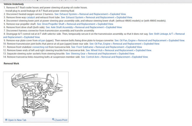

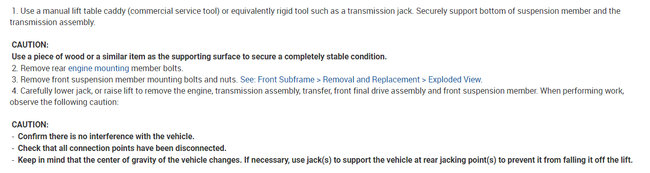

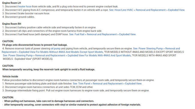

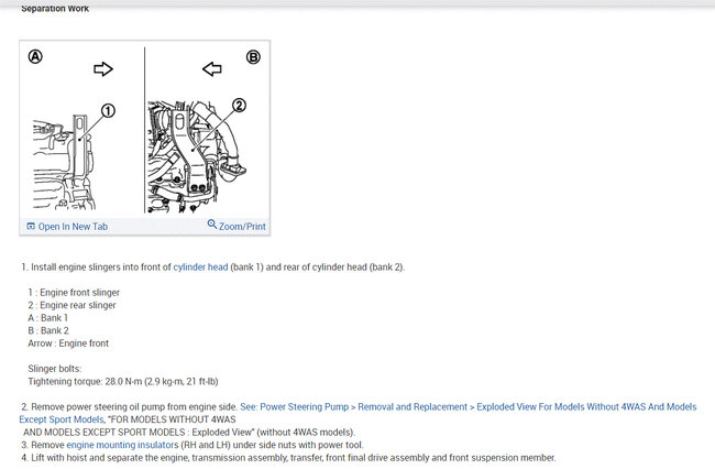

Interestingly, I reviewed the directions for the removal of the engine. The only way it's listed is with an AT. I added the directions in the event you wanted to do it yourself.

As far as the switch from AT to MT, it's not a big deal. You will just switch the flex plate for the flywheel. I wonder if the bearing whine you heard was the water pump. That's a possibility.

Based on my findings, the engine was used by Nissan in multiple chassis and models/trims. The only ones that varied, slightly, were in the X (AWD) and the Nismo (performance) options, so I believe you are correct in only needing to swap the flex plate for the flywheel. Speaking of the X (AWD), I just noticed the instructions you added in your first reply are for a G37X, those only came with an AT, probably why you didn't see removal instructions for a MT.
