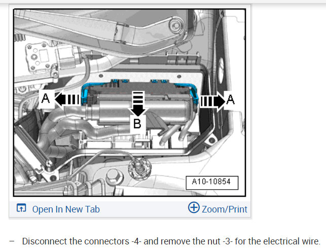

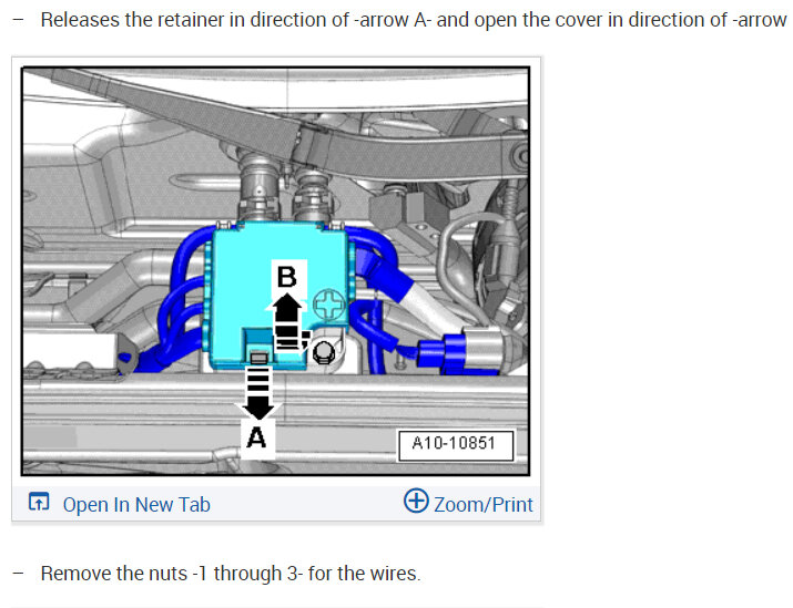

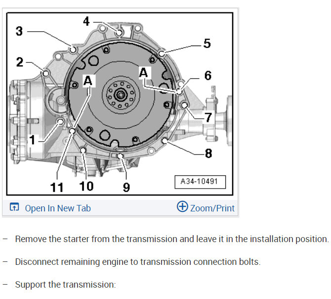

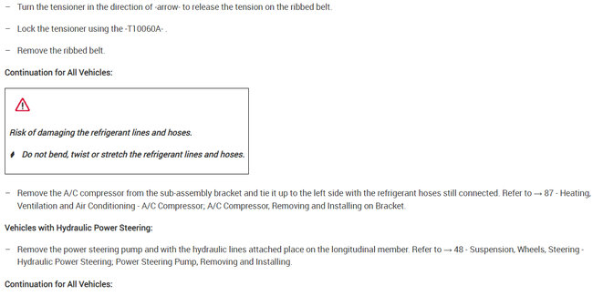

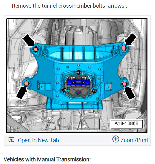

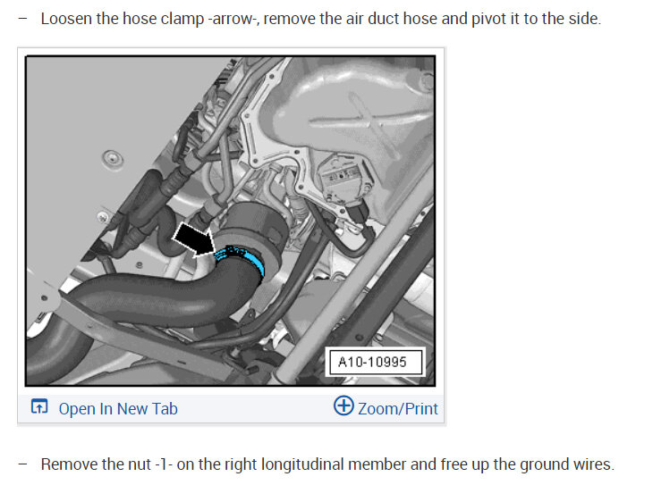

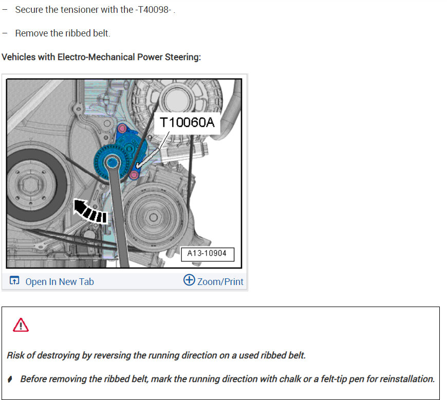

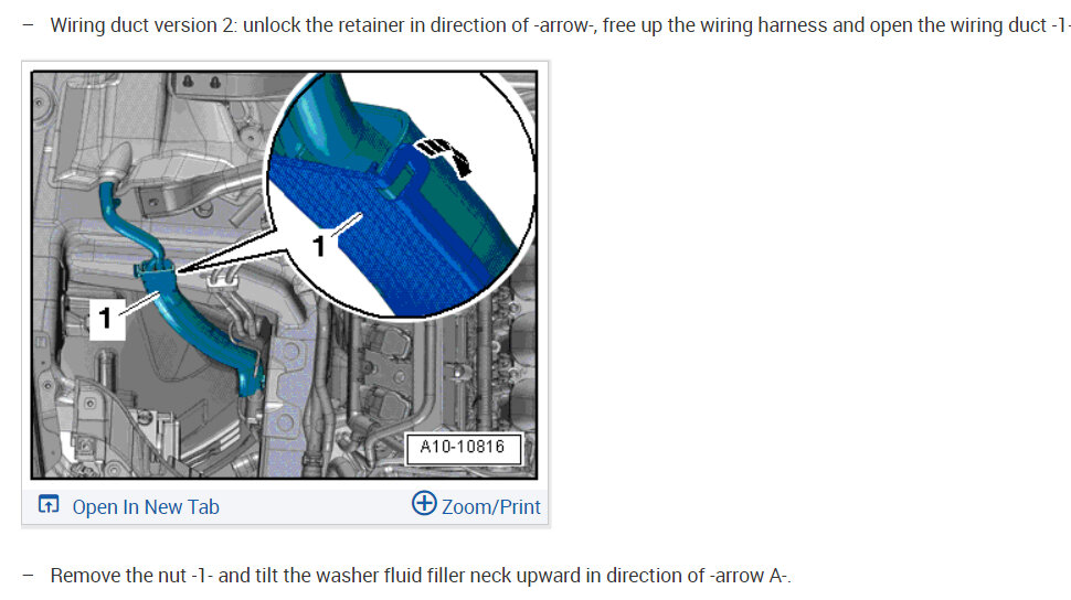

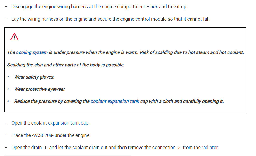

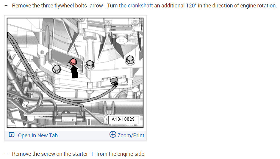

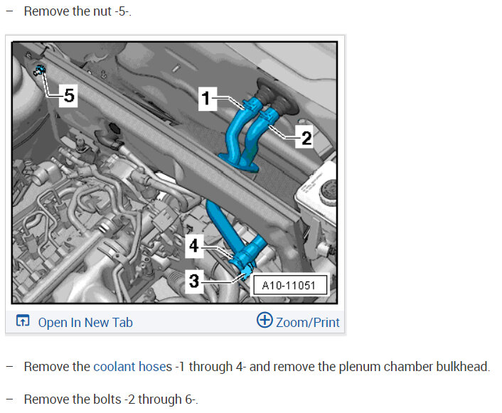

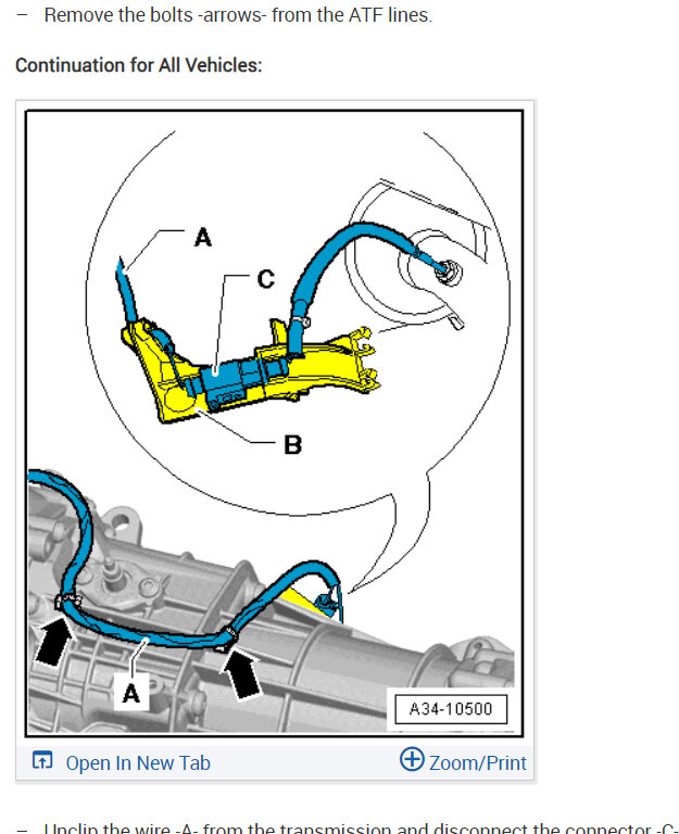

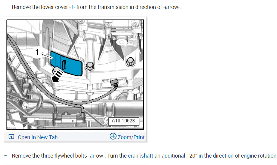

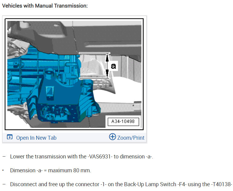

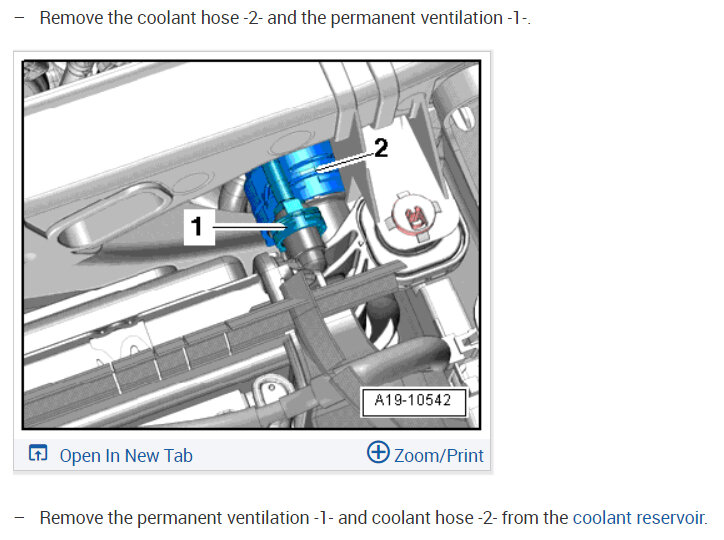

I have an engine replacement coming up soon on the vehicle listed above 3.2 and I've been searching forums and trying to figure out the most efficient/faster way to replace the engine i looked at the manual and it said out the bottom and i also saw remove the front bumper has anyone done this before?
Apr 24, 2023 at 4:30 AM
  • 55,433 POSTS

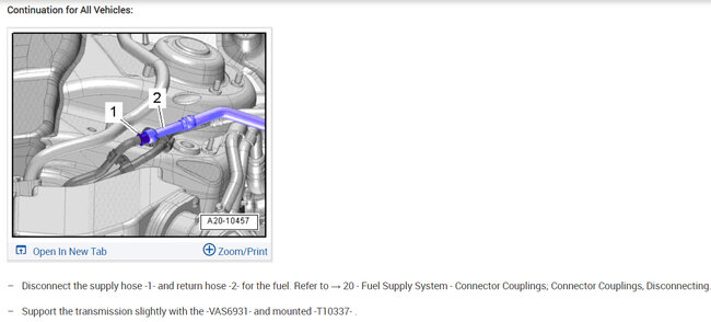

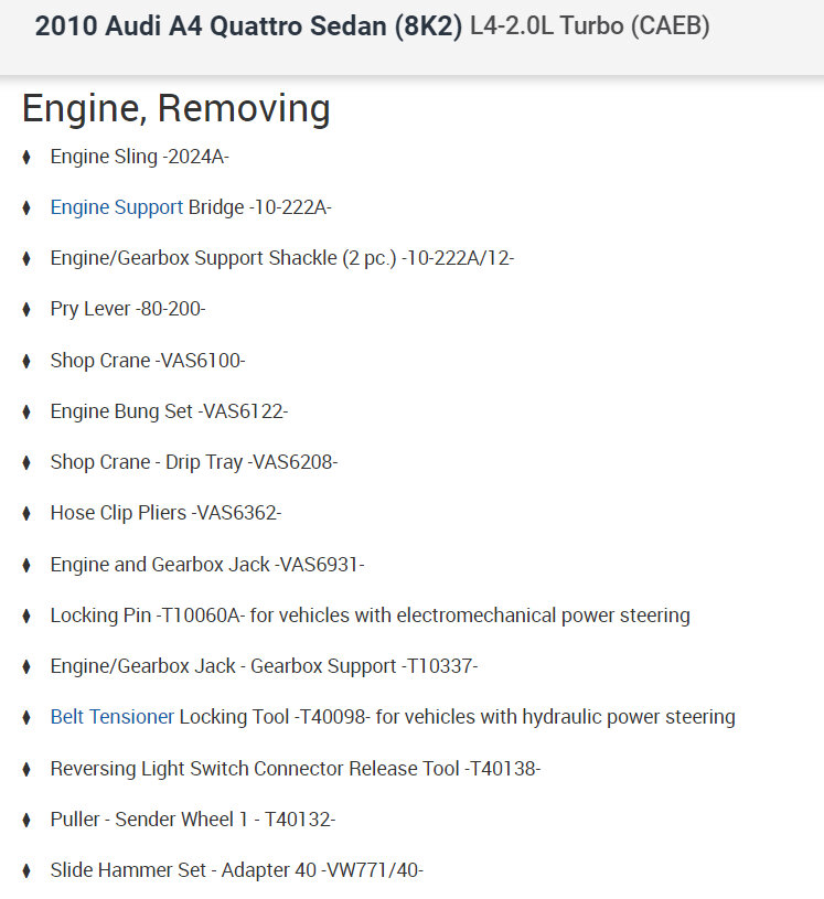

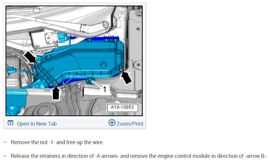

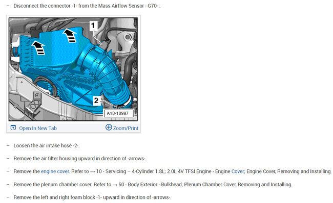

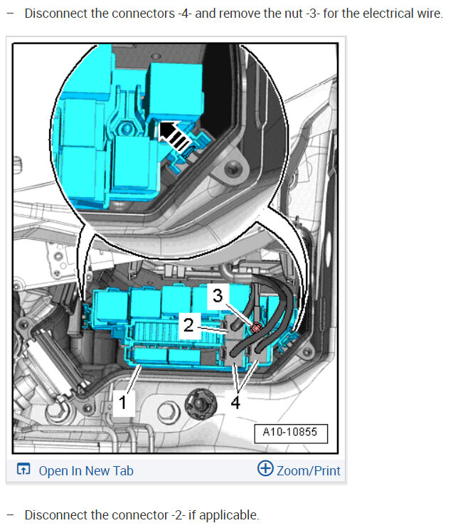

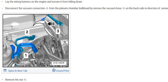

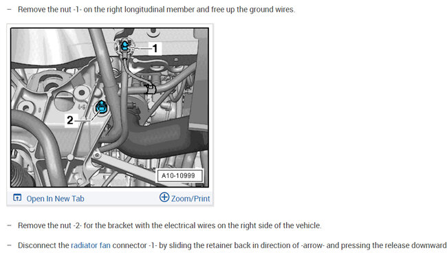

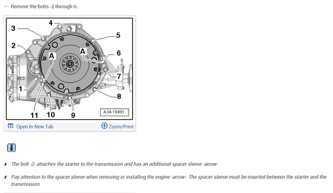

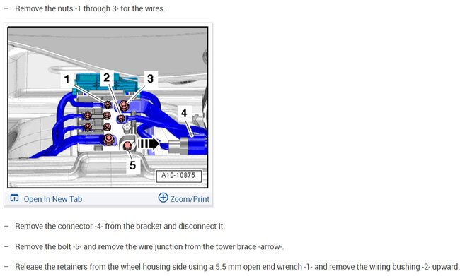

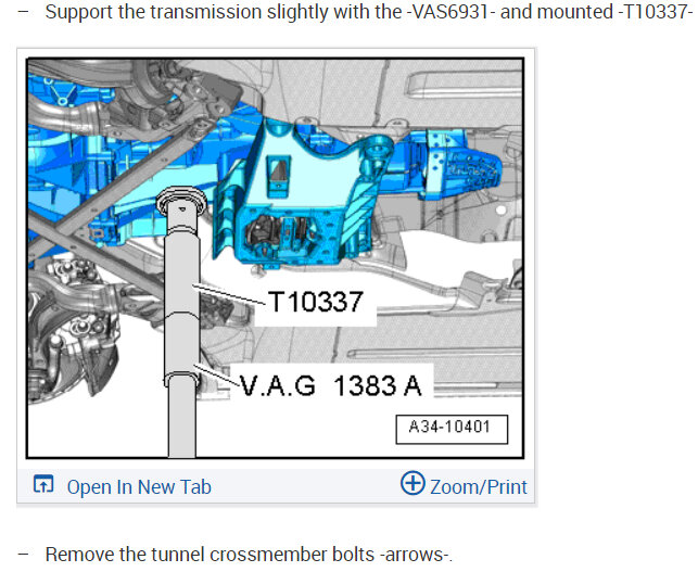

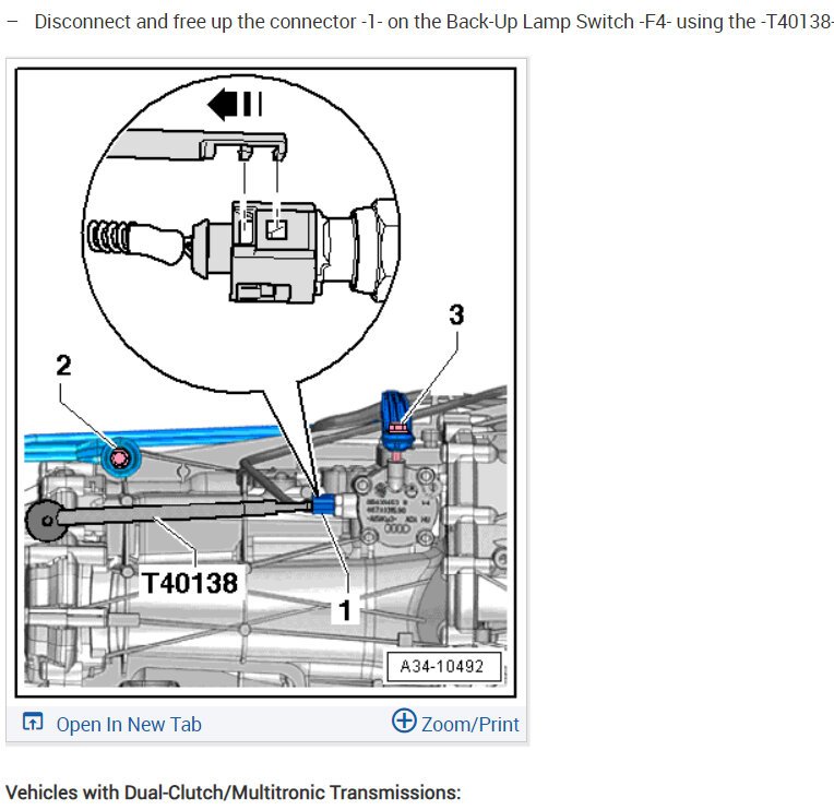

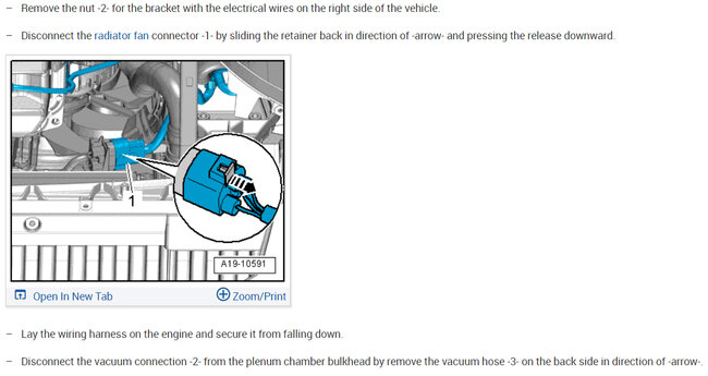

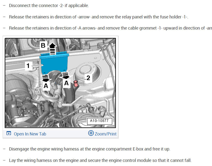

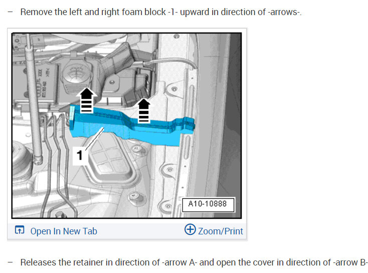

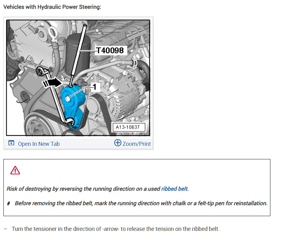

Sure, here you go, these are the instructions on how to pull the engine out of your car. start by disconnecting the battery and draining the coolant and motor oil. Check out the images (below). Please let us know what happens. Sorry for the late response.
May 4, 2024 at 1:53 PM
