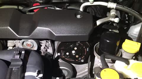

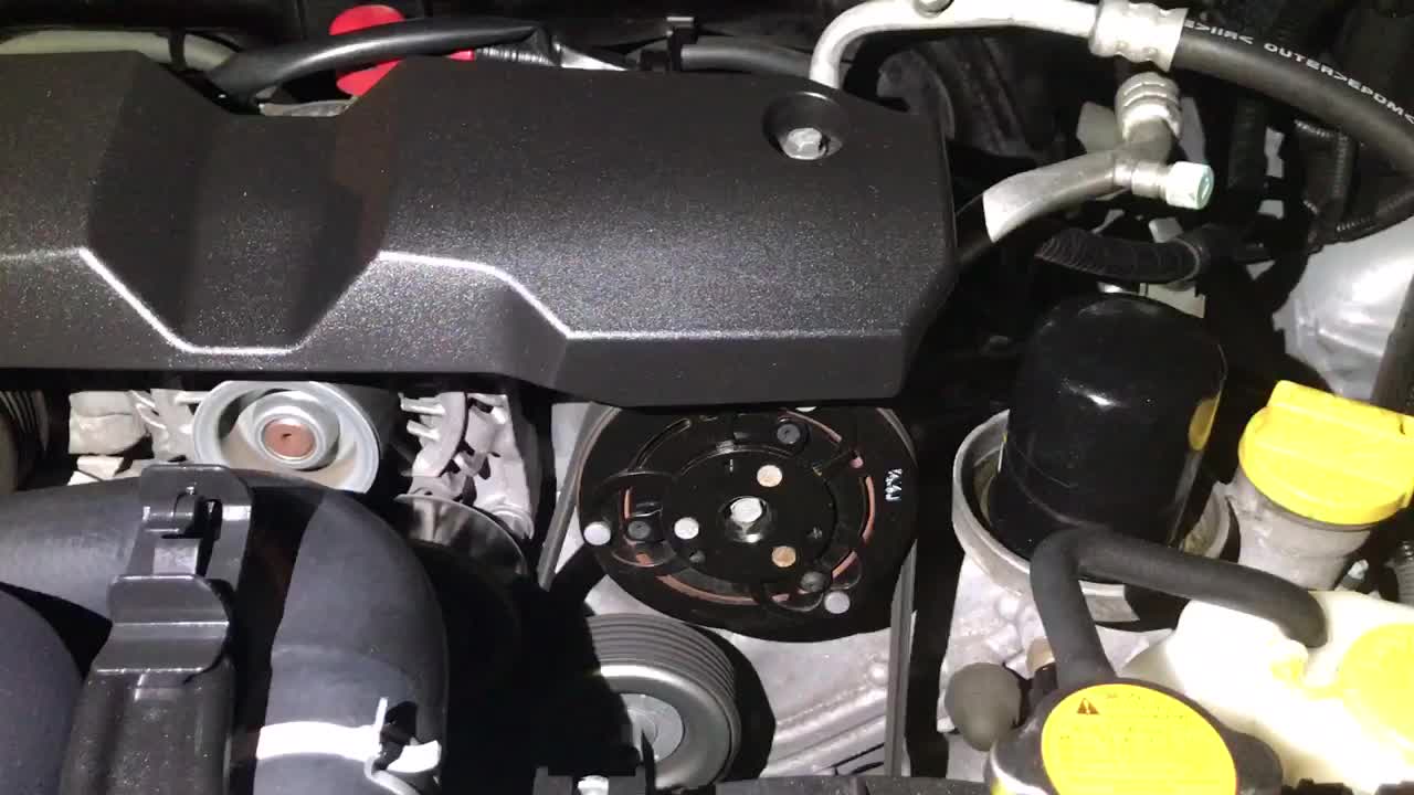

There is one pulley on the belt drive that starts and stops sporadically. at times it goes backward and makes a clunking noise when it starts or stops. is this normal?

What you are looking at is your A/C clutch, it is normal for it to start and stop. The backwards rotation is also normal. The clutch engages to allow the compressor to spin this is what moves the refrigerant through your A/C system. When the A/C is not on the clutch disengages allowing the pulley to spin without moving the refrigerant through the system.
The backwards turn is the high and low sides equalizing. Once the clutch disengages the valve closes and the compressor vanes are pulled.

Thank you very much. I just bought it today and was worried it was something serious.
