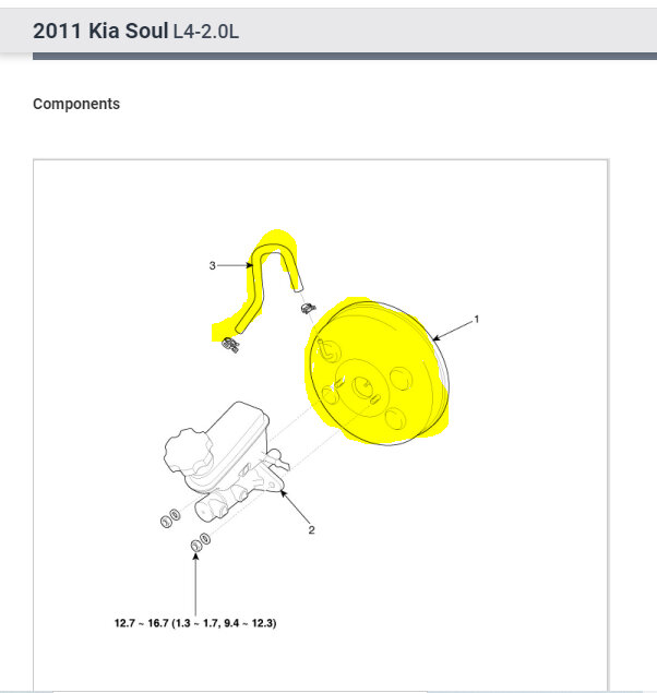

The idea that it hiccups when you press the brake makes me think there is an engine vacuum leak. When you press the brake, the vacuum booster is depleted, and additional vacuum is needed. You shouldn't feel that. If you do, that is where I would start checking.
Take a look at this link. It explains how to test for a leak.
Also, I attached a pic below and highlighted the vacuum brake booster and the vacuum supply hose. Check around there for leaks. It is located under the hood behind the brake master cylinder. Also, make sure the vacuum hose is tight at both ends and there is no evidence of dry rot.
Let me know what you find.
See pic below.

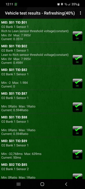

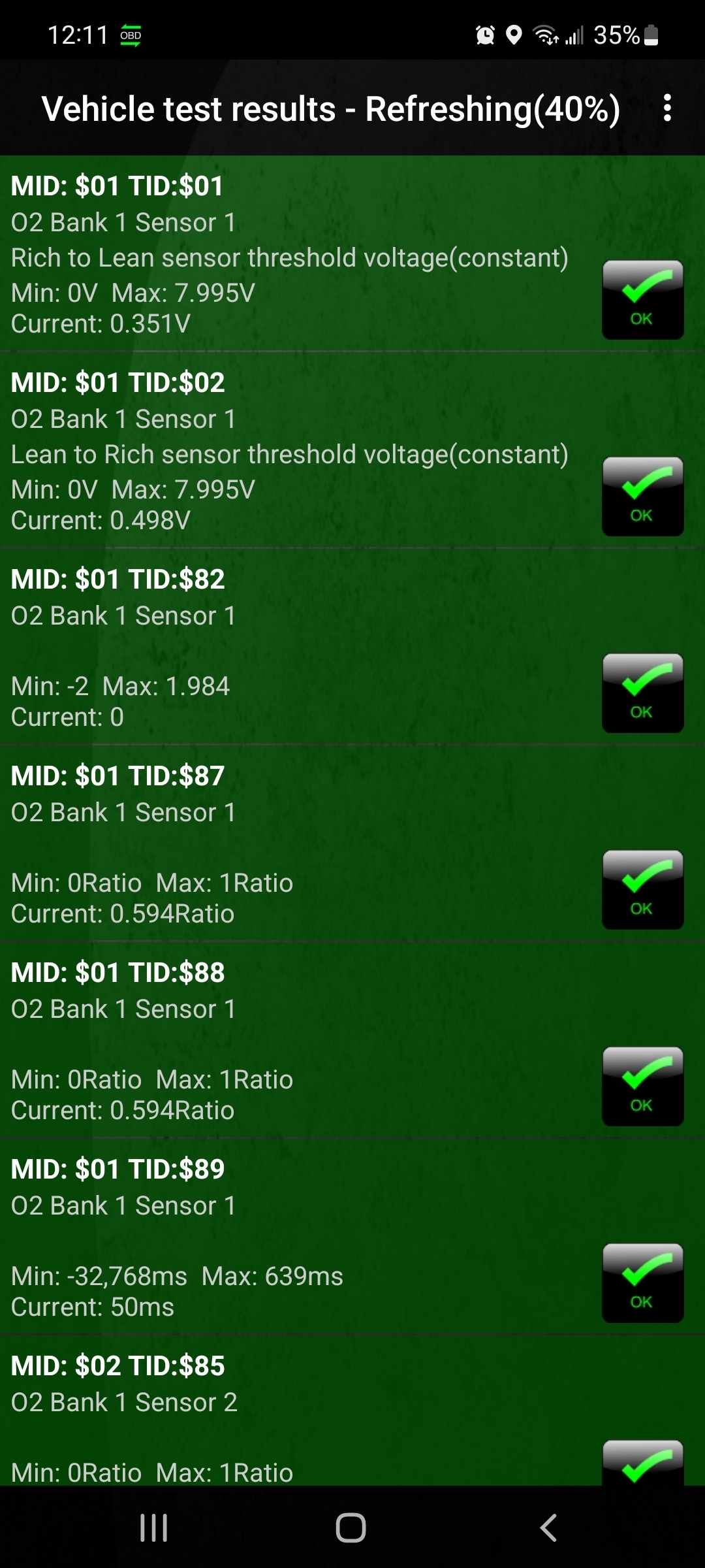

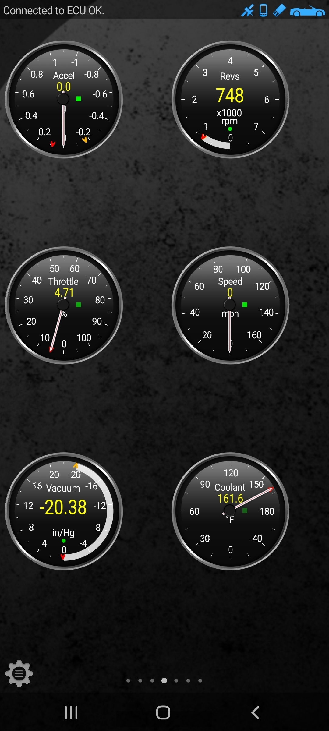

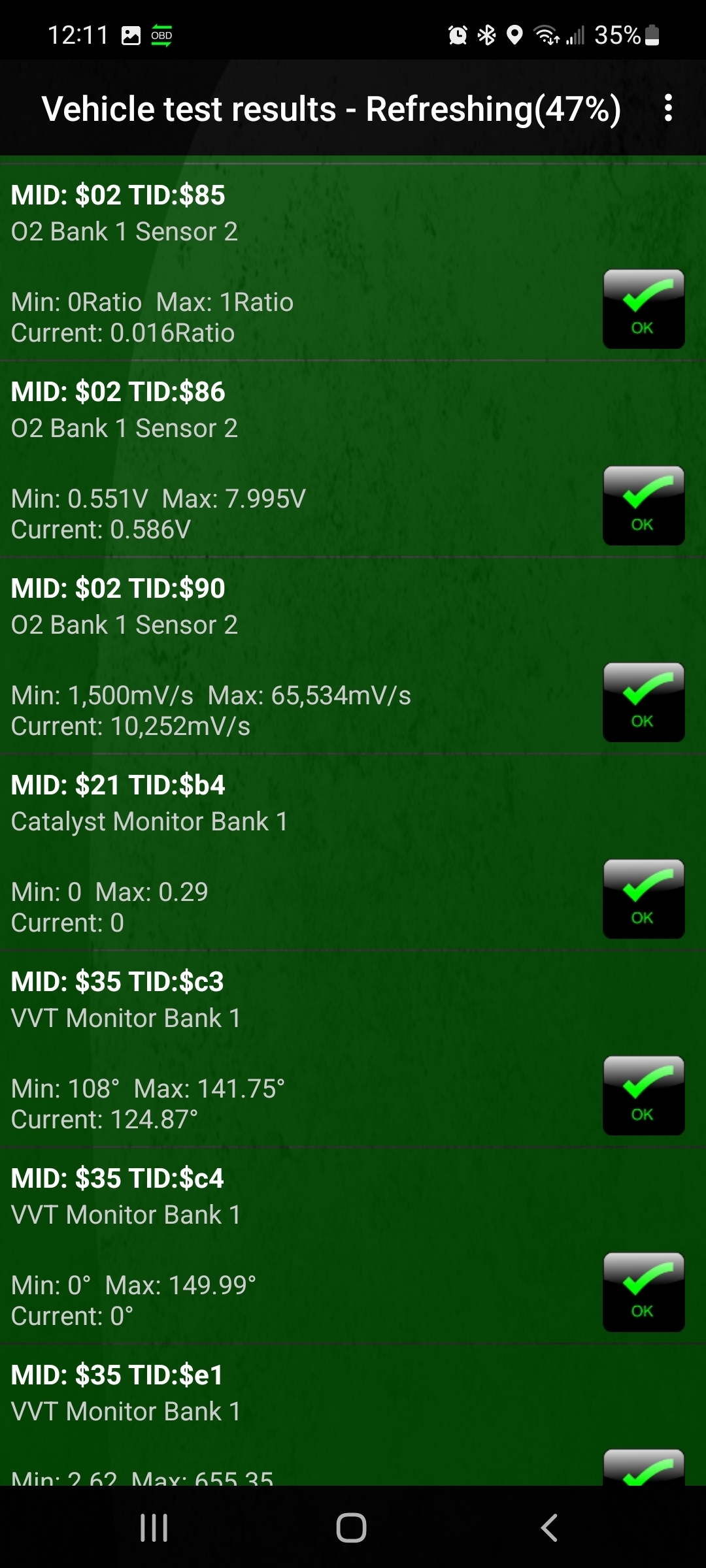

JUJU201731
  • 28 POSTS

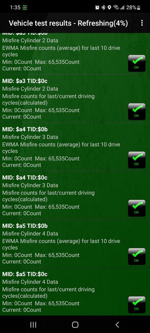

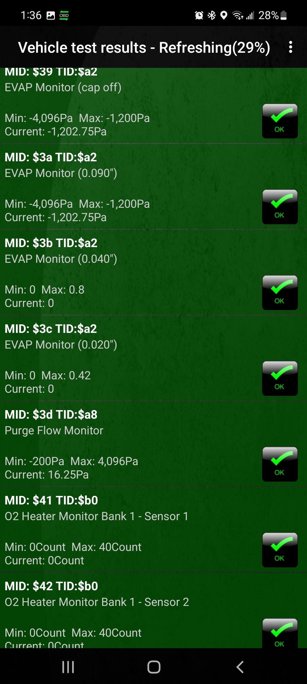

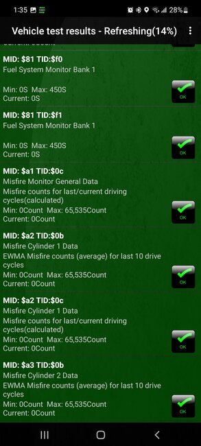

I don't know what short term fuel trim is
This is what I found using bafx.
There are no codes.
After using expensive gas for a couple months, engine transmission has become little smoother and brake (hiccup? Pounding? Feels like loose screw on rotor?) Has reduced
however recently I noticed engine started making little bit of whining noise
i also noticed recently that engine oil has been a little bit overfilled. Could this cause the problem?
My local mechanic told me this is due to a dirty gas tank. Would you find this to be credible?
If I continue driving like this, could it damage anything on my car?
Monday, November 28th, 2022 AT 1:07 PM

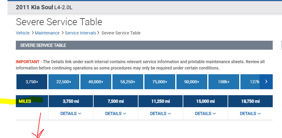

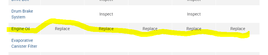

The idea that you drove that far on an oil change (10K miles), that is extreme the manufacturer is recommending every 4,000 miles. Am I correct in what I read?
Let me know. Also, see pics below for service table information.

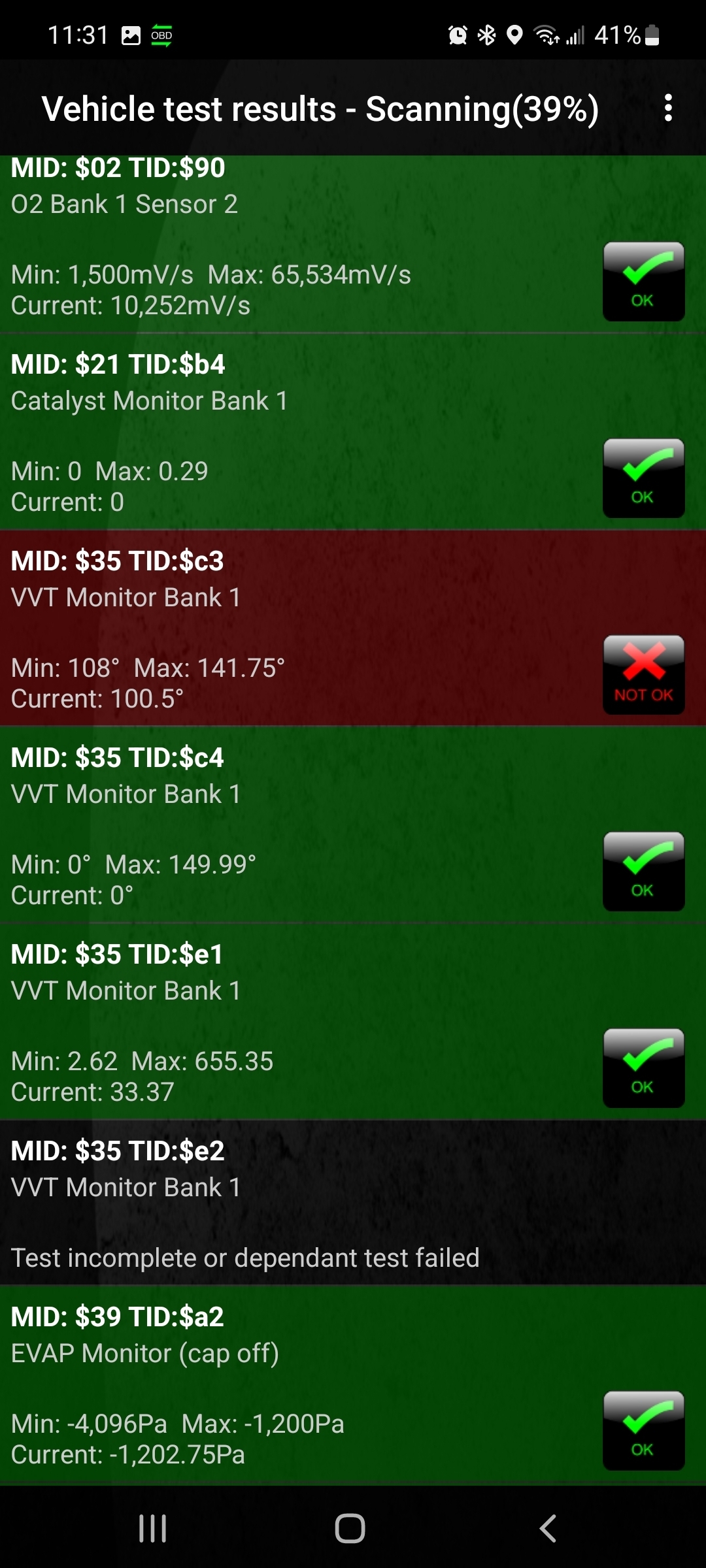

JUJU201731
  • 28 POSTS
It's synthetic oil.
On the obd2 I get VVT bank 1 fail
Should I be worried about it?
What does it mean?
I also get a little bit of whining noise come and go.
Is it normal to have bubbles on dipstick?
Thursday, December 8th, 2022 AT 2:09 PM
  • 109,885 POSTS
Just remember to keep the oil serviced. I realize it is synthetic. However, keep in mind that engine oil doesn't wear out. It gets dirty. That happens regardless of whether it is a synthetic or conventional oil.
I have two vehicles that require synthetic of my own. I change them at no more than 5K intervals. It's just a thought.
As far as safety goes, it will just progressively get worse and could lead to internal engine damage. If you plan to keep the vehicle, I would have it repaired.
