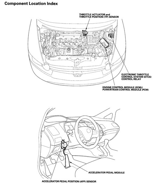

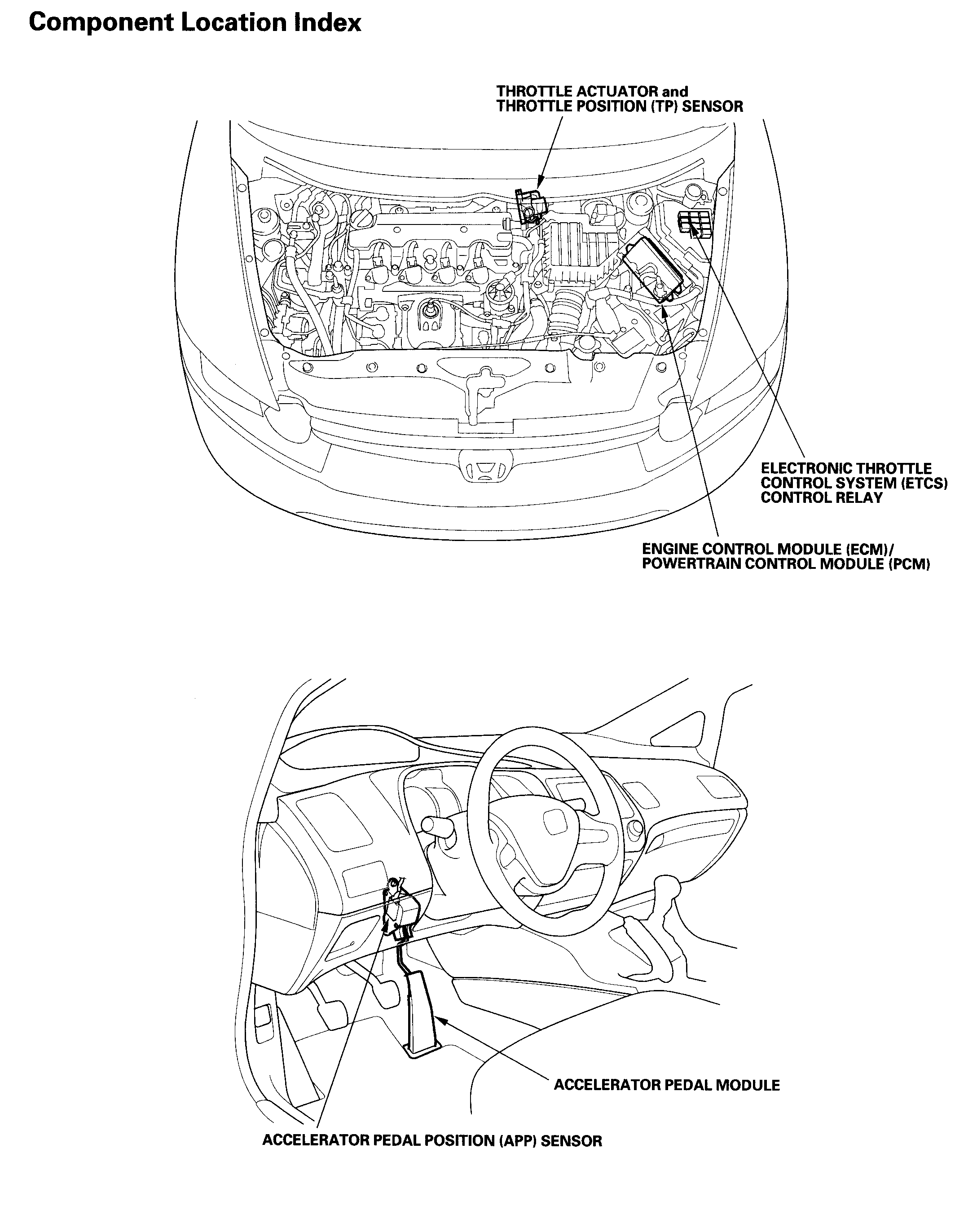

Your vehicle has an electronic throttle control actuator which maintains engine idle speed based on need. For example, if nothing is on and then you turn the AC on, it adds a load to the engine. At that point, the power control module increases the idle speed via the actuator to account for the added load.
With that being said, the first thing I need you to check is the throttle actuator relay. It is located under the hood of the vehicle on the driver's side. I have attached a picture of its location as well as the location of the actuator. There are two ways you can check it. First, locate another relay in the same box with the same part number on it and switch them. Or, here are general directions for checking a relay.

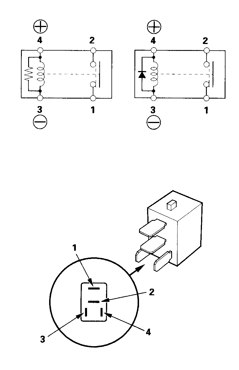

The first picture I have attached is the location. Here are directions for checking the relay specific to your vehicle: Pictures 2 and 3 correlate with these directions.
__________________________________

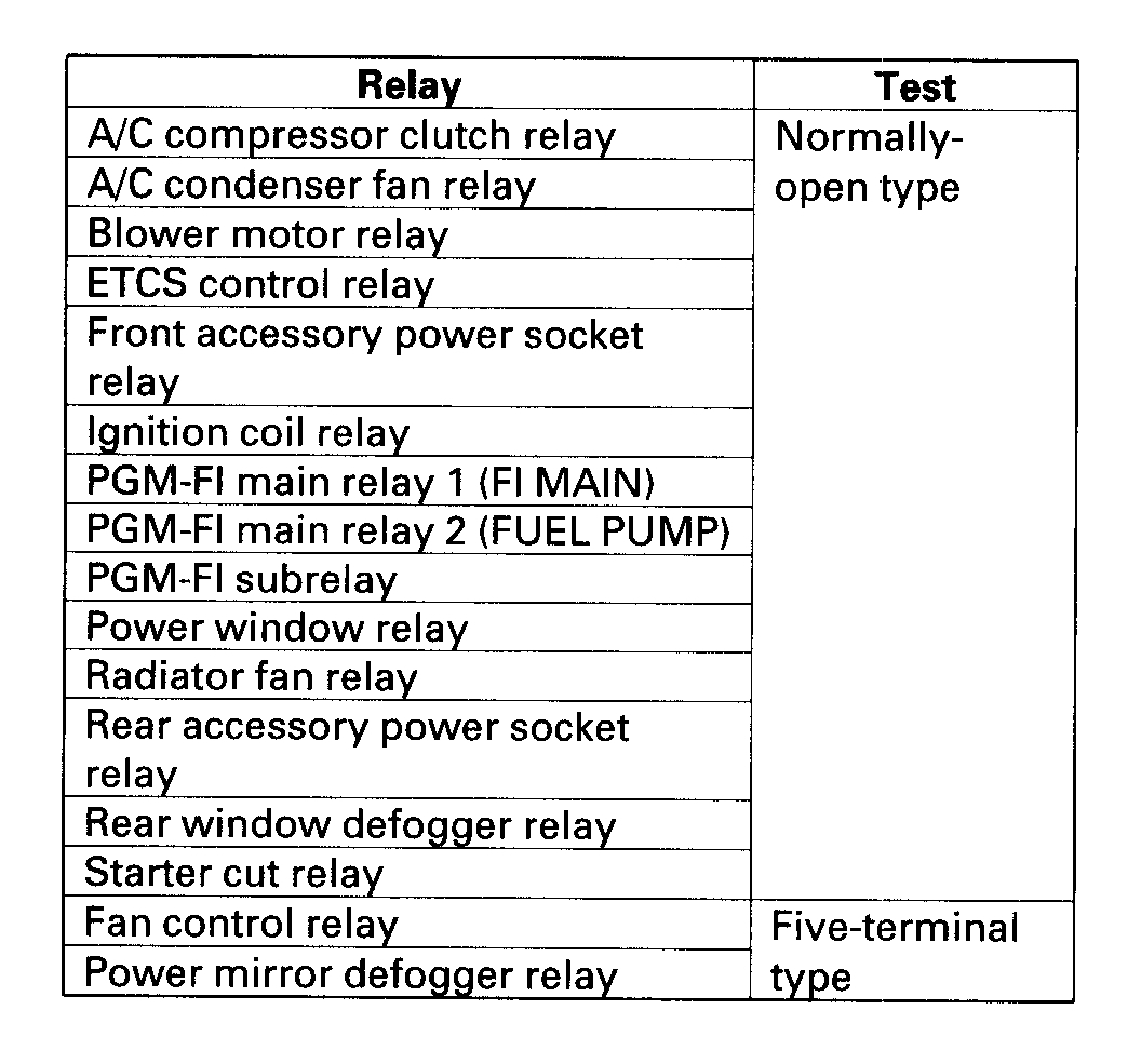

POWER RELAY TEST
Power Relay Test
Use this chart to identify the type of relay, then do the test listed for it.
Normally-open type
Check for continuity between the terminals.
- There should be continuity between the No.1 and No.2 terminals when battery positive terminal is connected to the No.4 terminal, and battery negative terminal is connected to the No.3 terminal.
- There should be continuity between the No.1 and No.2 terminals when power is disconnected.
