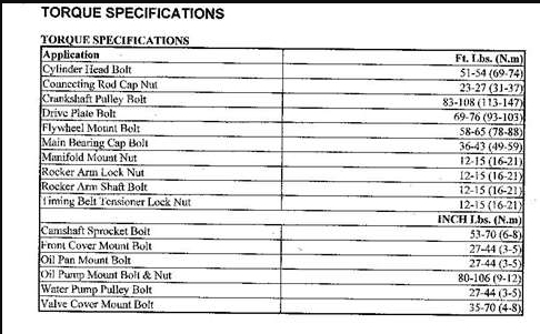

Require torque settings on Nissan np200 1.5L diesel
K9K engine.
Cylinder head torque settings
Main bearings torque settings
Big end bearings torque settings
Flywheel torque settings
Jul 23, 2021 at 3:54 AM
Unfortunately, we don't have a manual on this vehicle or engine as it is not offered here in the USA, but I was able to find some info on it the vehicle, but I cannot confirm this is the same engine, it does appear to be accurate to this vehicle.
While I cannot confirm this through an official manual it looks like the big end have 2 stage torque setting. However, I would suggest contacting a dealer and asking them to confirm this for this engine.
The first stage is to 29 Nm. Then the second stage is to 45 Nm plus a 60 degree turn.
The other torque specs that you are looking for are attached below.
Please let us know if you have other questions on this and we will assist how we can. Thanks
