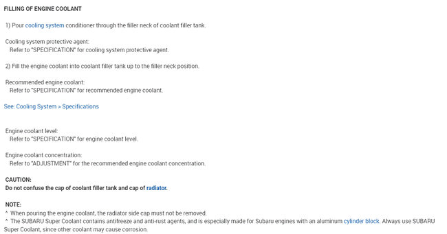

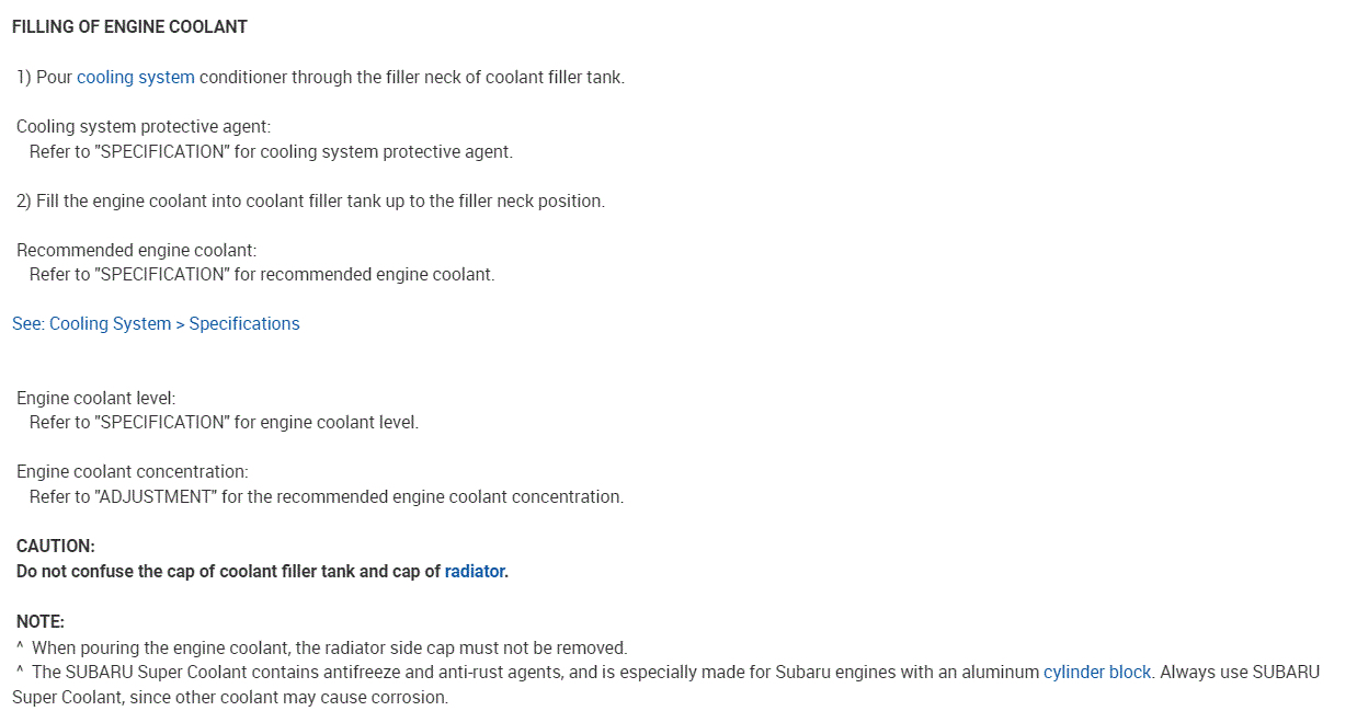

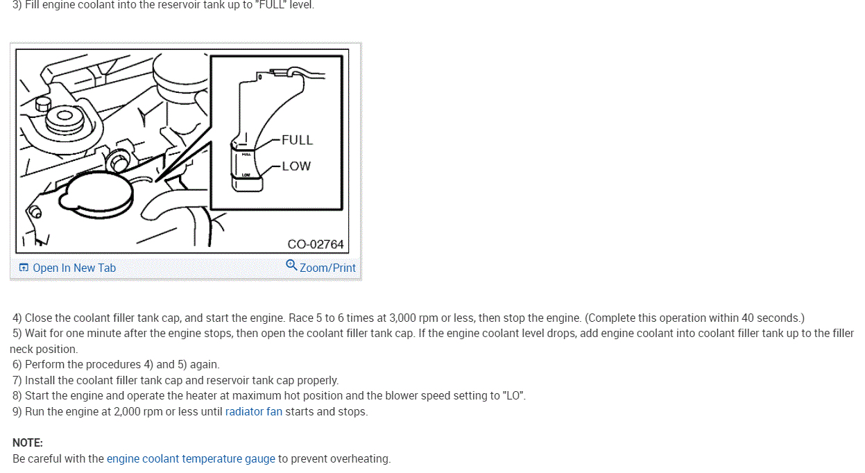

Do the cooling fans turn on when it is at an idle and getting to the hot range? Also, the idea that the heater doesn't work leads me to think there is air in the system preventing the coolant from properly circulating.
Take a look at the directions below that are for refilling the radiator. Let me know if you have tried this. Also, take a look through this link. It describes how to test for a bad head gasket. You may be getting compressed air into the cooling system causing air blockages. It's just a theory at this point.

Yes, fans kick on when I’m at idle. I also use the no spill funnel and squeeze all lines, as well as turn the heat on full blast to try and burp the system. I replaced the timing belt at the same time as the pump, roughly 6 months ago.

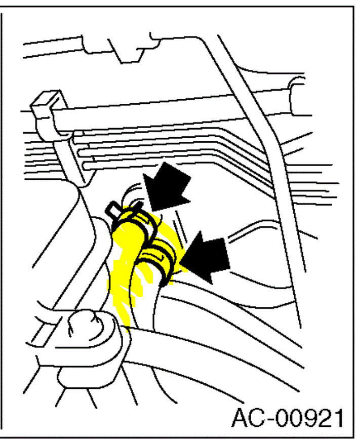

First, you mentioned there is no heat. That could be a completely separate issue. With the heater on, start the engine. When the car is at operating temperature and the heater is on high, feel both heater core hoses. Both should be hot. If they are, then chances the heat issue is related to the blend air door in the vehicle. The hoses are under the hood mounted to the firewall. See pic below.
