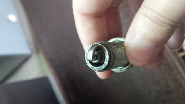

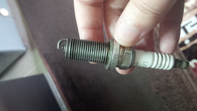

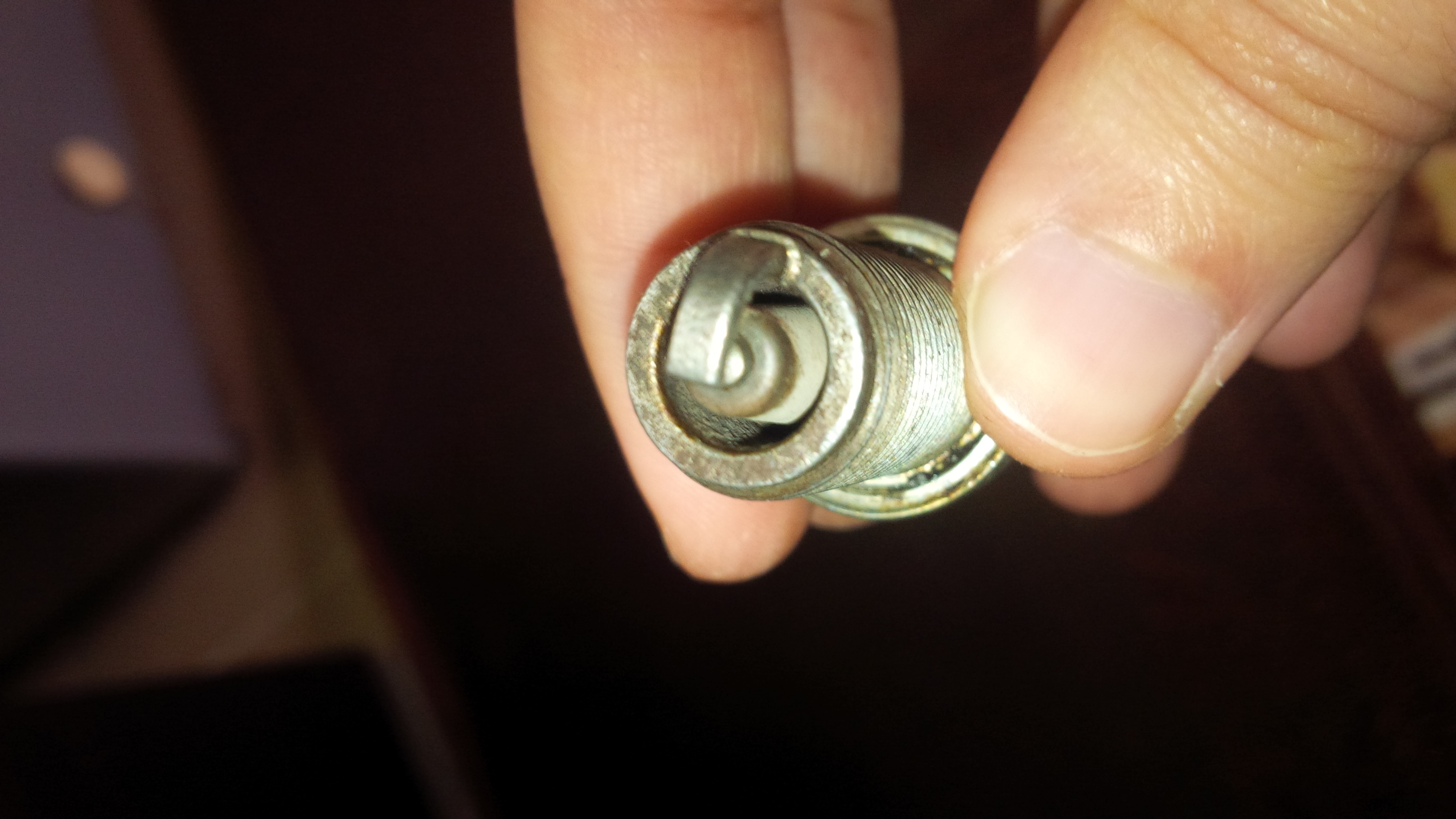

During that month i drove the car for nearly 370 miles, i didn't notice any blue smoke from the exhaust and the coolant fluid is normal, i took a picture of the spark plugs.

Those look great. One question. Did you check the oil when you stopped driving or after the vehicle sat for at least 5 minutes?

Yes, the spark plugs look fine. If you have no oil leaks and there is no blue smoke from the exhaust, there is a chance the engine rings are wearing.
