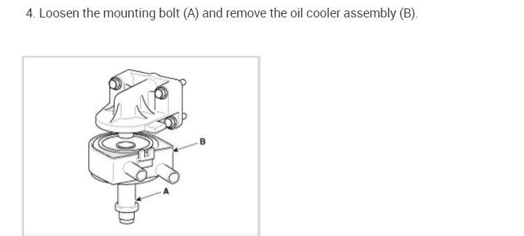

oil is found in the radiator, engine oil decreasing in the engine. the engine oil does not have coolant mixed (the color of the oil is normal), only the radiator has oil in it.

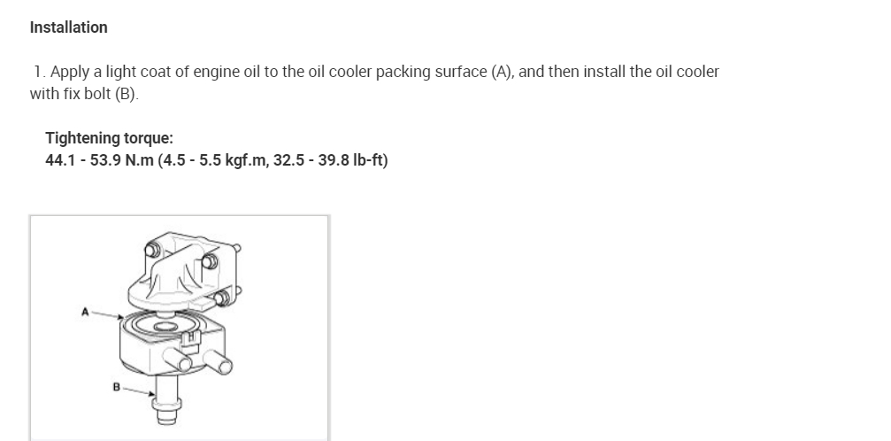

HANIYSF

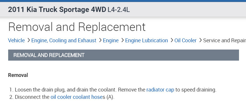

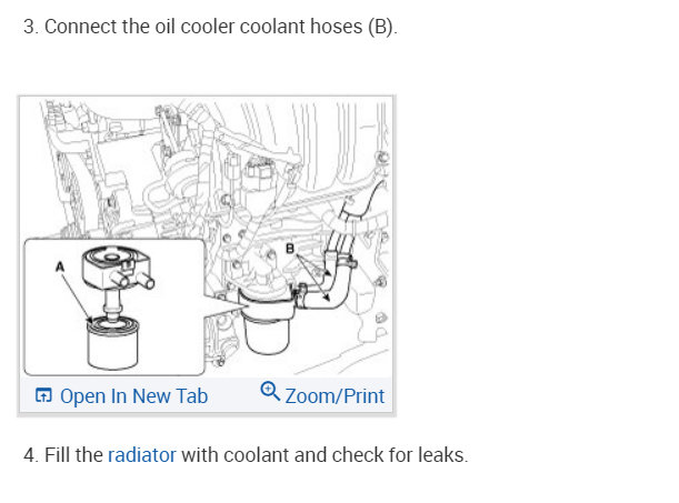

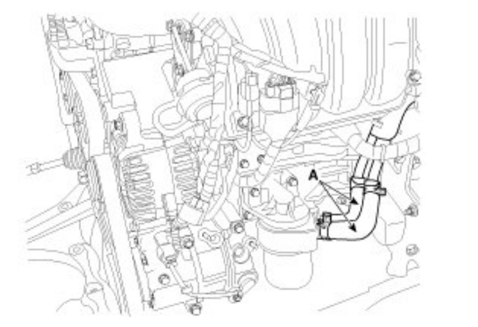

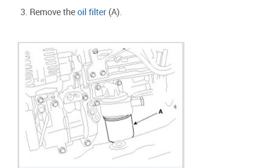

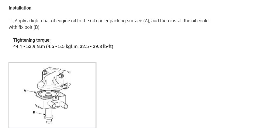

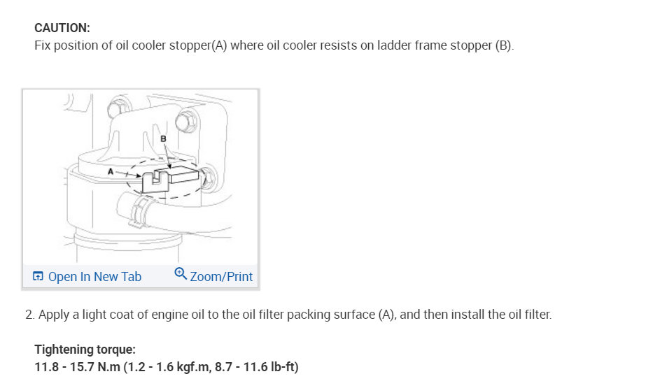

Thanks Alex, I have a doubt about the oil cooler and I need to eliminate that possibility. Any ideas about how to examine the oil cooler?
Sep 25, 2019 at 12:02 PM
SCGRANTURISMO
  • 4,897 POSTS
Hello again,
Sorry about that, I didn't realize that your engine was equipped with an engine oil cooler. I have included the instructions for the removal and installation of the engine oil cooler in the diagrams down below. While the cooler is removed inspect it for cracks and make sure that the fix bolt wasn't loose. Please get back to us with what you find out.
