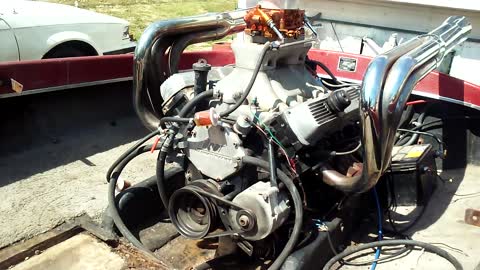

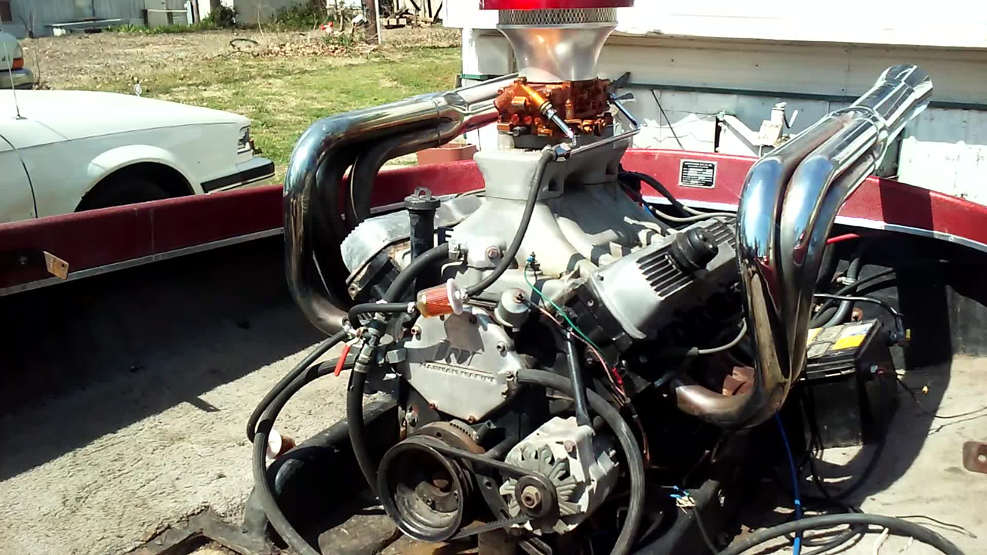

This is a 455 olds in a jet boat. I winterized it last fall removed the tarp I had on it last week to work on a bad place in the floor. I thought I would start before I covered it back up well it fired right off but had an awful rattling noise in the front of the engine.This noise was not there last summer. Only started it twice and run it about thirty seconds each time. When I rev it a little I do not hear the noise until it comes back down to a idle. I am changing the oil and filter and pulling the plugs and turning it over a few time before trying to start it again.

To me is looks like that alternator pulley is loose. If you watch the fins they appear to be slowing down when the noise is loudest. You can definitely see the belt flopping.

That noise was back again. Started it Thursday morning was the first chance I had sense the oil pump priming, anyway sent the boat to Joplin MO. With my brother he is a mechanic up there he got his stethoscope out and found the problem, I feel dumb because all of the fly wheel bolts were loose. I have had flex plates come loose or crack out but never had a regular fly wheel come loose. Anyway, took drive shaft loose and took out each bolt check them out lock tight on and torqued them, put it all together started it the noise is gone.
It is crazy how a noise in the back project its self to the front.
