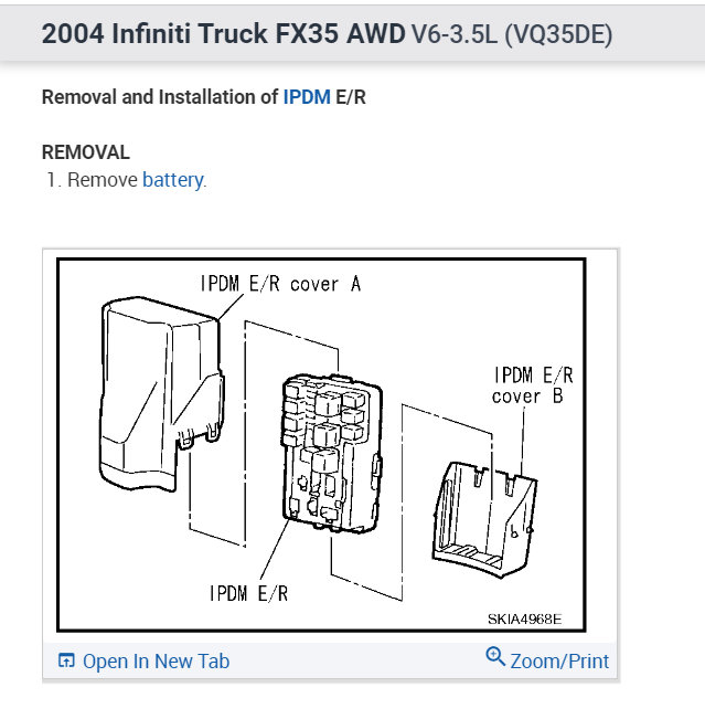

I was driving and took an exit went to proceed and car would just not crank or run. I've had problems w fuses seats not properly working or locks. I really think someone messed w my wires or fuses or something. I don't know how to tell if the engine is blown. Or if it is worth buying another motor?
Sep 8, 2022 at 8:48 PM
  • 55,433 POSTS

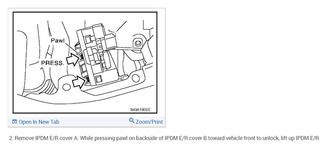

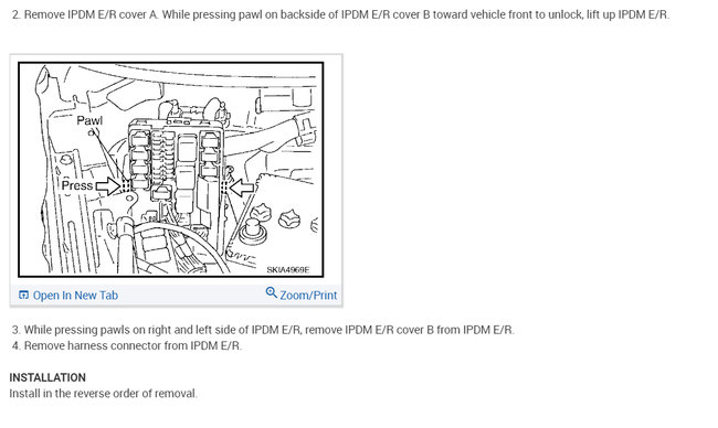

When you go and crank the engine over do all the lights dim way down? If not, the engine is probably okay. These cars had a problem with the IPDM which supplies power to the car. You should also do a CAN scan to see what comes up. You can get a CAN scanner (Controller Area Network) from Amazon for about $30.00.
https://youtu.be/u-4syLc-ifQ
Here is a scanner link:
https://amzn.to/3o41KcZ
Here is how to change out the IPDM which is not too bad because it self-learns. Can you please shoot a quick video with your phone so I can hear the engine try to crank over? That way I can tell for sure what's going on. You can upload it here with your response. Check out the images (below). Please let us know what happens.
