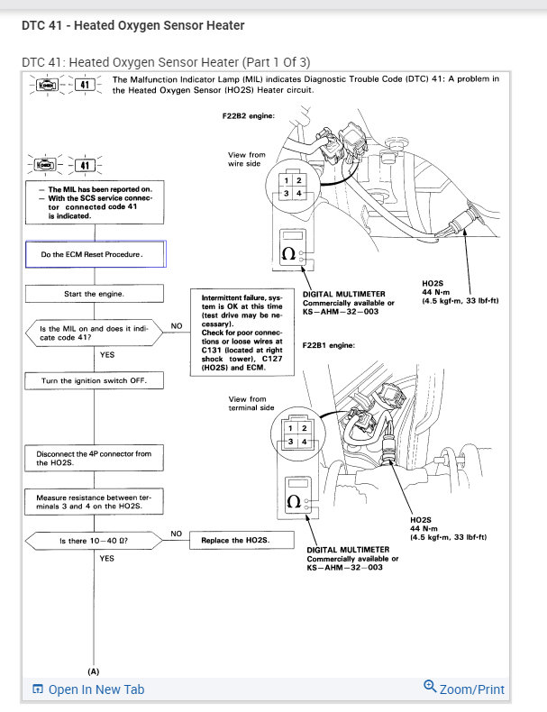

i have the car listed above EX with a 2.4 vtec. by the way this might not make a difference but the car sat for 11 years,never started even once during that time it sat. the day i tried to start it,put some gas in intake started right up. okay, anyways the other day had my family in car so it was kinda low to the ground, i drive up a driveway and tore the muffler right off. I didn't have time to put it back on, so i drove it for a whole day with no muffler. yesterday i finally reattached it, drove a little while. next morning on the highway engine started running real rough had to shut off A/C. Got a code 41. any help would be really appreciated.
Aug 31, 2020 at 10:01 AM

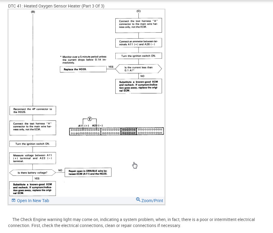

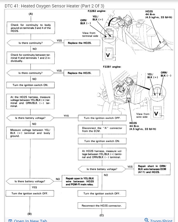

I attached the testing that we need to run through in order to find out what the issue is. I suspect you have a wiring issue due to the trauma to the exhaust but we need to confirm that by running through this testing.
Let me know what questions you have. Thanks
