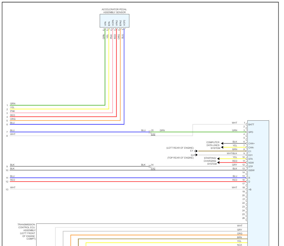

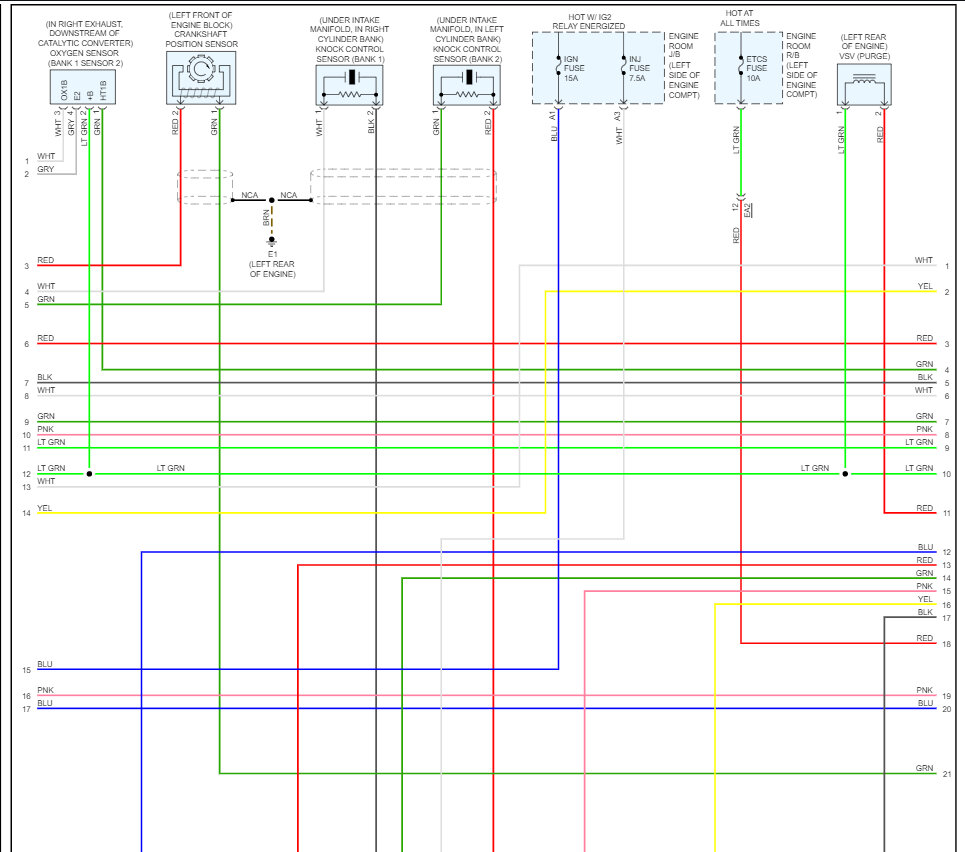

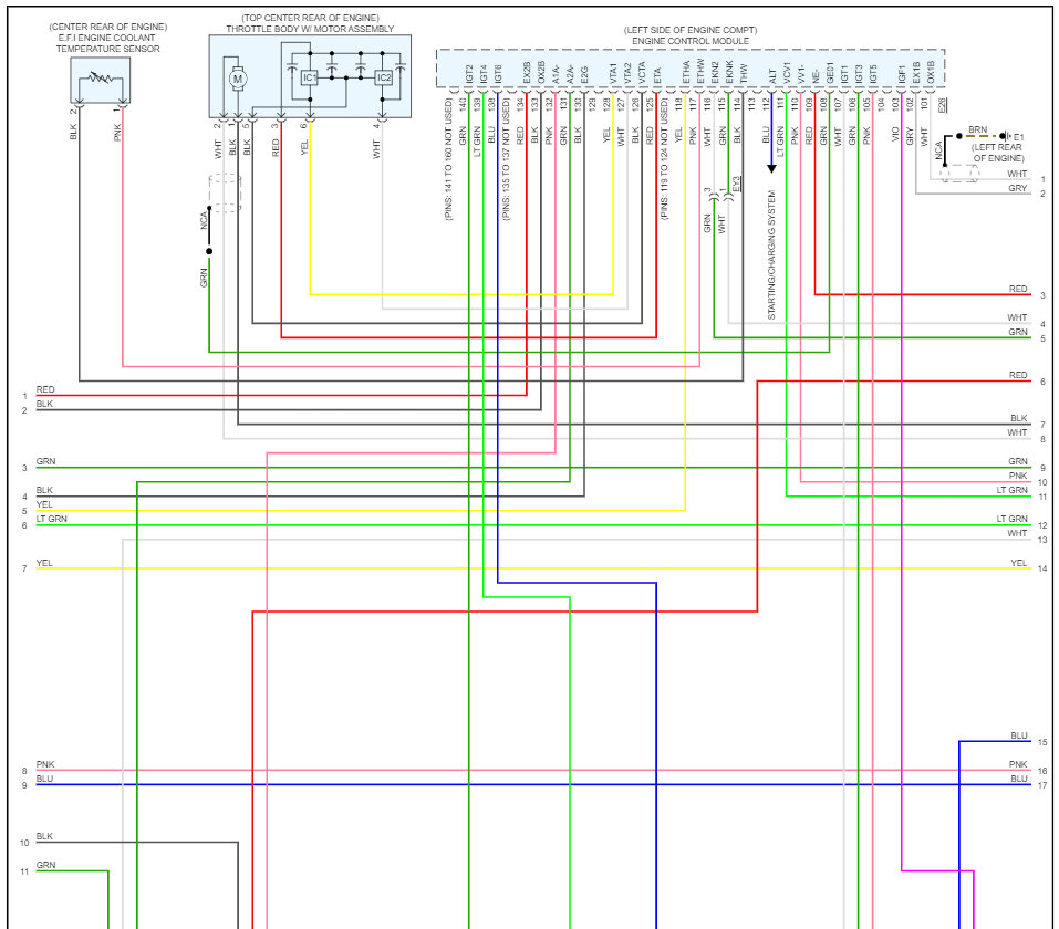

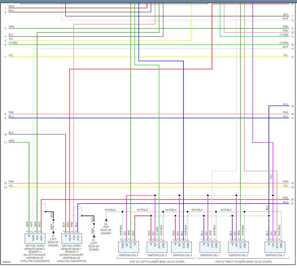

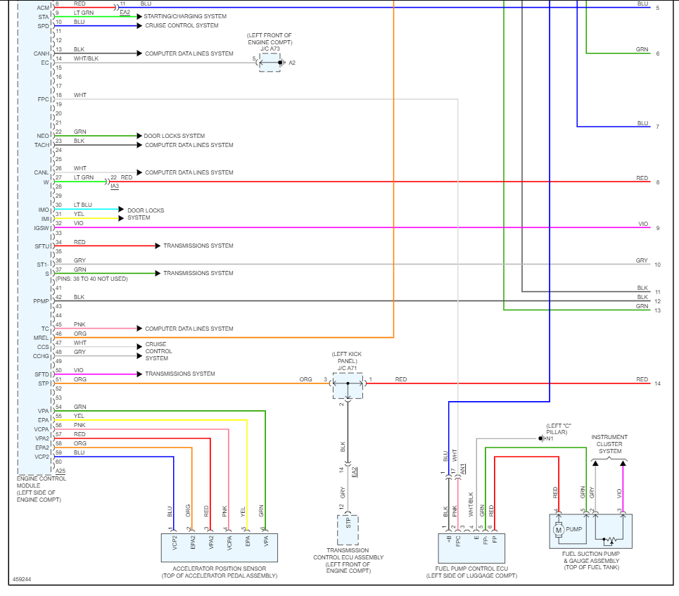

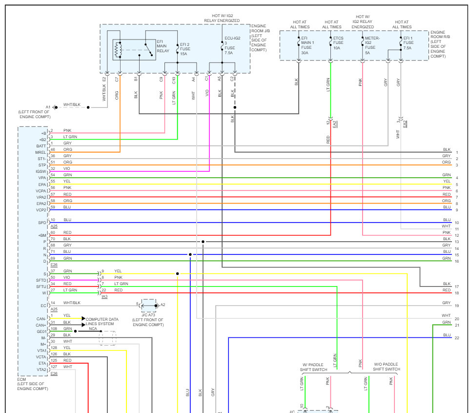

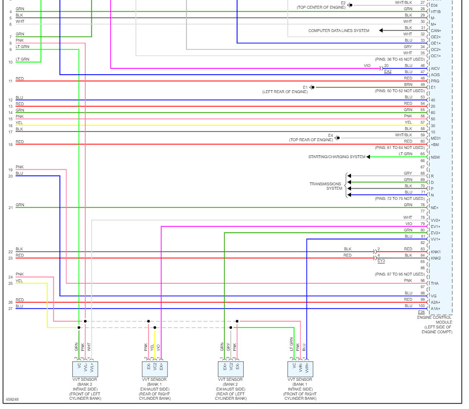

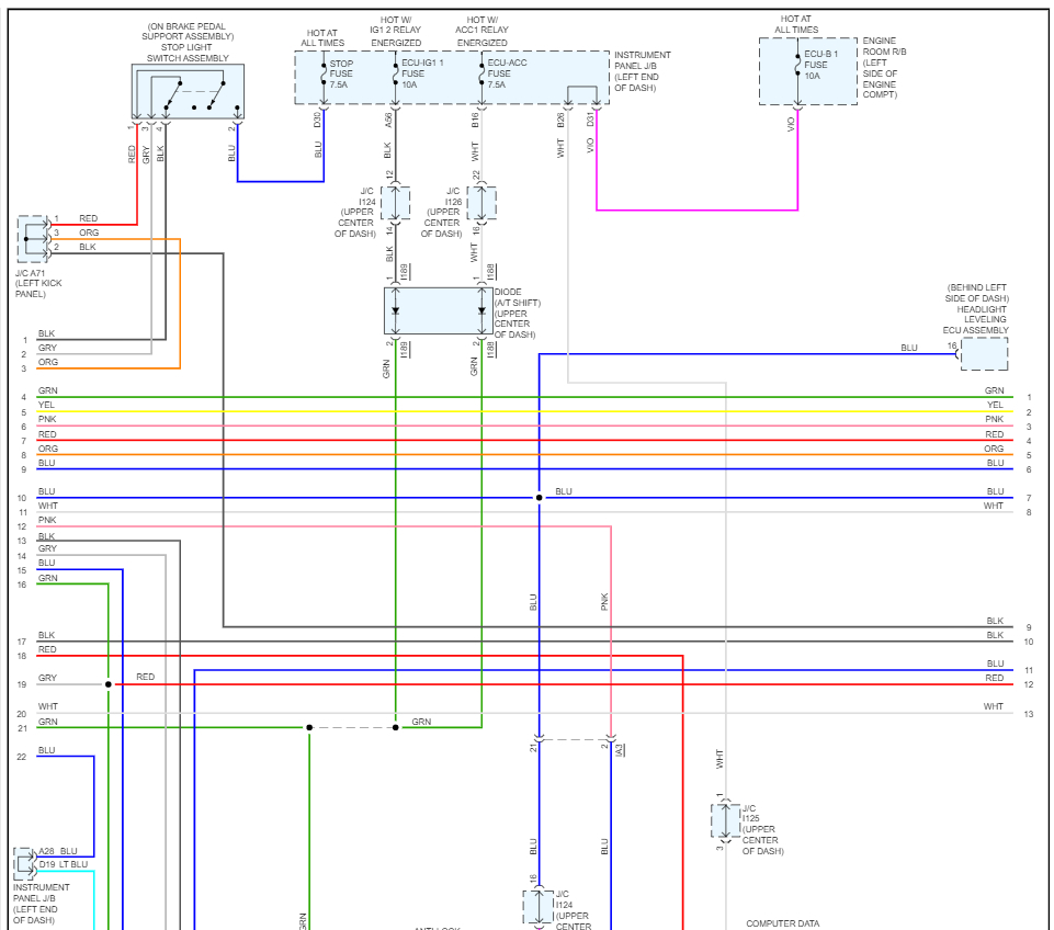

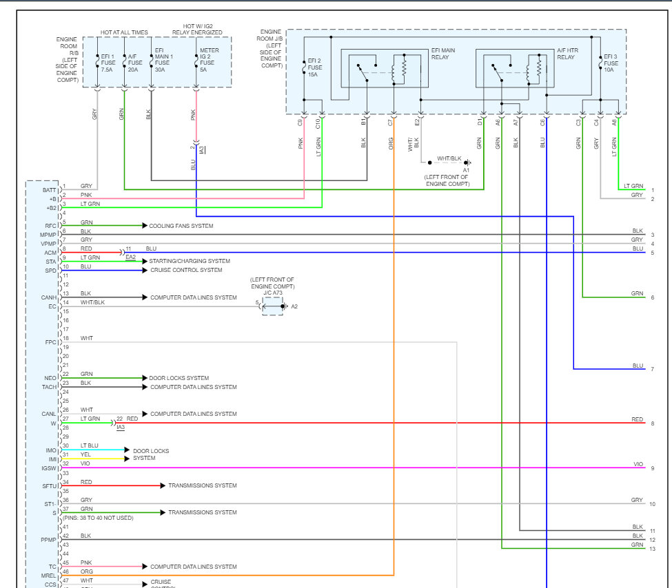

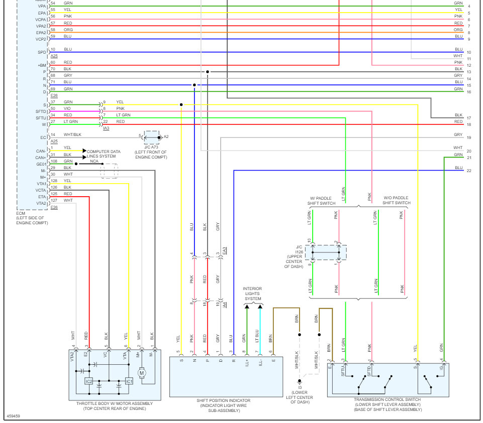

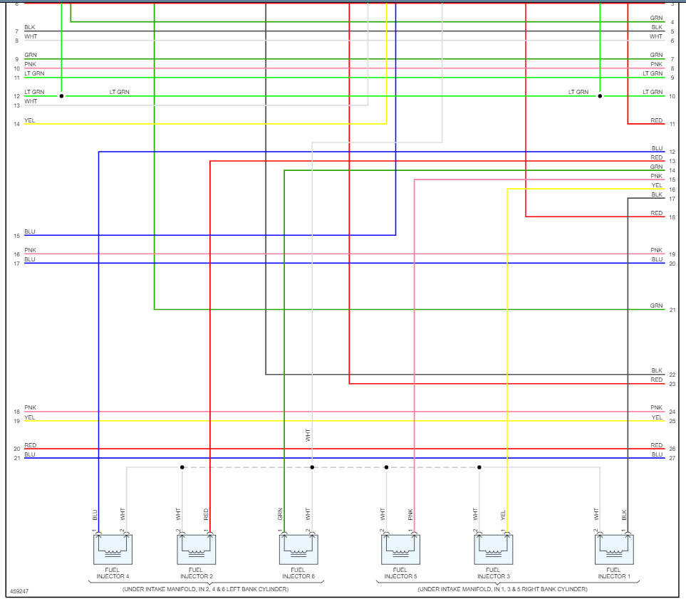

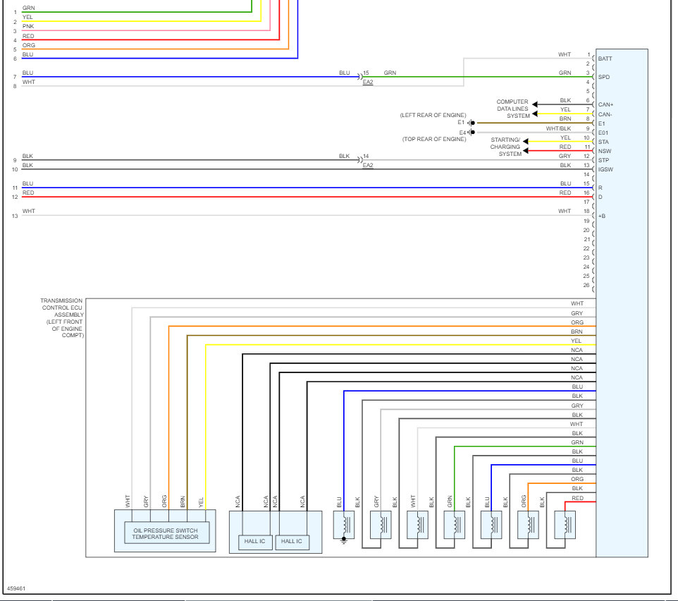

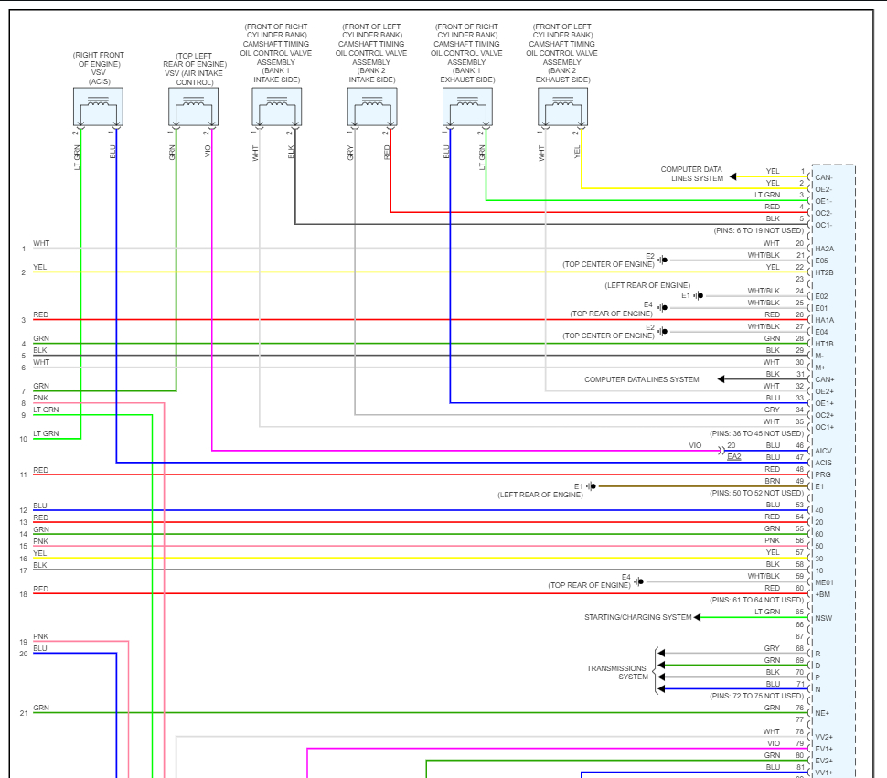

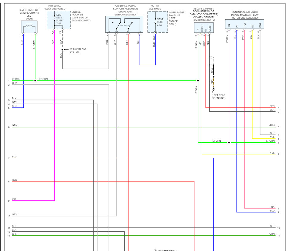

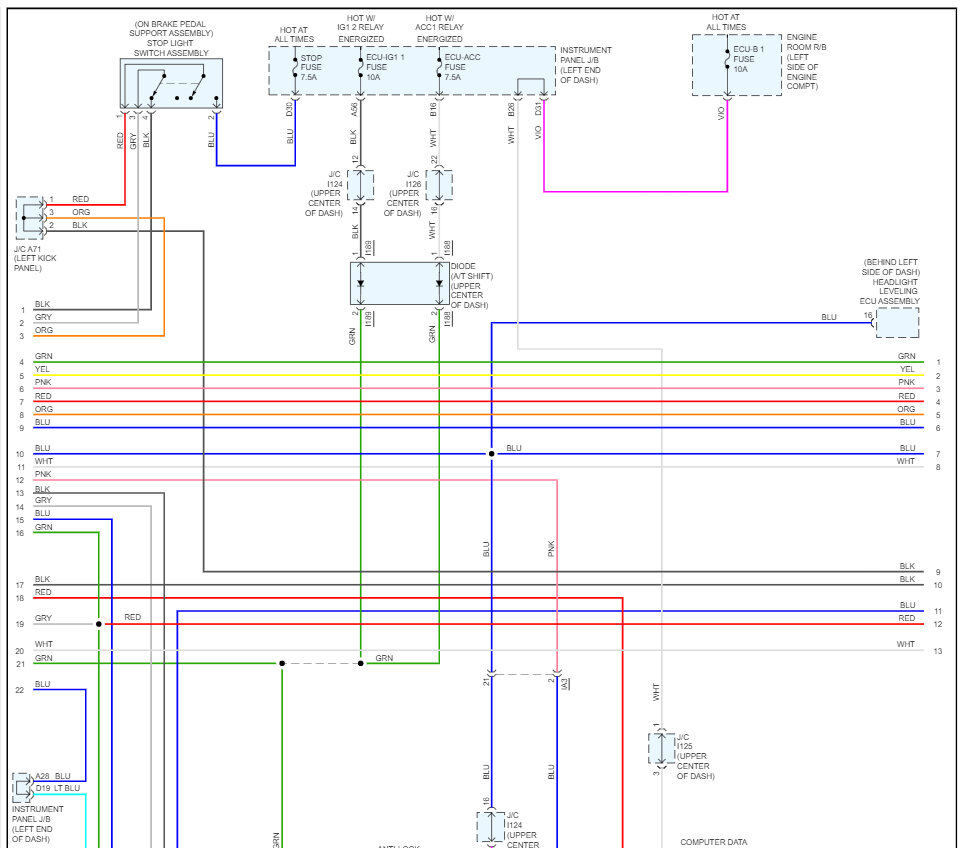

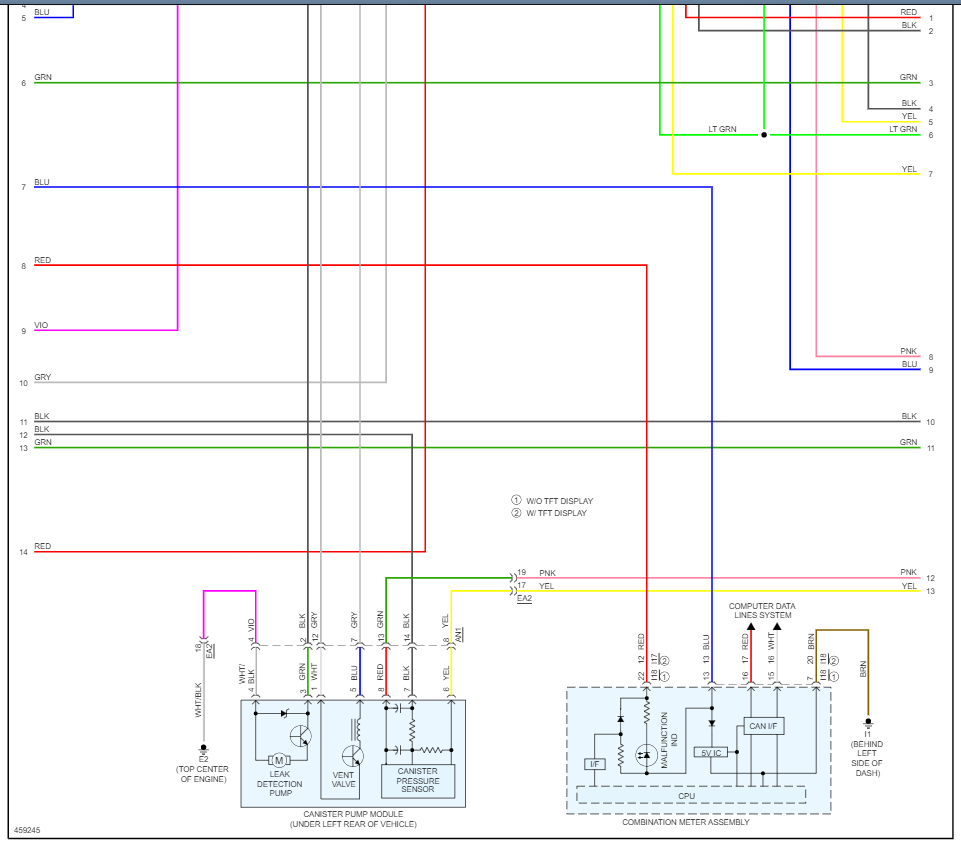

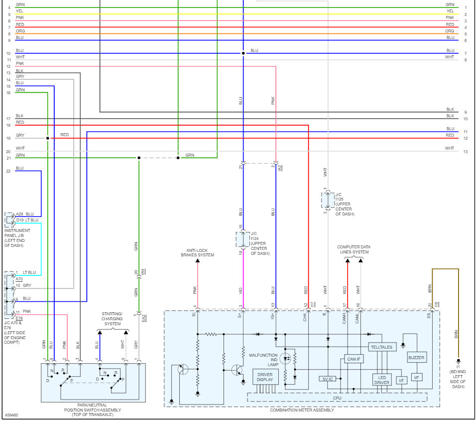

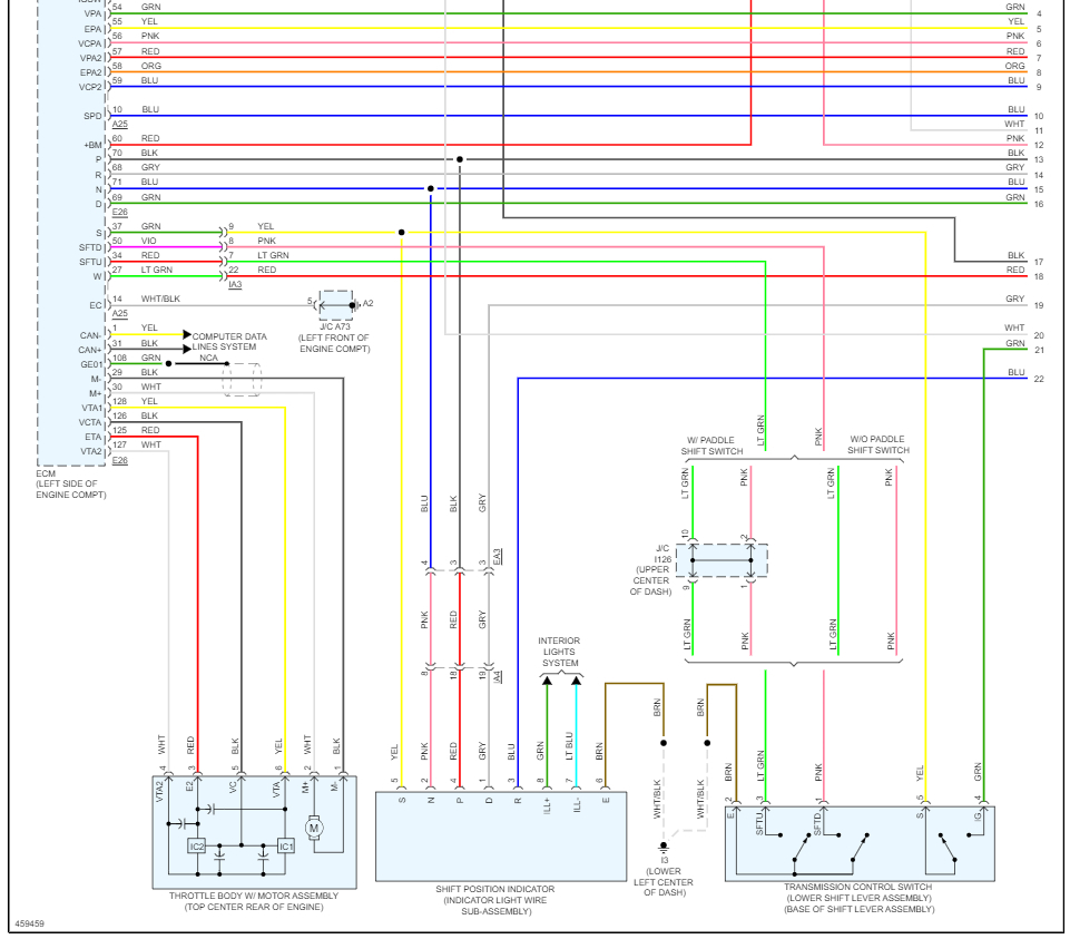

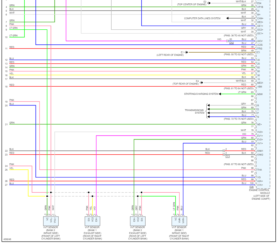

Good evening, the do give multiple misfire codes sometimes and it seems that it has affected the transmission shift. The coils and the plugs are okay, and the fuel injectors are pulsing well and some time it does give shift solenoids codes. Please could I have Circuit Transmission and Engine wire diagram?
Mar 12, 2023 at 6:34 AM
  • 55,433 POSTS
This can be caused by the MAF sensor which the engine and transmission use here is the location of the sensor in the images below so you can replace it with a guide to help walk you through the replacement.
https://www.2carpros.com/articles/how-to-replace-a-mass-air-flow-sensor-maf

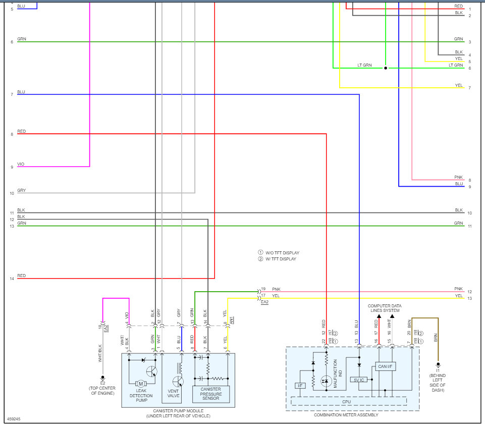

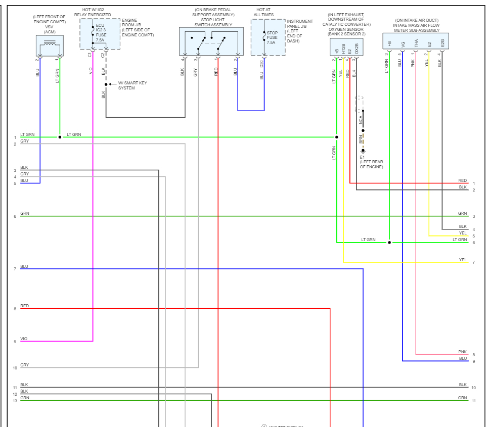

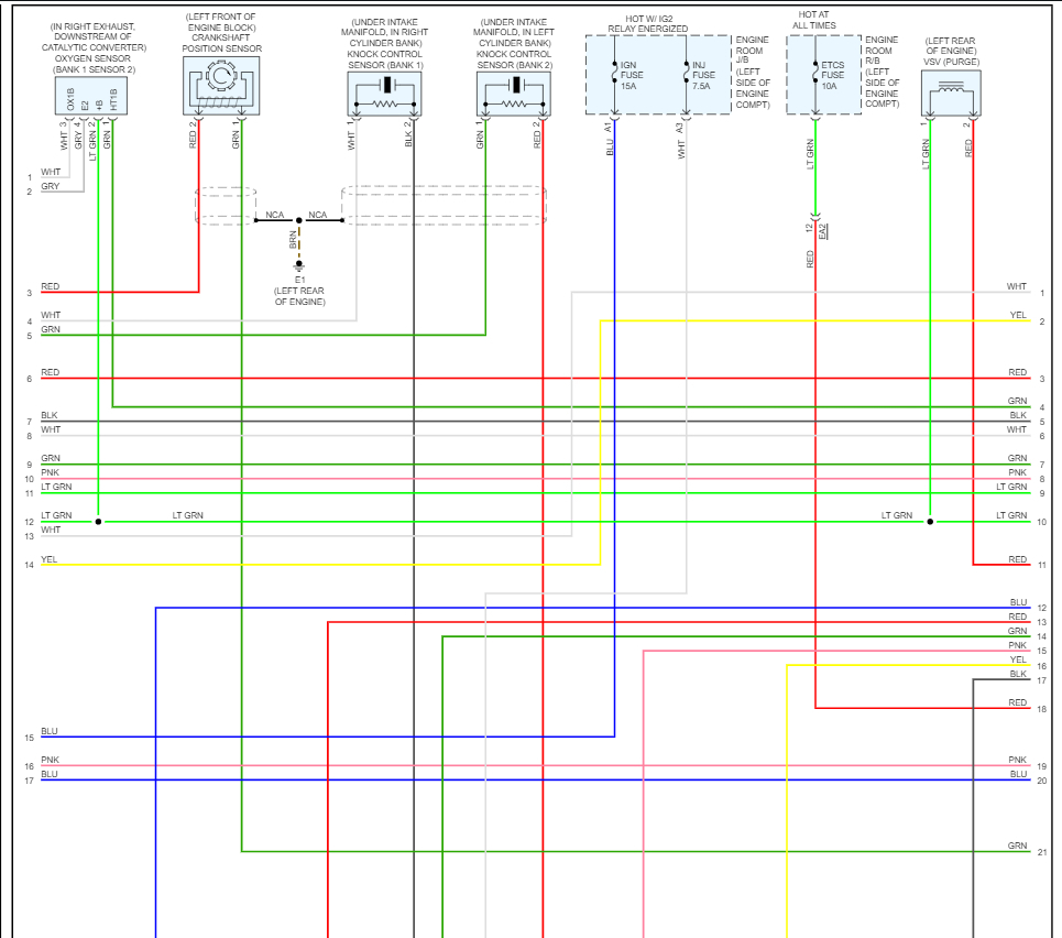

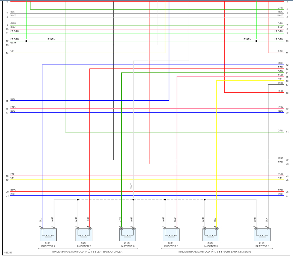

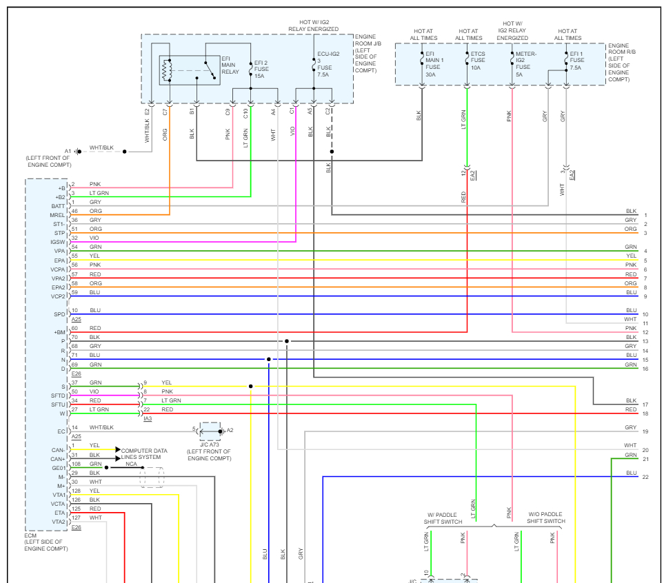

Here are the engine and transmission wiring diagrams as well. Check out the images (below). Let us know what happens and please upload pictures or videos of the problem so we can see what's going on.

The vehicle is in good condition now, thank you very much.
Mar 15, 2023 at 11:41 AM
  • 55,433 POSTS
What fixed the problem?
Mar 16, 2023 at 3:55 AM
BLESSING EWOBOR
  • 753 POSTS
One of the coil wires had open circuit, fixing the wire solve the problem.
