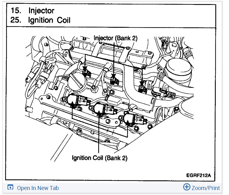

It runs fine cold but after warming up sends codes p0303, p0305, and sometimes p016?
Sep 3, 2024 at 1:17 AM
  • 55,402 POSTS
Can you please recheck the p016 code, there should be another digit. The codes P0303 and P0305 indicate misfires in cylinders 3 and 5, respectively. So, I would start with a typical tune up and replace the spark plugs and ignition coils which are normal service items.
https://www.2carpros.com/articles/how-to-tune-up-a-car-engine
NGK Iridium IX: ILFR5B11 (stock number 6596)
Denso Iridium TT: IT20TT
Also, I would service the throttle body as well. Here is a guide to help with that as well:
Once the job is complete clear the codes and take it for a drive to see what happens, here are instructions in the images below for your car. Check out the images (below). Please let us know what happens.

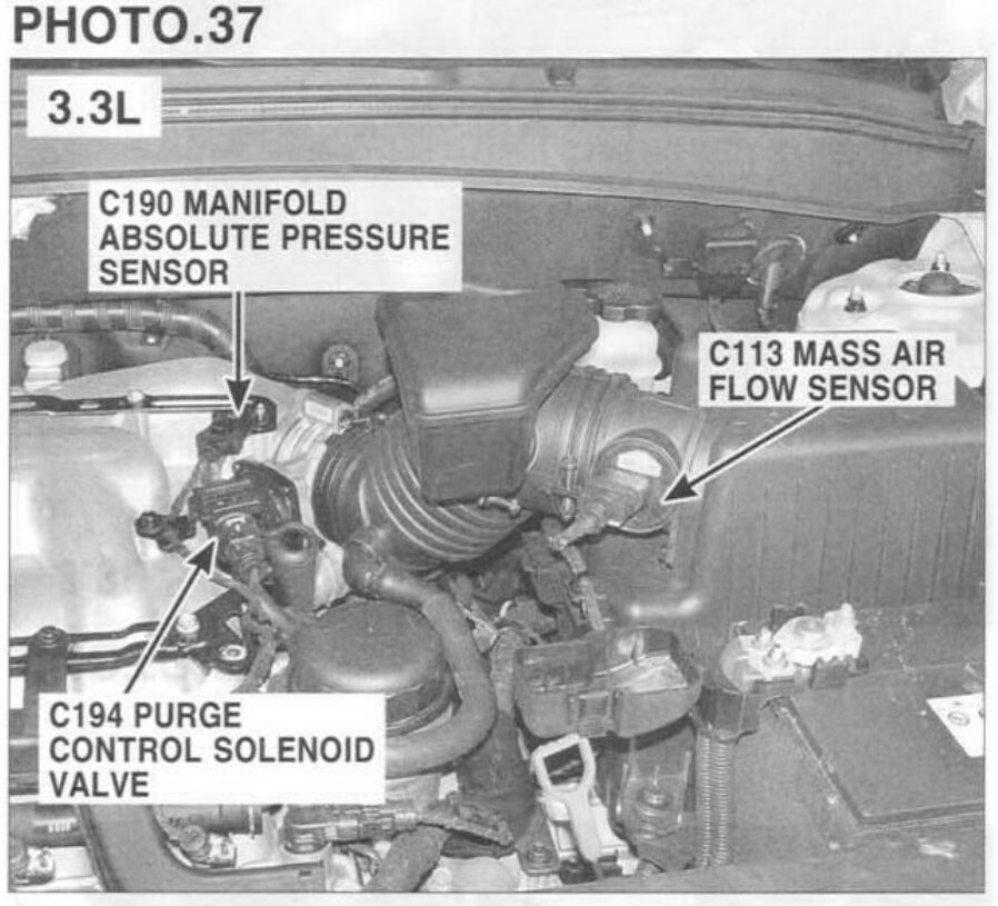

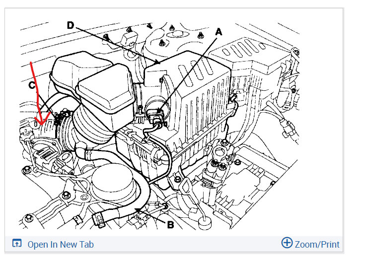

Okay, then misfires like this can be caused by a vacuum leak, dirty throttle body or a bad MAF sensor. Here is a guide to help us and the location of the MAF sensor so you can change it out. If the MAF sensor is bad it may not have a trouble code because when it is dirty it will cause the PCM to lean the fuel system out which can cause the misfire.
Also, check for obvious vacuum leaks, this guide can help:
It might be a good idea to do a compression test, how does the engine sound when cranking? If you upload a short video of the engine cranking, I can tell if you have a problem or not.
