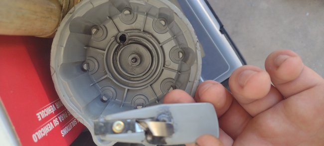

I had a slight miss before I did a tune-up, so I changed plugs wires and distributor cap and rotor. I then started the truck only for it to have a misfire even worse, so I pulled the cap back off and found the rotor to be burnt and the top metal piece was bent up. So, I then changed it out again and triple checked the wire order. Everything is right but still not running right and has a bad misfire. No play on the distributor shaft either.

By any chance, do you have pics of what happened to the original cap and rotor? Are you sure there is no up and down play in the distributor as well as side to side?
Let's do it this way. Let's see if there are codes stored in the computer that will identify a specific cylinder or cylinders that are causing the misfire. If it does and there is no damage to the new cap and rotor, I suggest removing the new plugs and inspecting them to see if the gap is correct or if there is any evidence of damage.

I do have a picture of the cap and rotor and I don't have a check engine light or anything showing a code. I will pull the new plugs out and check those as well. thank you

I certainly see the damage. Is it possible that the rotor wasn't fully seated? It fits one way only and it's not hard to not realize it wasn't fully seated.
Let me know about the plugs. Also, if possible, record it cranking and running and upload it for me to hear. It may help me.

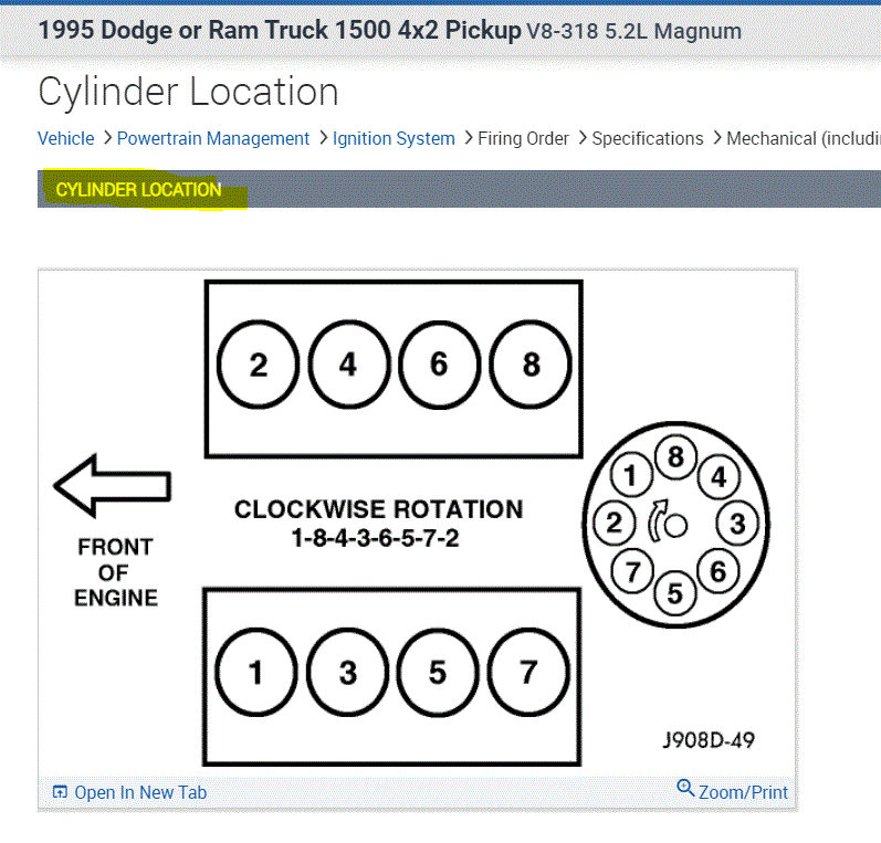

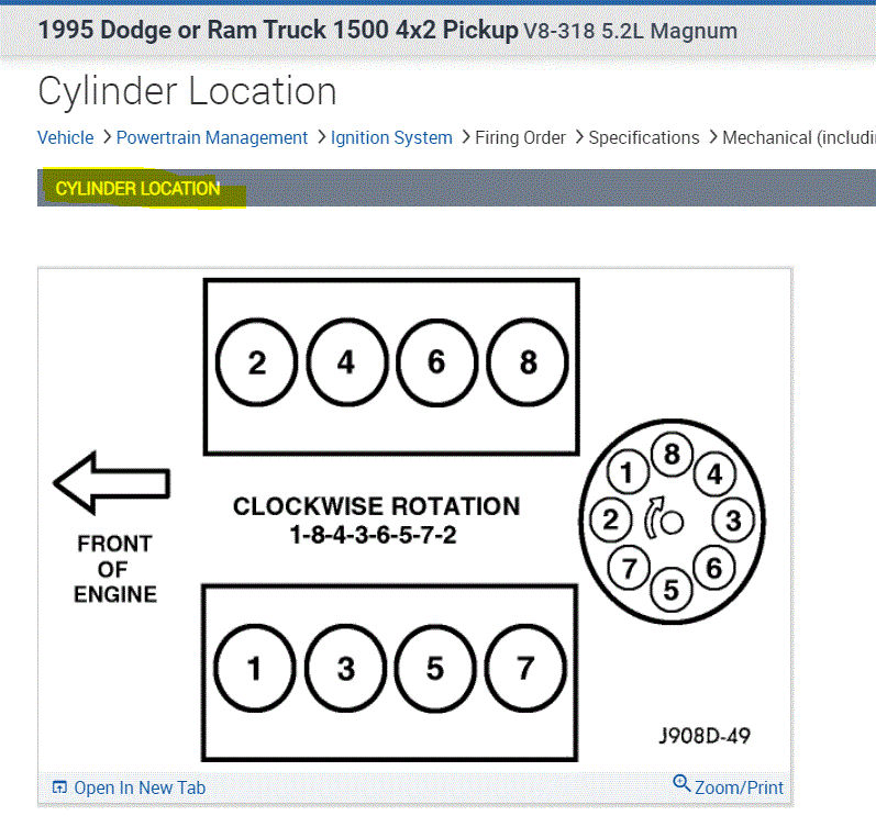

I attached the cylinder orientation and the distributor orientation for the firing order, and it also shows the rotation of the rotor. I'm adding this just in case you have something different.
See pic below.
