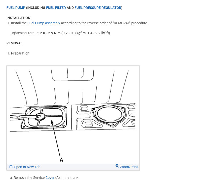

The vehicle had a check engine light come on and the car was sputtering. I used a code reader, and it said my third cylinder is misfiring. So, I changed the ignition coil and spark plug, but it is still doing it. I also have had a problem with probably a clogged fuel system. Every time I get gas it comes right back up after putting a couple of dollars in. So, I’m thinking it may be a fuel injector issue. I’m wondering what it might be or what I should do next without wasting a ton of time and money.

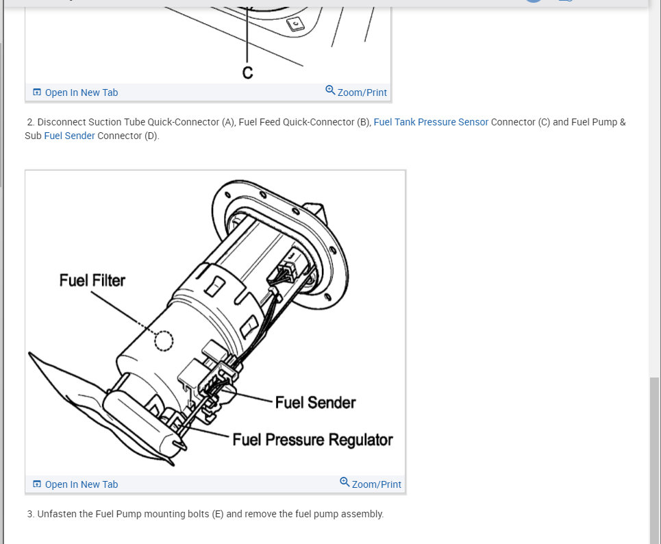

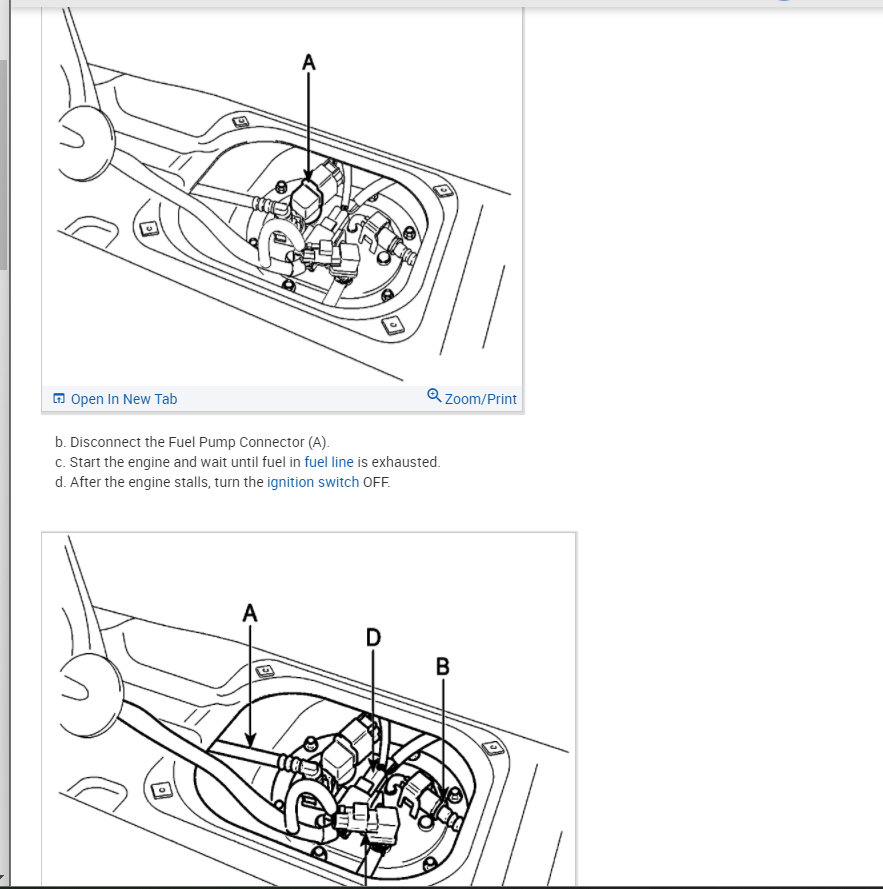

Let's start with fuel pressure and see what you have at the rail. If the fuel filling issue and misfire are related and you have low fuel pressure, then we need to suspect the filter is clogged.

I am attaching the info on the filter which is part of the pump in the tank. The nice thing is you have an access panel, and you don't have to drop the tank.
This can also help to inspect what is in the bottom of the tank but let's start with the pressure and go from there.
