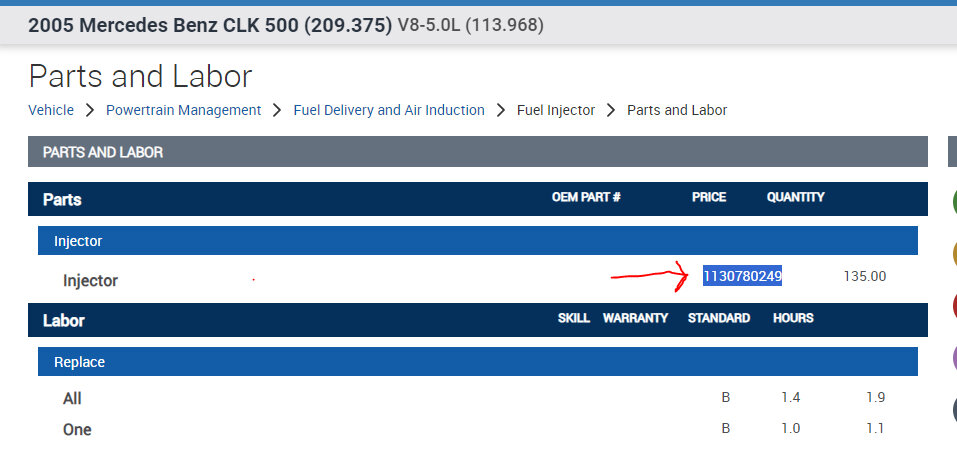

engine light came on. received a misfire #7 message. replaced spark plugs, cables and engine coils. same message. replaced fuel injectors and now there is a loud tapping noise.

Is it possible for you to record the noise and upload it for me to hear? Also, although there is a noise, does the misfire still exist? Was the P0307 misfire code the only one you found?
Does the noise seem to come from cylinder 7?

The PO307 has not reappeared. The car initially never made any knocking noise. Hard to tell exactly where the knocking is coming from. Which cylinder.

If the code hasn't returned, then it appears the misfire has been resolved. Now for the noise. Is the knocking loudest at the top, side, or bottom of the engine? Is there a way you could record it and upload it for me to hear?
The idea this started with the injector replacement makes me question if the correct injector was provided to you. Also, were all spark plugs replaced, or on the cylinder 7 spark plug?

I replaced all of the spark plugs, cables and ignition coils. I think you might be right regarding the injectors. I went with a less expensive injector (still new) but I wouldn't be surprised that by being cheap I screwed myself.

The tapping did not happen until I replaced the injectors. Question, do you think OEM Bosch parts would be as good as genuine Bosch parts?

Yep, I meant the injectors. LOL Bosch is the OEM part so I'm not sure I understand your question. Did you use an aftermarket part?
I attached the OEM part number below. Let me know if that is what was used.
See pic below.
