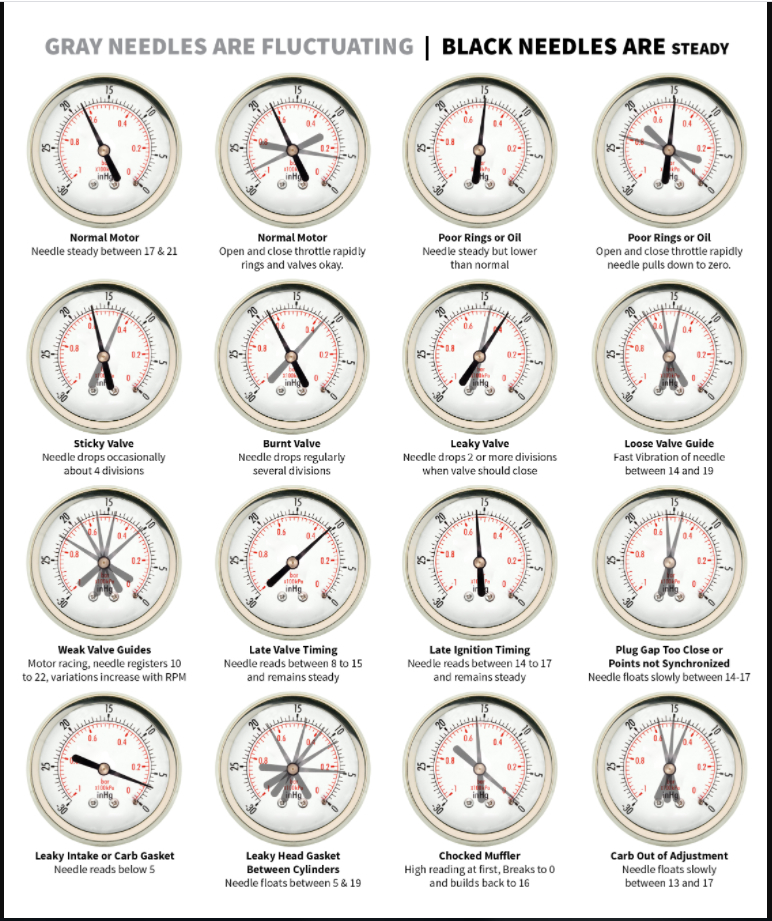

So if this was done to try and correct this we need to next do a compression test and a vacuum check with a gauge.
Below are the readings from a vacuum gauge that will help with this issue. Let's start with this and if this all checks out then we can move on to a possible fuel issue.
If you can get a video or what the vacuum gauge is doing while idling and then running rough that will help us figure out what is wrong.
