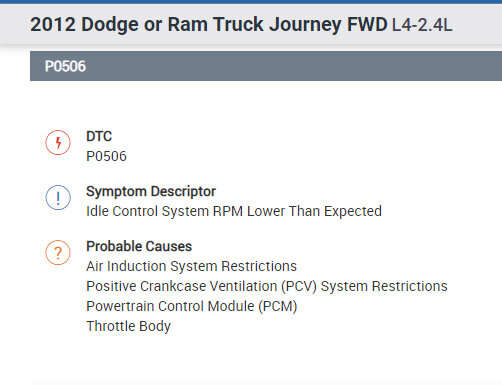

As far as the codes are concerned, I think they will help. If you look below, I attached an example. Note that it indicates possible issues to check.
Let me know what you find.
See pic below.

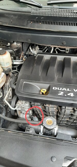

He also told me to check and clean the sensor in the picture.

This engine has a timing chain, so it should last the life of the engine unless we have a tensioner issue or other failure. It shouldn't need to be replaced at this mileage.
Now, the idea there were valve timing codes is interesting. The engine has variable valve timing. The Variable Valve Timing (VVT) assemblies are actuated with engine oil pressure. The oil flow to the VVT assemblies is controlled by two Oil Control Valves (OCV). There is an OCV and Camshaft Position Sensor (CMP) for each camshaft.
If there is an issue with a sensor, actuator, or the oil is extremely dirty or hasn't been changed on a regular basis, it can be the issue.
I need to know the codes he found. And certainly, hold off on the timing chain unless there is excessive noise from it, or you know of a problem.

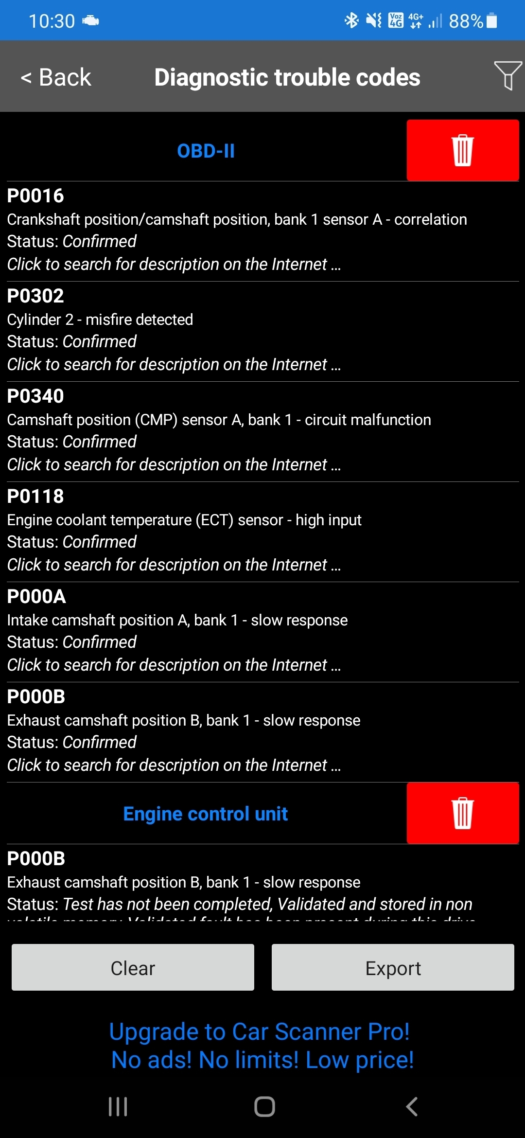

Checked oil level this morning and it's where it should be. And a friend let me borrow an OBD-2 scanner and got the following.
May 12, 2023 at 2:10 AM
  • 110,248 POSTS
I wouldn't have pulled over either. LOL I looked at the codes. There are a lot of them. However, the first one I need you to check is the P0118, coolant temp sensor. If that is off, it can cause havoc. The idea that you have the cam/crank sensor codes is a bit difficult for me to accept with the mileage on the vehicle. However, it is possible.
So, if the scan tool you have has live data, connect it. Check to see what the coolant temperature signal indicates. It should be close to the ambient temperature outside before starting it.
