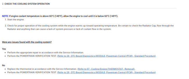

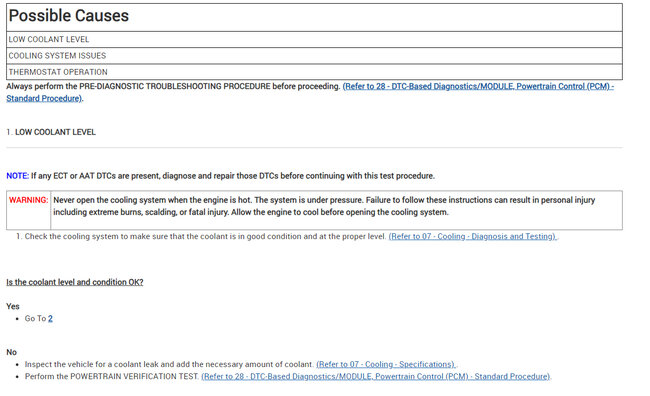

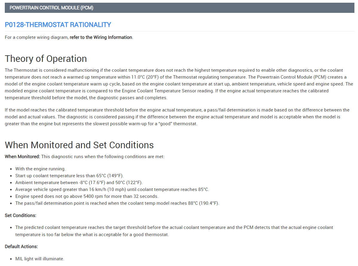

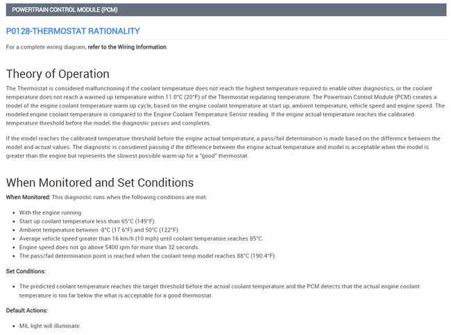

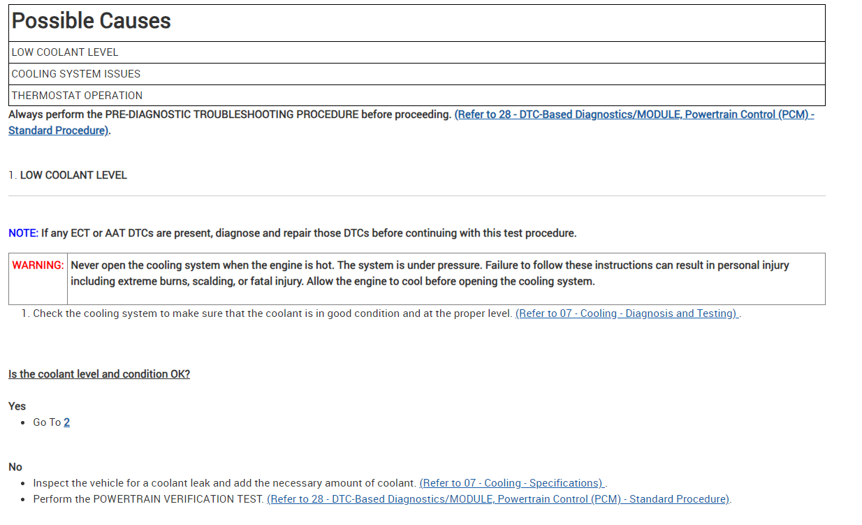

Here are some pretty interesting service info on how the engine computer (PCM) keeps track of the thermostat operation. If this is the code that set, and it came back after they replaced the thermostat, they might be confused on its operation. In this case even an Ambient Temperature sensor that's out of range could cause the code to come back because certain conditions are not met.

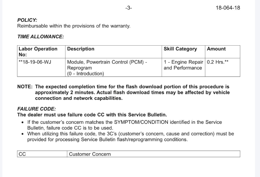

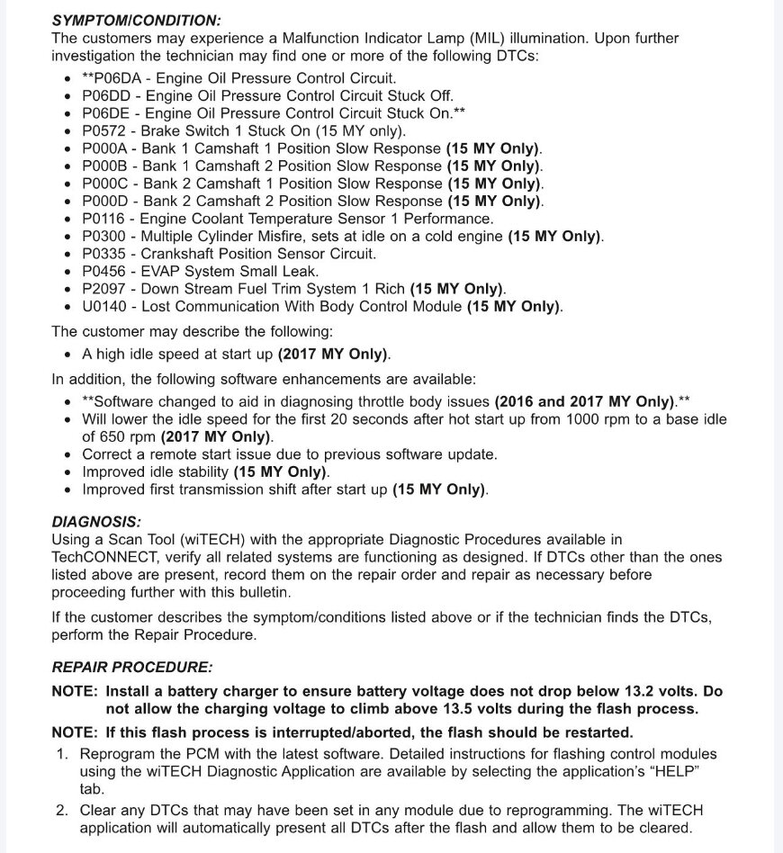

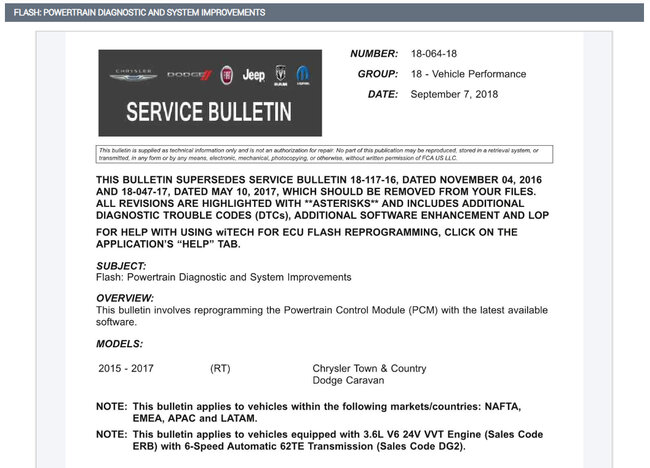

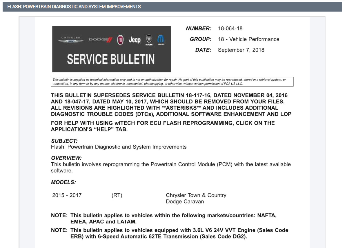

There is also a Technical Service Bulletin on a software update for the PCM due to some certain codes setting, as well as some idle issues and also aid in diagnosing throttle body issues. PCM software updates are pretty normal, every vehicle will have software updates that are programmed if a module is replaced, or if you happen to have the vehicle at a dealership. If you're within your warranty still, I would consider getting the PCM updated. There might be codes setting that are not actual faults. (diagrams 4-6 below)

Yeah, that's strange they should have listed all the code numbers, that way we can look up the code setting criteria to determine exactly why it ser. A thermostat code on this vehicle is related to the engine computer monitoring the engine coolant temperature sensor, and a specific amount of time have gone by. Next time you have any issues at all, have AutoZone or whatever auto parts store you use scan the vehicle for codes and come here and post them so we can give a list of possibilities ahead of time. So, you know what to expect and not just have to take a shop's word. Because they can say anything and then charge people anything as well and labor rates are extremely high these days. I question the injector issue, especially with this vehicle, the injectors might be under the intake manifold depending on the design and that will just add to the cost if it needs to be removed to get to the injectors.
