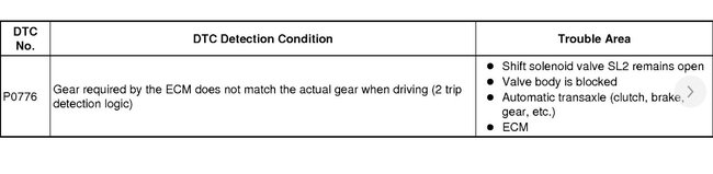

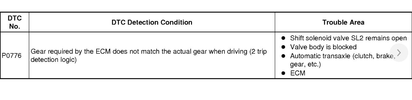

Code p0776.
Jul 22, 2019 at 10:46 AM
Good evening,
The code has several possibilities. I attached a list below for you to view and if you want to do a diagnostic, you will need an advanced scan tool that can read live data from the transmission.
P0776
Descriptor
Automatic Transaxle System
Probable Causes
Automatic Transaxle Internal Malfunction
Engine Control Module (ECM)
Shift Solenoid Valve SL2
Shift Solenoid Valve SL2 Remains Open
Shift Solenoid Valve SL2 Remains Open or Closed
Valve Body is Blocked
Diagnostic
U140F AUTOMATIC TRANSAXLE: AUTOMATIC TRANSAXLE SYSTEM: P0776: Pressure Control Solenoid "B" Performance (Shift Solenoid Valve SL2)
P0776 - Pressure Control Solenoid "B" Performance (Shift Solenoid Valve SL2)
DESCRIPTION
The ECM uses signals from the output shaft speed sensor and input speed sensor to detect the actual gear position (1st, 2nd, 3rd or 4th gear).
Then the ECM compares the actual gear with the shift schedule in the ECM memory to detect mechanical problems of the shift solenoid valves, valve body or automatic transaxle (clutch, brake, gear, etc.).
MONITOR DESCRIPTION
This DTC indicates a stuck ON malfunction or stuck OFF malfunction of the shift solenoid valve SL2.
The ECM commands gear shifts by turning the shift solenoid valves ON/OFF. When the gear position commanded by the ECM and the actual gear position are not the same, the ECM illuminates the MIL and stores the DTC.

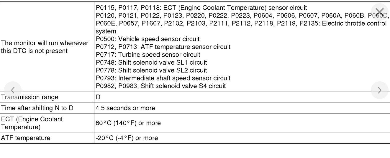

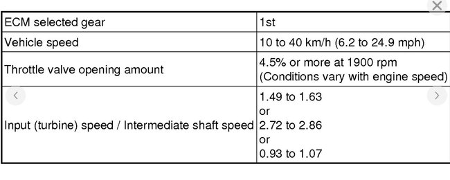

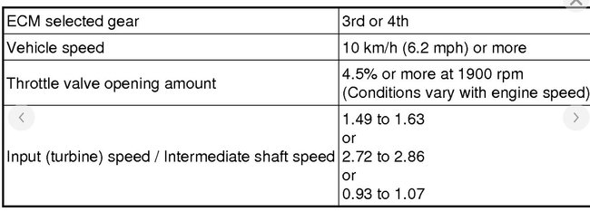

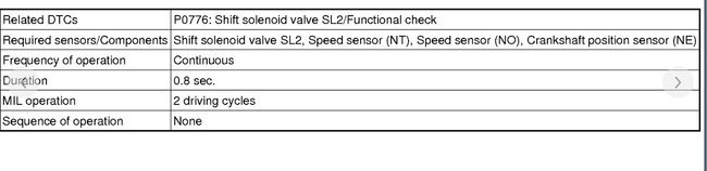

MONITOR STRATEGY
TYPICAL ENABLING CONDITIONS
All
OFF malfunction
ON malfunction

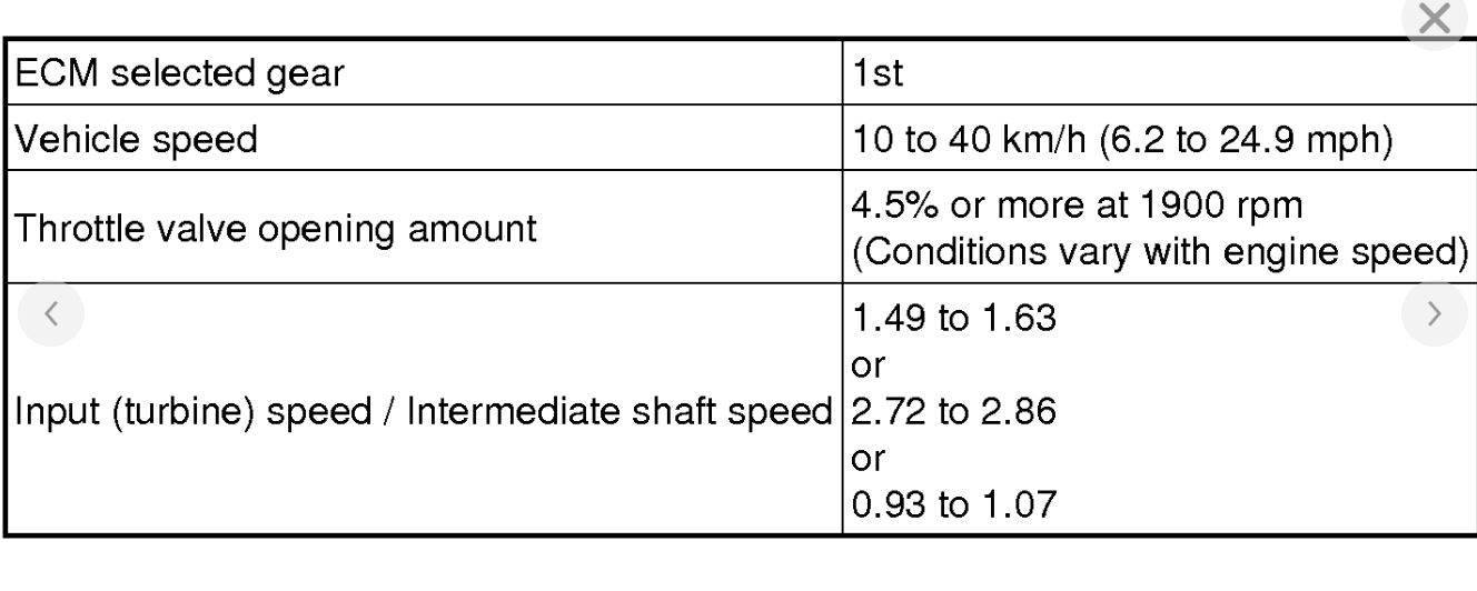

TYPICAL MALFUNCTION THRESHOLDS
Either condition is met: OFF malfunction or ON malfunction
2 detections are necessary per driving cycle:
1st detection: temporary flag ON
2nd detection: pending fault code ON
OFF malfunction
ON malfunction

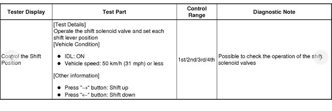

HINT
Performing Techstream's Active Test allows relay, VSV, actuator and other items to be operated without removing any parts. Performing the Active Test early in troubleshooting is one way to save time.
The Data List can be displayed during the Active Test.
1. Warm up the engine.
2. Turn the ignition switch off.
3. Connect Techstream to the DLC3.
4. Turn the ignition switch to ON and turn the Techstream on.
5. Enter the following menus: Powertrain / Engine and ECT / Active Test.
6. Follow the instructions on the Techstream and perform the Active Test.
HINT
While driving, the shift position can be forcibly changed with the Techstream.
Comparing the shift position commanded by the Active Test with the actual shift position enables you to confirm the problem See: Automatic Transmission/Transaxle > Initial Inspection and Diagnostic Overview > Fail-Safe Chart.
HINT
* This test can be conducted when the vehicle speed is 50 km/h (31 mph) or less.
* The shift position commanded by the ECM is shown in the Data List/Shift Status display on the Techstream.

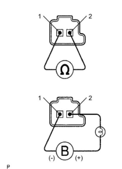

2. INSPECT SHIFT SOLENOID VALVE SL2
(a)Remove the shift solenoid valve SL2.
(b)Measure the resistance of the solenoid valve.
Standard resistance:
5.0 to 5.6 Ohms at 20°C (68°F)
(c)Connect the battery's positive (+) lead with a 21 W bulb to terminal 2 and the negative (-) lead to terminal 1 of the solenoid valve connector. Then check that the valve moves and makes an operating noise.
OK:
Valve moves and makes operating noise.
NG -- REPLACE SHIFT SOLENOID VALVE SL2
OK -- Continue to next step.
