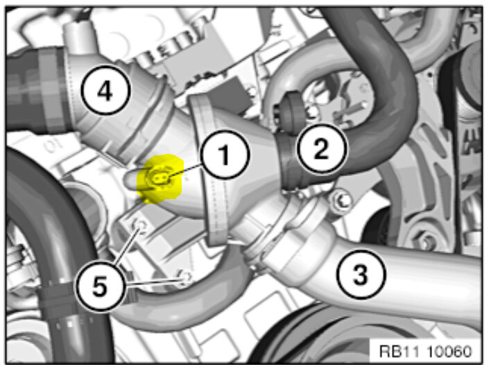

  • 110,194 POSTS
It is a way to better enhance the engine temp control. Basically, the thermostat has the addition of a heating element and is controlled via the PCM.
See pic below.
Let me know if this helps.

Hey, my friend, thank you very much. I appreciate that I'm going to have to thermostat tomorrow.

Hey, my friend, I had the thermostat and water pump changed today. The car runs great like a brand-new car with no engine light on of course. I'm going to have to drive it to make sure they don't come back on. I was trying to go see if I could figure it out on my own. I need a vehicle for this Saturday. So, I had to put in the shop spend the money. But it seems to be correct.

Thanks for the update. I feel the thermostat was the issue. If it appears to be working properly now, you should be fine.
However, if anything changes, let me know and we'll get it fixed.
