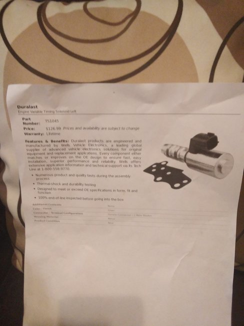

So we took it to AutoZone and they put it in the machine and the code was bank1 he said we have 4 sensors so he changed the one on the right side and cleared the screen the engine light went off. now today it came back on. so I'm really not understand did he change the right one.

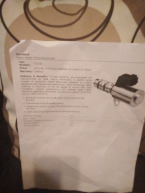

WASHINGTONELLA
  • 8 POSTS
This is what the code Bank1 and put in the computer and printed out these sensor we already changed one side the mechanic told us to purchase the right side. but standing in front of the car he replaced the one on the passenger side that would be the left side, but from behind the wheel if you where driving would be the right side. I'm really confused.
Aug 7, 2020 at 4:20 PM
  • 110,244 POSTS
I don't mean to confuse you. The pics you attached are for the variable valve timing sensors. There are four on this car. For me to know which one was turning on the light, I need the diagnostic trouble code. It will be a number like P0011 or P0014.
The idea is this. If I know the code, I can tell if the correct sensor was replaced. If it was, then we have to check other things. One of the things that can set these codes is when the timing chain stretches. With the number of miles on the vehicle, that is possible. There are other things as well that can cause them.
Is there anything that they gave you that indicates the code that was found?
Let me know. Please let me know if you have questions. Honestly, I want to help not confuse you.
