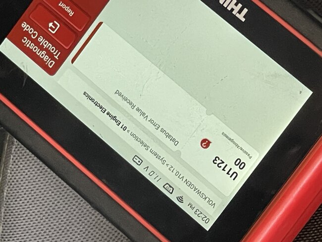

it’s not certainly knocking, i don’t know how to explain it, the RPM just goes down and up and the engine makes that noise as if it’s shaking, last time it was at the mechanic this code showed up after the car was done but I don’t know what it means.

The code is a generic code. The OBD2 standard identifies it as a Databus error value received. This error can appear from any of the several control modules, and it can be an initiating fault. In other words, something other may have inadvertently set this code.
If the engine isn't truly knocking, we need to try having the entire CAN bus scanned. CAN stands for controller area network.
Basically, all the different modules are tied together via a few wires. This type of scan (attached above) will retrieve codes regardless of the module storing them.
Let me know your thoughts.

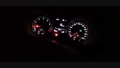

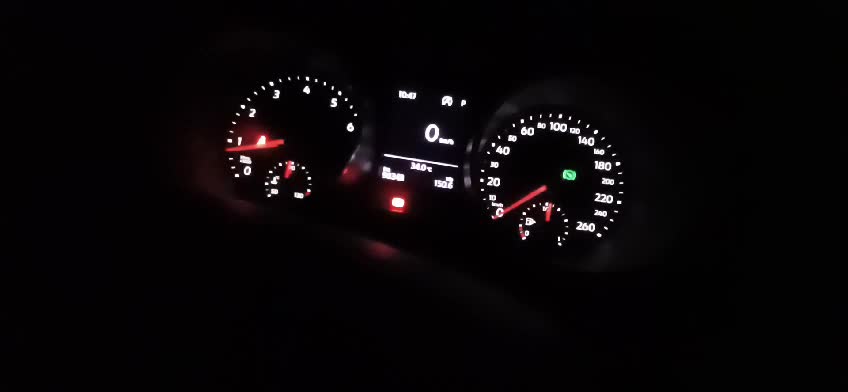

Unfortunately it wasn’t the MAF sensor, we replaced it with another and at first it was well, then after 5 hours of the car being parked and cooled down, I turned the engine ON and the same thing happened, here is a video on what’s happening to it, look closely at the RPM, I’m not pressing on anything, and if I switch the gear from P to D the car turns off.

That isn't good. I watched the video and saw the tachometer. It reminds me of an idle air control issue, but that should have set a code.
Have you checked to make sure the fuel pressure is consistent?
