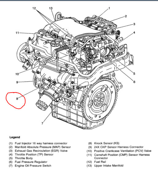

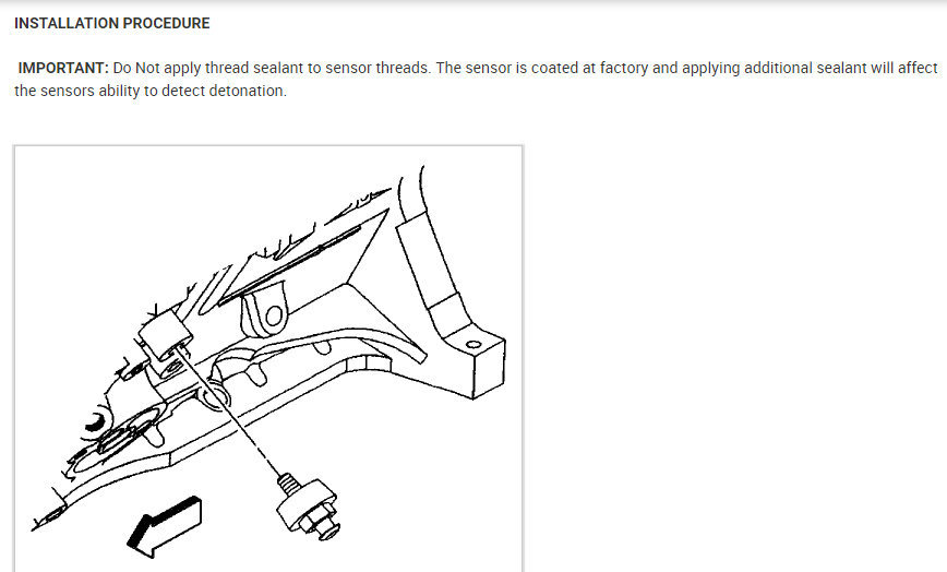

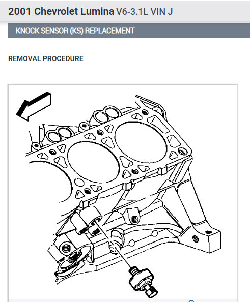

I'm not sure if you entered the wrong year but 2001 was the last year a Chevrolet Lumina was made. Here is a tutorial for you to view in regards to how a knock sensor works:
https://www.2carpros.com/articles/how-a-knock-sensor-works
I've attached picture steps below for knock sensor replacement including its location for your car. Hope this helps and thanks for using 2CarPros.

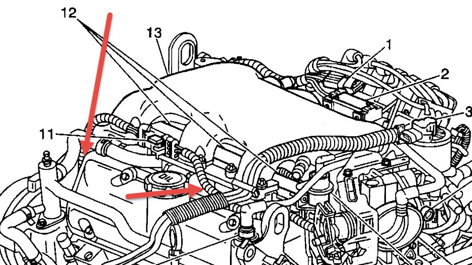

there is no code p0332 but ther is a code 336 which it hink you have which is cam sensor. A short to ground on that sensor will cause your knock sensor code as well as any knock that is loud enough to set it off. the cam sensor can also cause the 336 code so my advice would be to replace the cam sensor and see if the other codes are ok. also check the wiring leading to the where the new sensor hooks up. for maf sensor it needs to be check ed for poor connections and or a short to ground between sensor and pcm. A pro really needs to check this against the map sensor during a freeze frame cycle to read voltages. also check for a vacuum leak around map sensor. btw a Lumina is a Lumina not a Malibu two different body styles. see pic for cam sensor and harness.

The KS is on the lower right rear of engine below the exhaust manifold.
