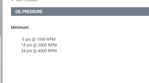

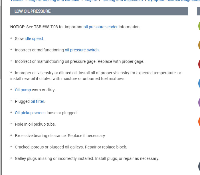

Also, if you just replaced the oil pump then we need to check the oil pressure and make sure you have a functioning pump.
https://www.2carpros.com/articles/high-or-low-engine-oil-pressure
If the pump is faulty then no oil pressure will cause the engine to knock so we should start with this.
If the oil pressure gauge in the dash (if equipped) says it is fine, then we should check it with a gauge just to confirm because if this happened right after replacing the pump then that is most likely the cause.
Please see the info attached on this and then let us know if you can get a video of the noise just to be sure we are talking about the same type of knock.
