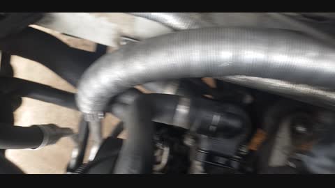

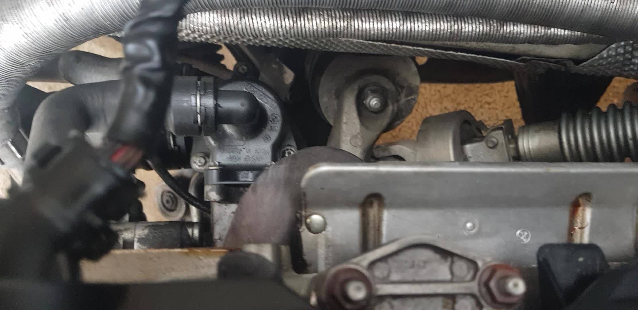

Vehicle started having an engine knock after timing without a timing tool. Could this be the cause? Is there any remedy?

If it was running okay, you would have had the timing close enough and it wouldn't have caused damage. Is the noise loud enough for you to record and upload for me to hear? Also, is the engine oil clean and full?

The engine was running fine. It just did not have power. The oil is full and clean, just changed two weeks ago.

It sounds like a low-end knock (crankshaft related). When you rev the engine, does it increase in speed? If you place it in gear, does it get more pronounced?
Is the mileage you indicated above accurate for this engine?

Yes, the knock does increase. It doesn't get pronounced when the car is in gear. The engine mileage is 433691 km.

No problem with the time zones. Chances are, you have a main bearing on the crankshaft which is worn beyond tolerance causing the sound. There are also thrust bearings in conjunction with the main bearings that can allow excessive play in the crankshaft. With the engine off, grab the crankshaft pulley and see if there is in and out play.
This type of problem is more common when you have a manual transmission due to added pressure on the flywheel.
As far as a repair, yes it can be done. However, because of the mileage, I feel you will likely have more time and money into rebuilding the engine than finding a good used one. Once the engine is apart, you will find a lot of other things needing attention just from normal wear (based on mileage).
