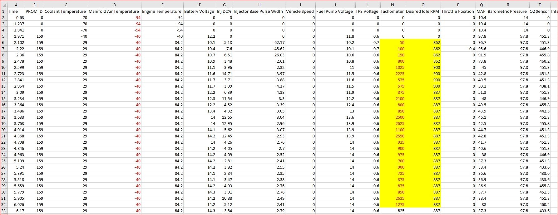

This is a 1995 Chevrolet Tahoe 5.7 TBI. No Vortec. No IAT sensor, No MAF sensor. I have put a scan tool on it, no trouble codes no check engine light. I did live stream data from it.

That Steven. This is great information. If this issue started after you put this crate engine in, you may be missing this intake temp sensor. The PCM is looking for it and is recording it as -40. This is indicative of an open in the wiring or sensor. If it is not there, then this would explain the open. Either way, the PCM is looking for it and not seeing it. This will effect the way the engine performs in open loop when it is warm outside. When it is cold, the engine will run a little better because the -40 is not as far off so it may not be as noticeable. I see that the GM TBI crate engines are direct replacements for this vehicle but don't see where it says the IAT is not needed.
The next thing is the MAP seems off. I assume the MAP in your recording is measuring in vacuum not pressure because at key on, the MAP matches your BARO. Then quickly your MAP shows load on the engine or possibly throttle input, even though your throttle remains at idle. The PCM is command an RPM of 890 but clearly the RPM is ranging and this indicates a rogue sensor that the PCM is looking at.
If it were me, I would investigate the intake/manifold air temp sensor and then replace the MAP and retest. This is assuming that when the crate engine was installed, the PCM was re-calibrated for the engine change. What engine was in this prior? Was it a Vortec engine?
