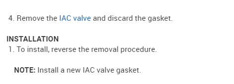

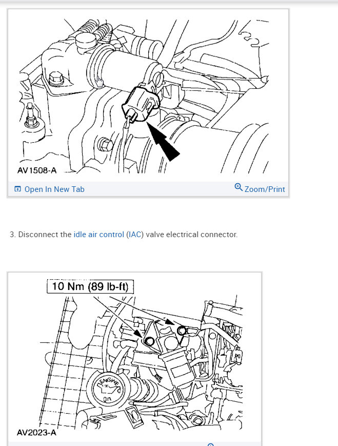

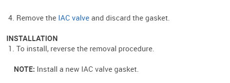

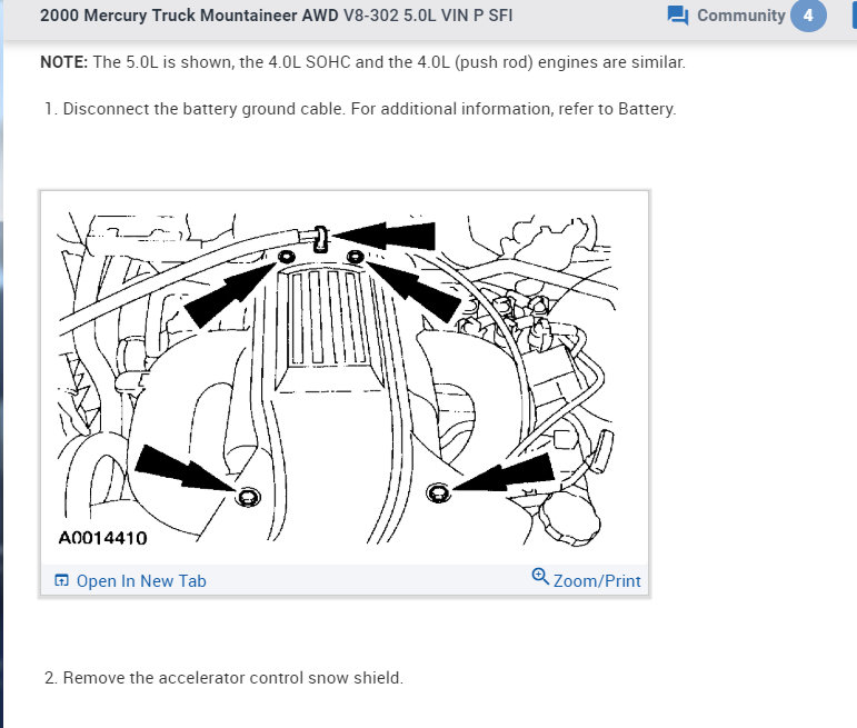

Unfortunately, I am not going to be able to tell for sure what this is without hearing it, but I can tell you how to find it if it is my best guess. When this is acting up are you able to get out and listen to specific areas? So will it continue to make the noise if you are stopped in drive and foot left on the brake? If so, have someone else drive and get it to make the noise and then pop the hood and inspect the IAC. This is the idle air control valve. This is the most common thing that makes noise on Ford/Lincoln/Mercury engines. In fact, refer to this guide step 6 and it mentions this.
https://www.2carpros.com/articles/engine-noises
Please let me know what you find and I will be happy to brain storm some other ideas. Thanks
